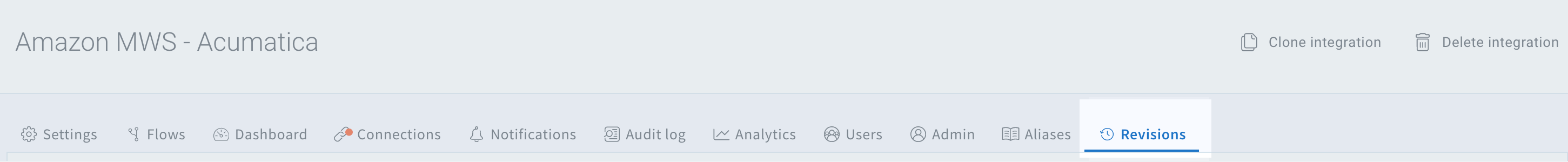

Revision tracking in ILM

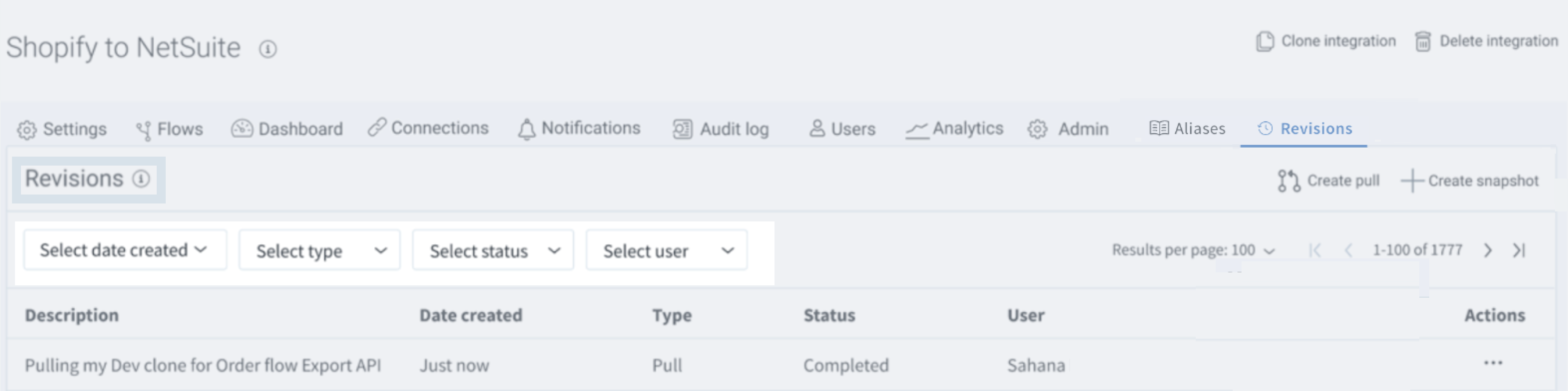

ILM tracks changes through revisions. integrator.io creates a revision every time you perform a snapshot, pull, or revert on an integration. You can view, filter, and act on every revision from Revisions on the integration page.

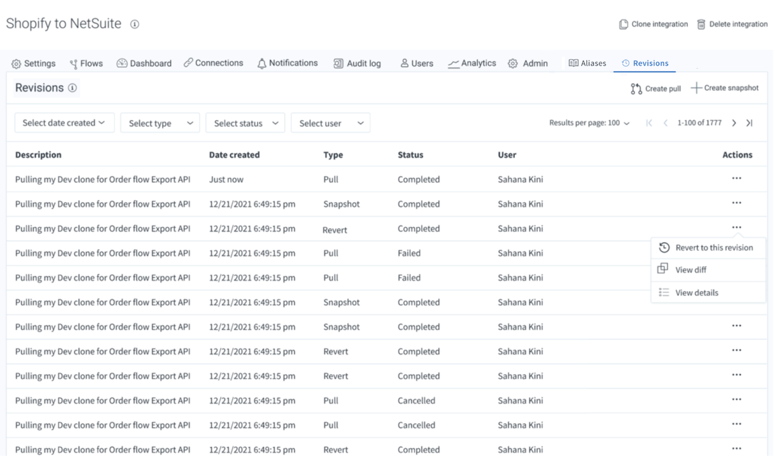

Revision types
integrator.io creates three types of revisions:
| Revision type | When it's created | What you can do with it |
| Snapshot | When you select Create snapshot | Revert to this revision; View details |
| Pull | When you pull changes from a remote integration into the current integration | Revert to after this revision or Revert to before this revision; View resources changed; View details |
| Revert | When you roll back an integration to a previous revision | Revert to after this revision or Revert to before this revision; View resources changed; View details |
Only one revision operation can run at a time. If a pull or revert is in progress, you can't start another until it completes or is canceled.
