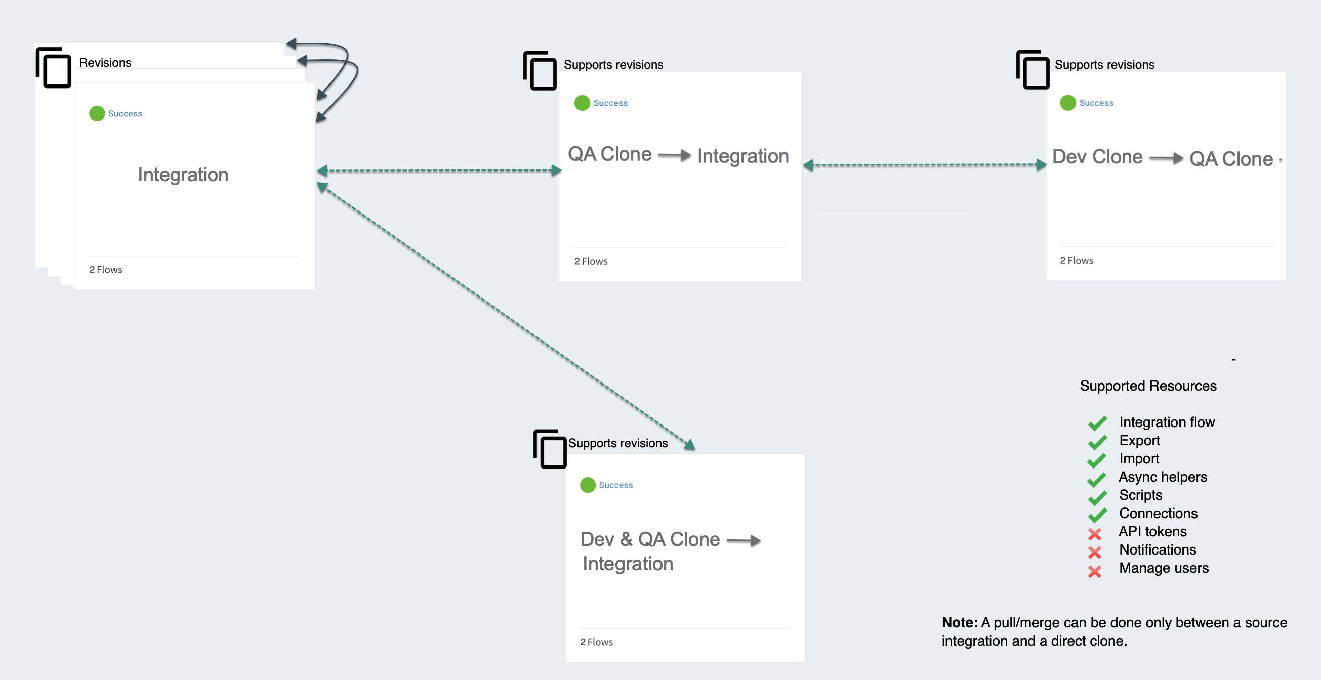

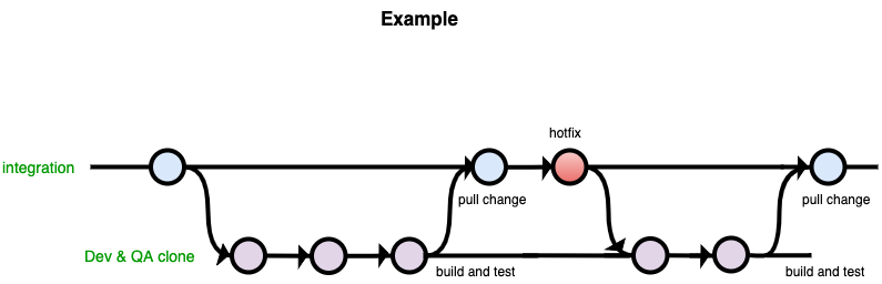

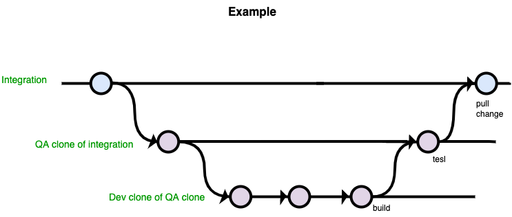

Example integration and clone setups
These diagrams show example ways to set up integrations and clones for ILM. For step-by-step setups, see Developing with integration lifecycle management.
