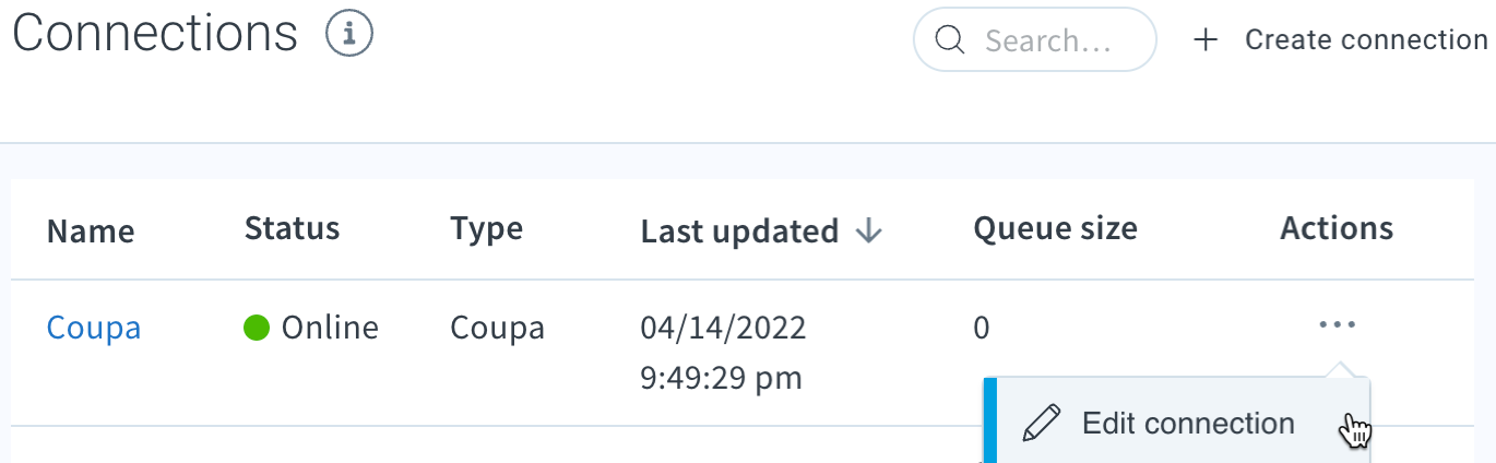

Navigate to Resources > Connections.
Search for an existing Coupa connection, from the Actions overflow ... menu, select Edit connection.

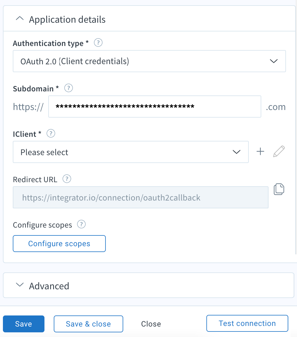

In the Application details, from the Authentication type drop-down list, select OAuth 2.0 (Client credentials).
By default, the Authentication type is set to Token (Deprecated) as the existing connections are configured with API keys.
The Subdomain field populates your existing Coupa subdomain. You can also change it if required. For example, if your portal is found at https:// greatsales.coupacloud .com , then enter greatsales.coupacloud for the subdomain.
To create IClient, click the plus ( + ) button. The Create IClient tab appears.
Provide a Name, Client ID, and Client secret that are received after creating the Coupa OAuth 2.0 client.
Click Save.

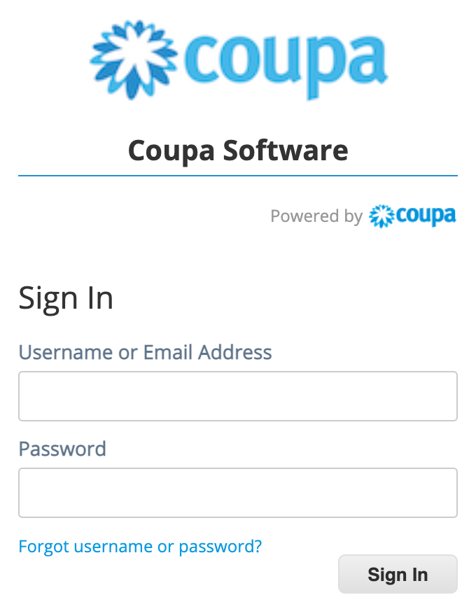

Sign in to your Coupa account.

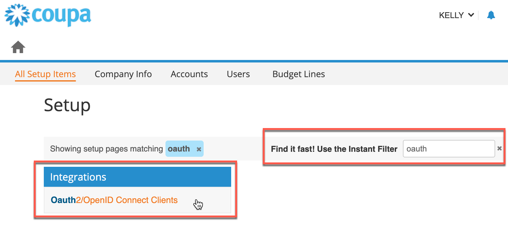

Navigate to Setup > Integrations > Oauth2/OpenID Connect Clients.

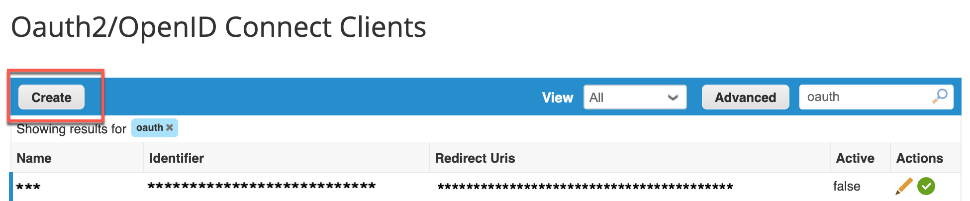

Click Create. The Create client page appears.
From the Grant type drop-down list, select Client credentials.
Provide a Name, Login, and Contactinfo.
In the Scopes section, select the required scopes and click Save .
Copy the Client ID and Client secret. For more information on how to create an OAuth 2.0 client in Coupa, see OAuth 2.0 Getting Started with Coupa API.
Click Configure Scopes and add or remove the scopes according to your requirement.
You must add the scope core.user.read for a successful connection.
Click Test connection to verify the connection and click Save and close.
