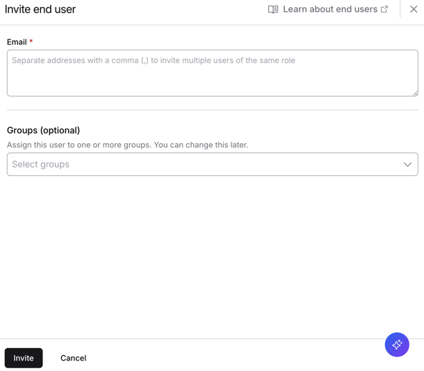

Invite end users
You can invite one or more end users at once, the invite form takes a batch of emails.
  1. Go to Account (the avatar at the top right of the page), and then select Users.
  2. Go to End users → Users.
  3. In the End users view, click + Invite end users.
If you already invited a few users and wish to invite more, then click + Invite end users at the upper right side of the page.
  1. Enter the required fields:
    • Emails: Enter one or more email addresses, comma-separated. Each email is evaluated independently: if its domain matches a configured IdP, that person is activated immediately through SSO with no setup email; if it doesn't match any IdP, they get a setup email to create a Celigo password. If an address already belongs to a verified Celigo identity, it's activated silently instead, no email is sent.
    • Groups (optional): Select one or more groups to add these end users to. This grants MCP access as soon as each end user's account is active, without a second step. You can also manage group membership later from End users → Groups.
  2. Click Invite.

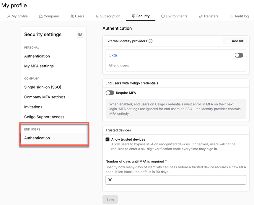

End user Authentication
To configure authentication settings, select Authentication settings. This opens Account → Security → End users → Authentication, where you can manage Celigo credentials, multi-factor authentication (MFA), and External identity providers.
