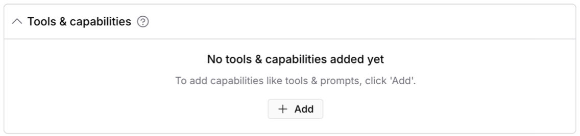

  3. Go to the Tools & capabilities section and click + Add.
