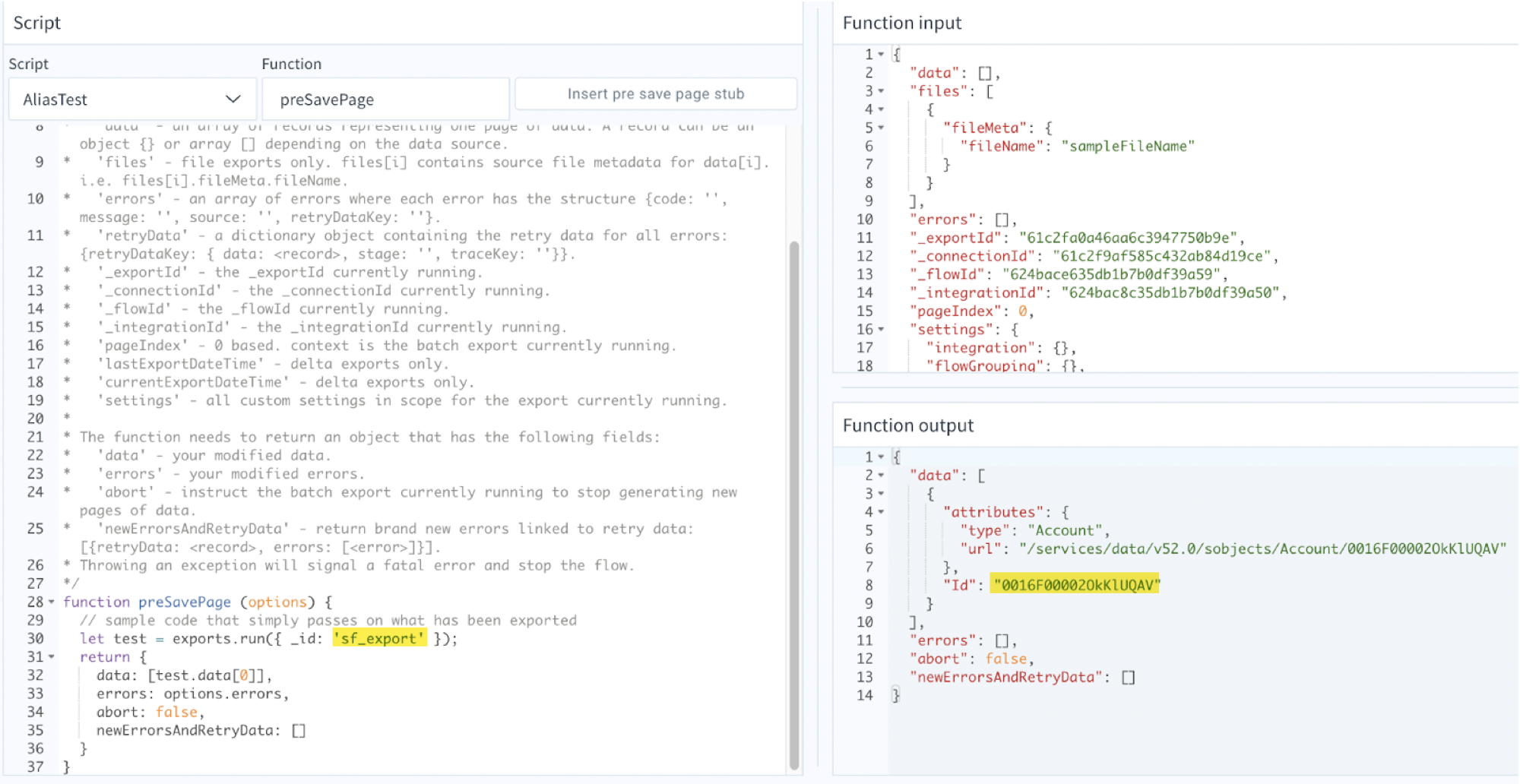

Reference an alias in a hook
- Create or edit the script used for a hook.
- In the Script editor, click View aliases on the top right.
- Locate the alias for the appropriate resource.
- To see more information about an alias, click … in the Actions column and then click View details.
- Click … in the Actions column and then click Copy alias.
- Paste the alias into the appropriate location in your script.
- If Auto preview is enabled or you click Preview, the alias should be resolved and the output of the invoked function should appear.
