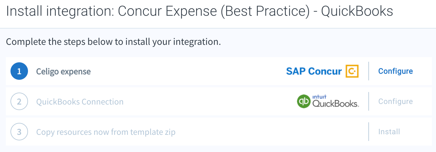

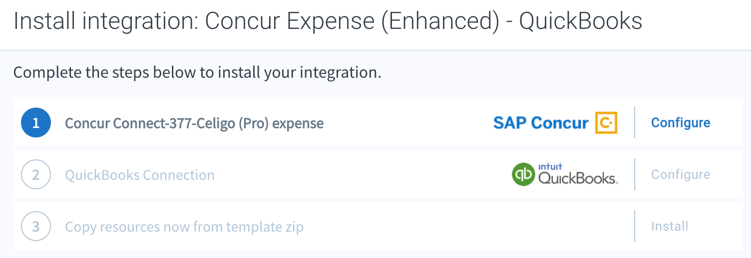

Set up the connections and integrate with Concur Expense (Best Practice & Enhanced) – QuickBooks
To install the integration, complete the following steps:
Concur Expense (Best Practice) – QuickBooks Concur Expense (Enhanced) – QuickBooksStep 1. Connect to Concur
Select to Configure the Enhanced or Best Practice Concur Expense connection.
After you successfully initiated this template installation, as described above in Initiate template installation from the SAP Concur App Center, a working connection to your Concur account was already created for you. In this case, choose Use existing connection and select the correct connection for the template you chose:
- Concur Expense (Best Practice): Concur Connect-EU-377-Celigo (Std) expense
- Concur Expense (Enhanced): Concur Connect-377-Celigo (Pro) expense
If you received an error while transferring from the Concur App Center and the connection is not available, instead create the connection manually during the installation, as follows:
- Select Set up new connection.
- Provide the Username and Password passed from Concur to integrator.io (see Question 2 in the template troubleshooting FAQs).
- Select Generate token.
- Test and save the connection.
