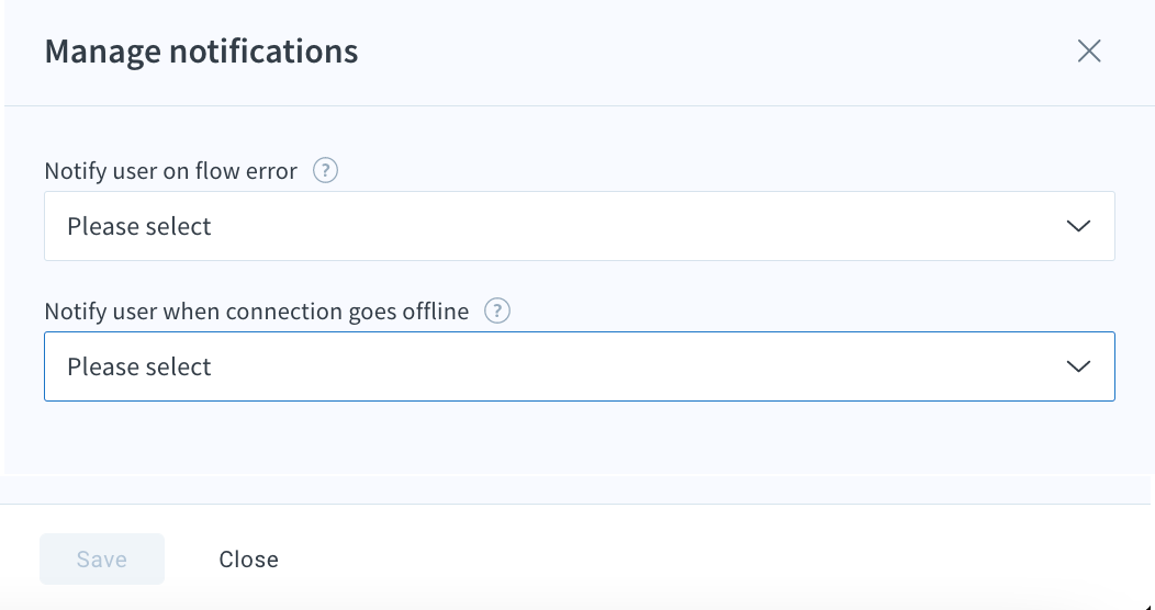

  3. Click the Add notifications or Edit notifications icon on the line for the appropriate user.
    The Manage notifications page appears:
  4. Under Notify user on flow error, select All flows or specific flow(s). Then, click Done.
  5. Under Notify user when connection goes offline, select the connection(s) that should trigger notification emails. Then, click Done.
  6. Click Save.
