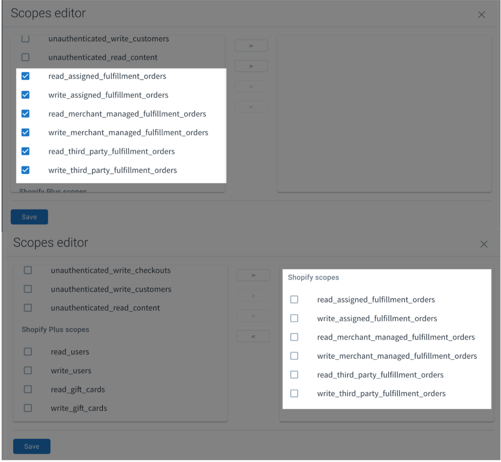

The following scopes are required to access Fulfillment Order API. Update your Shopify connections by adding these scopes.
To update your Shopify connection:
  1. From the Resources menu, navigate to Connections .
  2. Search for Shopify.
  3. Select the matching Shopify connection(s). In the Version dropdown, check if the version is 2022-04, if yes, click the Version dropdown and choose 2022-07 or the higher API version.
  4. In the Configure scopes section, click Configure scopes . The Scopes editor page is displayed.
  5. Select the list of scopes mentioned below and use the > button to add them to your configured scopes.
      • read_merchant_managed_fulfillment_orders
      • write_merchant_managed_fulfillment_orders
      • read_third_party_fulfillment_orders
      • write_third_party_fulfillment_orders
      • read_assigned_fulfillment_orders
      • Write_assigned_fulfillment_orders
    If you are using the OAuth 2.0 authentication type, make sure to include these scopes and click Save & authorize . If you are using Basic or Token-based authentication, make sure to include these scopes in the custom app that you have created, and update it.

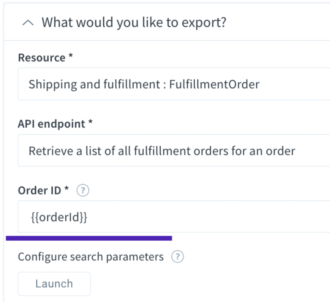

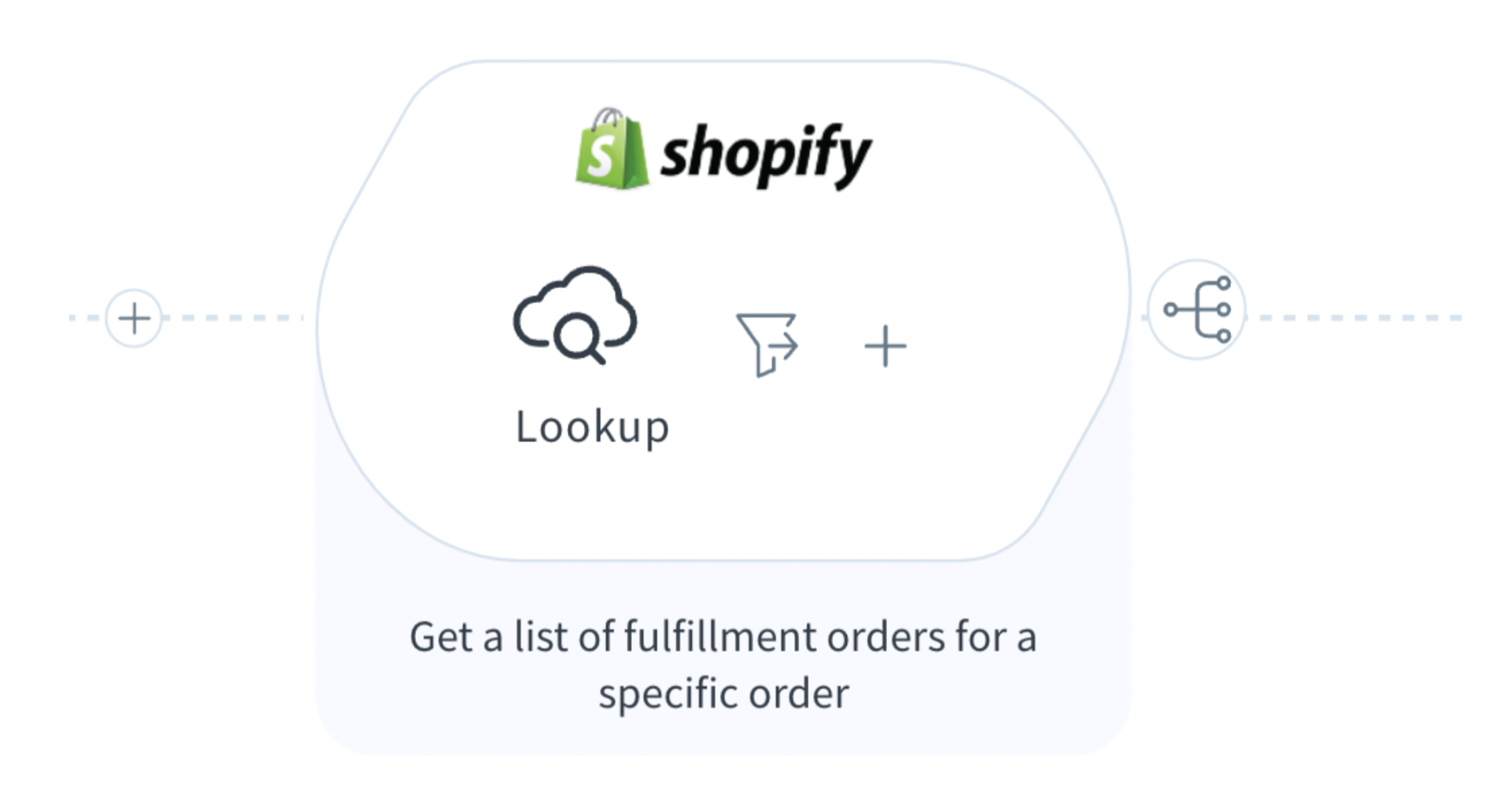

  4. Click + to add a lookup bubble Get a list of fulfillment orders for a specific order to fetch the fulfillment orders by order ID using Retrieve a list of all fulfillment orders for an order endpoint.
  5. Within the lookup, select Shipping and fulfillment : Fulfillment Order for the Resource setting, and Retrieve a list of all fulfillment orders for an order for the API endpoint .
  6. In the Order ID field, using handlebars, assign the value as shown in the screenshot.

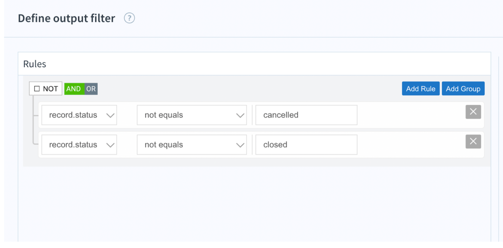

  7. Click the Output filter option and add an output filter that allows only the fulfillment order that doesn’t have the status of closed or canceled.

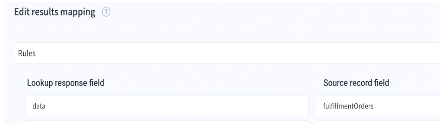

  8. Click the Mappings icon and add the results mapping to capture the array of fulfillment orders for that order.

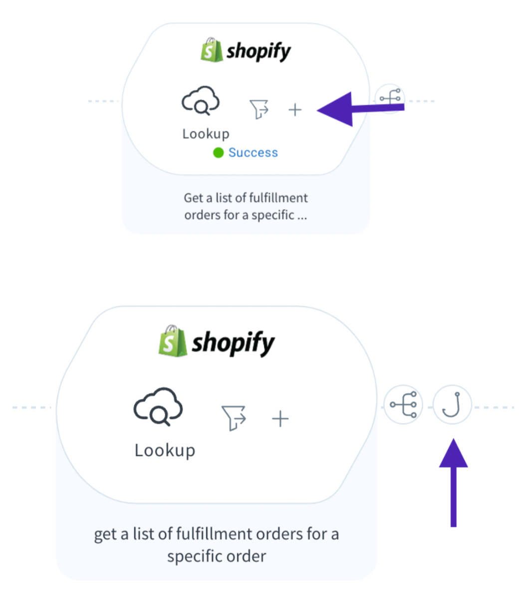

  9. If the previous fulfillment flow supports the partial fulfillment, add a PostResponseMap hook for the above lookup.

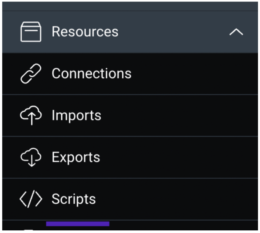

  10. Create a script under Resources → Scripts.
  11. In the Name field, provide a name to the script.
  12. In the Edit content, write a script that does the following:
    1. For each source line item iterate over fulfillmentOrders[*].line_items, and allow only the fulfillmentOrders[*].line_items where its line_item_id matches with the source etail line item id .
    2. If source quantity is <= Shopify quantity
      • Add a new field to the fulfillmentOrders[*].line_items that holds the quantity value of source quantity
    3. If source quantity is > Shopify quantity
      • Add a new field to the fulfillmentOrders[*].line_items that holds the quantity value of Shopify fulfillable_quantity
    4. If the fulfillable_quantity of a fulfillment order’s line item is zero, the line item is already fulfilled, and trying to fulfill that line item gives an error. So, remove that specific line item from the fulfillment orders. For templates that perform partial fulfillments , use PostResponseMap hooks available in the specific template documents .
    5. Go back to the flow. In the Get a list of fulfillment orders for a specific order lookup, click + and then click the hook as shown in the screenshot.
    6. Select the script that you have created.
    7. Click Save and then click Close.

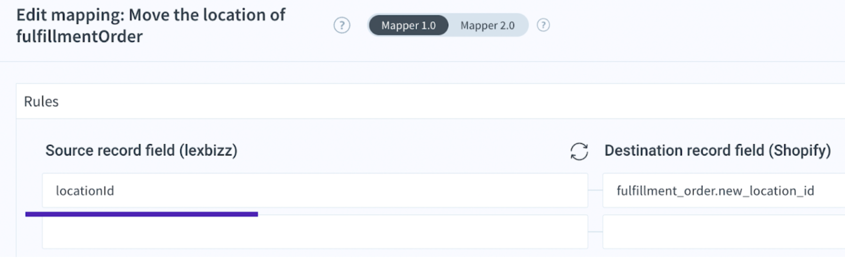

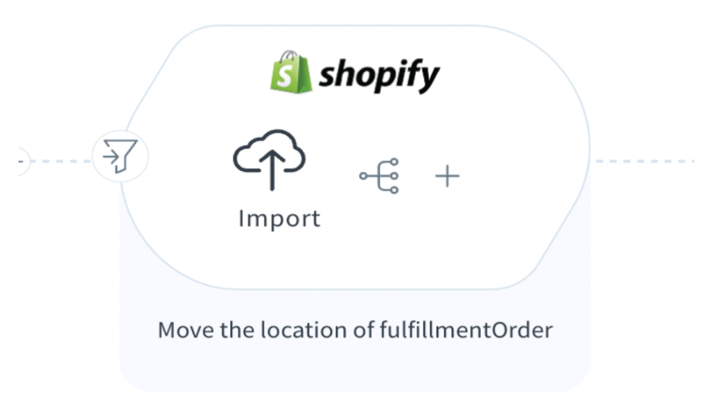

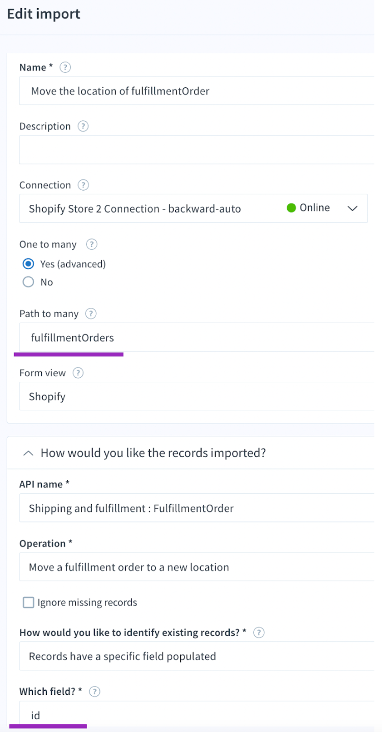

  13. Add a Shopify import step Move the location of fulfillment order to the right of this lookup. Move the location of the fulfillment order to the desired Shopify location, if you want to fulfill a fulfillment order other than its assigned_location_id. The Shopify location coming from the source application might be different. If the location is not moved, the fulfillment order is not fulfilled to the desired Shopify location.
    If you want to fulfill the fulfillment orders in their assigned location, ignore steps 13 to 16.
  14. Open the import, and set the following:
    1. One to many as Yes
    2. Path to many as fulfillmentOrders
    3. Which field?, provide the fulfillment ID value using handlebars.

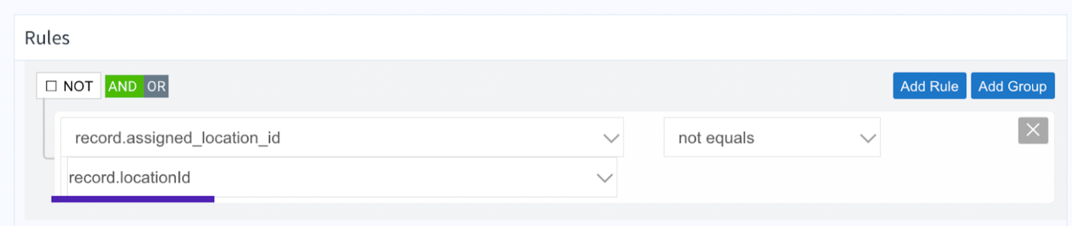

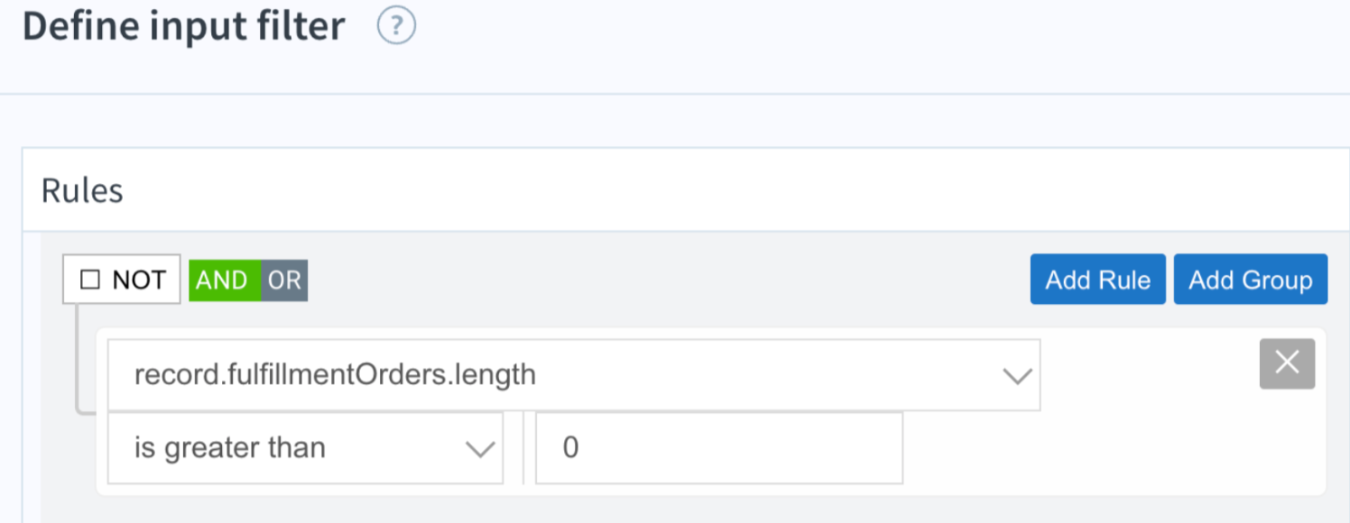

  15. Add an input filter to the above import to allow only the records for which the assigned location id of the fulfillment order is different than the Shopify location id coming from the source. If you are storing Shopify’s location ID in some field of a source record, select the field here, if it's a hard-coded value, enter the value with the data type of String, or if the source location ID is not one of the Shopify location ID, then configure the handlebars using compare function as per your requirement. If the Rules in the input filter cannot handle your requirements, use a script for the filter. For more information on how to create a script for a filter in Shopify - Acumatica and Shopify - MYOB templates, see Shopify - Acumatica and Shopify - MYOB Advanced documents respectively.
  16. Add mappings to the above import as per your requirement. If you are storing Shopify’s location ID in some field of a source record, select the field here, if it's a hard-coded value, enter the value with the data type of String, or if the source location ID is not one of the Shopify location ID, then configure the handlebars using compare function as per your requirement.

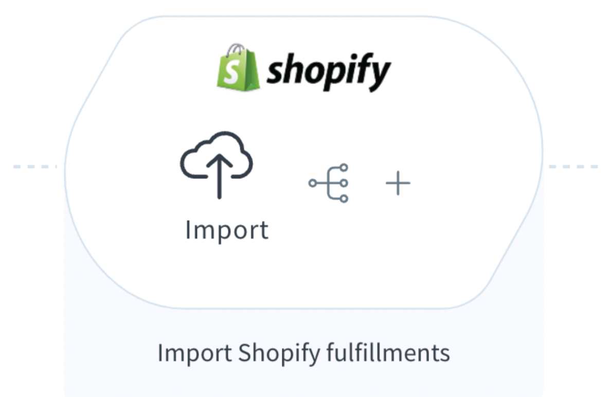

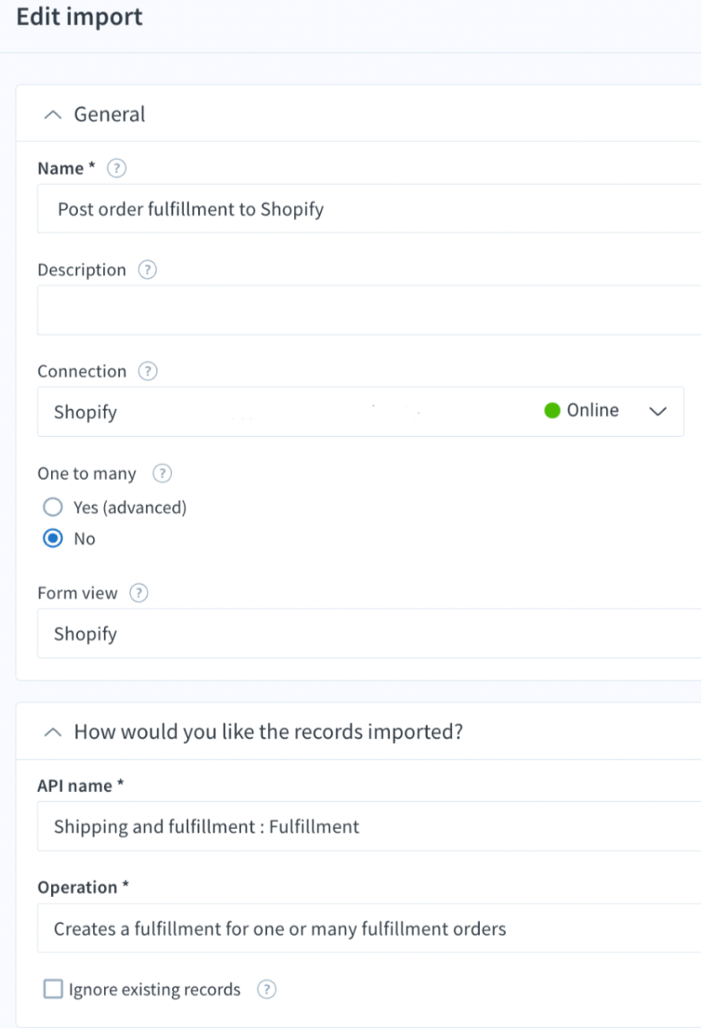

  17. Add another Shopify import step Import Shopify Fulfimments to the right of the above import to create fulfillment orders using the replacement endpoint.
  18. Open the import, and set the following:
    1. API name as Shipping and fulfillment : Fulfillment
    2. Operation as Creates a fulfillment for one or many fulfillment orders . Refer to the import from the old flow for any other configurations needed, for example adding One to many, etc.
    3. Add an input filter to allow only the records with fulfillmentOrders length greater than zero.

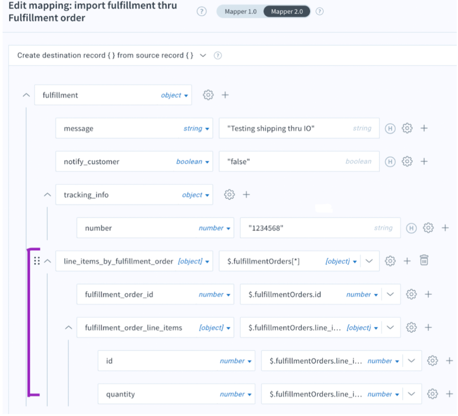

  19. Add mappings to the above import as shown below:
    1. Complete fulfillmentflow: The required mappings are demonstrated below (highlighted in purple).
      Source field
      Shopify field
      fulfillmentOrders[*].id
      fulfillment.line_items_by_fulfillment_order[*].fulfillment_order_id
      fulfillmentOrders[*].line_items[*].id
      fulfillment.line_items_by_fulfillment_order[*].fulfillment_order_line_items[*].id
      fulfillmentOrders[*].line_items[*]. fulfillable_quantity
      fulfillment.line_items_by_fulfillment_order[*].fulfillment_order_line_items[*].quantity
      Tracking Numbers
      fulfillment.tracking_info.number

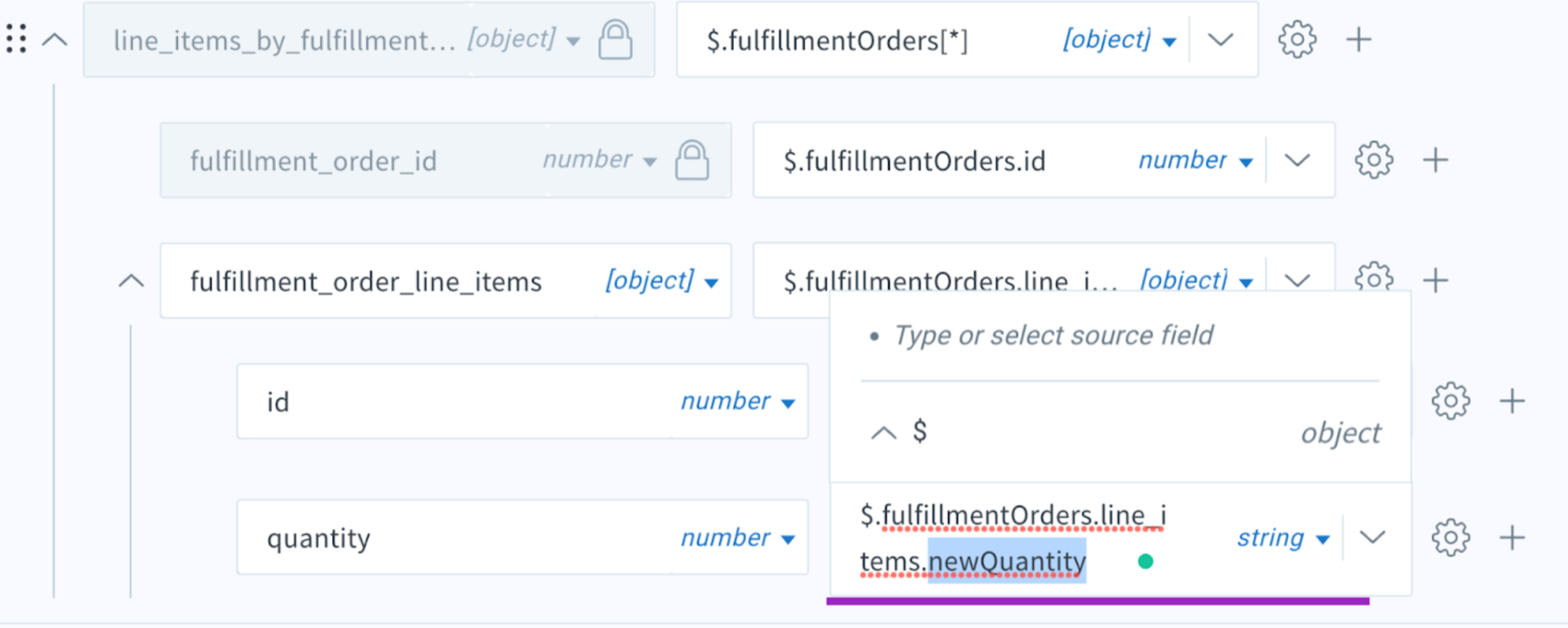

    2. Partial fulfillment flow : Use the new quantity field created in the above PostResponseMap hook and map that field with the quantity field under fulfillment_order_line_items as shown in the screenshot. For example, in the PostResponseMap hook, we have added the newQuantity field.
      Source field
      Shopify field
      fulfillmentOrders[*].line_items[*].newQuantity
      Tracking Numbers

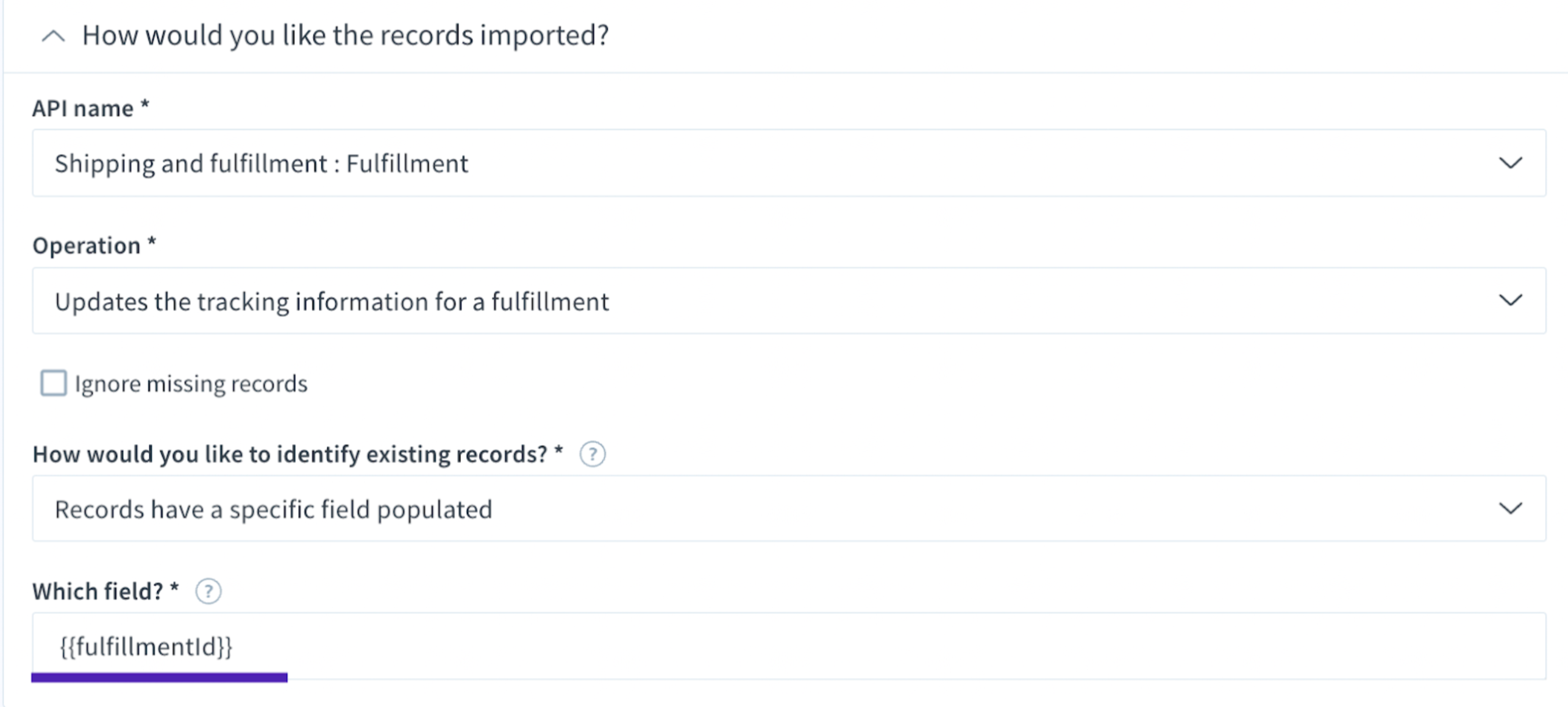

  4. Create an import using Updates the tracking information for a fulfillment or update the existing import by changing the endpoint to Updates the tracking information for a fulfillment.
  5. Provide the fulfillment ID value using handlebars. For example, see the screenshot below.

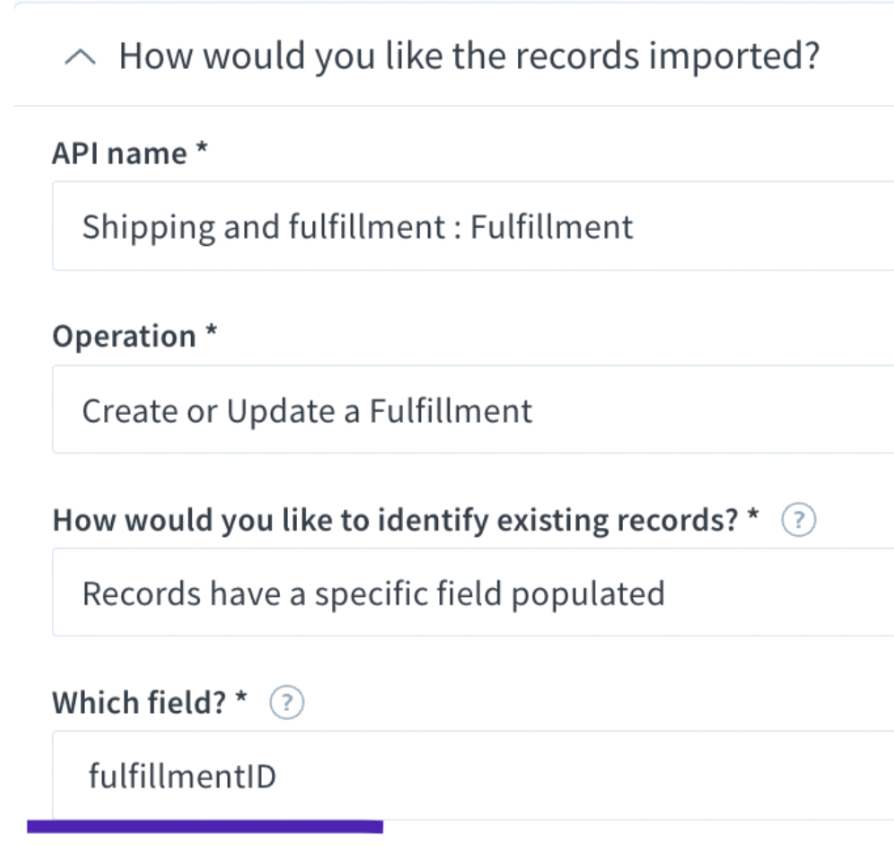

Create or Update(Deprecated) to Create or Update a Fulfillment
  1. Go to the existing flow that uses the endpoint Create or Update(Deprecated) .
  2. Open the fulfillment import mappings and take a screenshot or clone the flow to store the mappings and other components for future reference.
  3. Follow the instructions from Steps 3 to 16 in the section Create a new Fulfillment(Deprecated) to Creates a fulfillment for one or many fulfillment orders .
  4. After the 16th step, set the following:
    2. Operation as Create or Update a Fulfillment
    3. Which field? , provide the fulfillment ID value using handlebars.

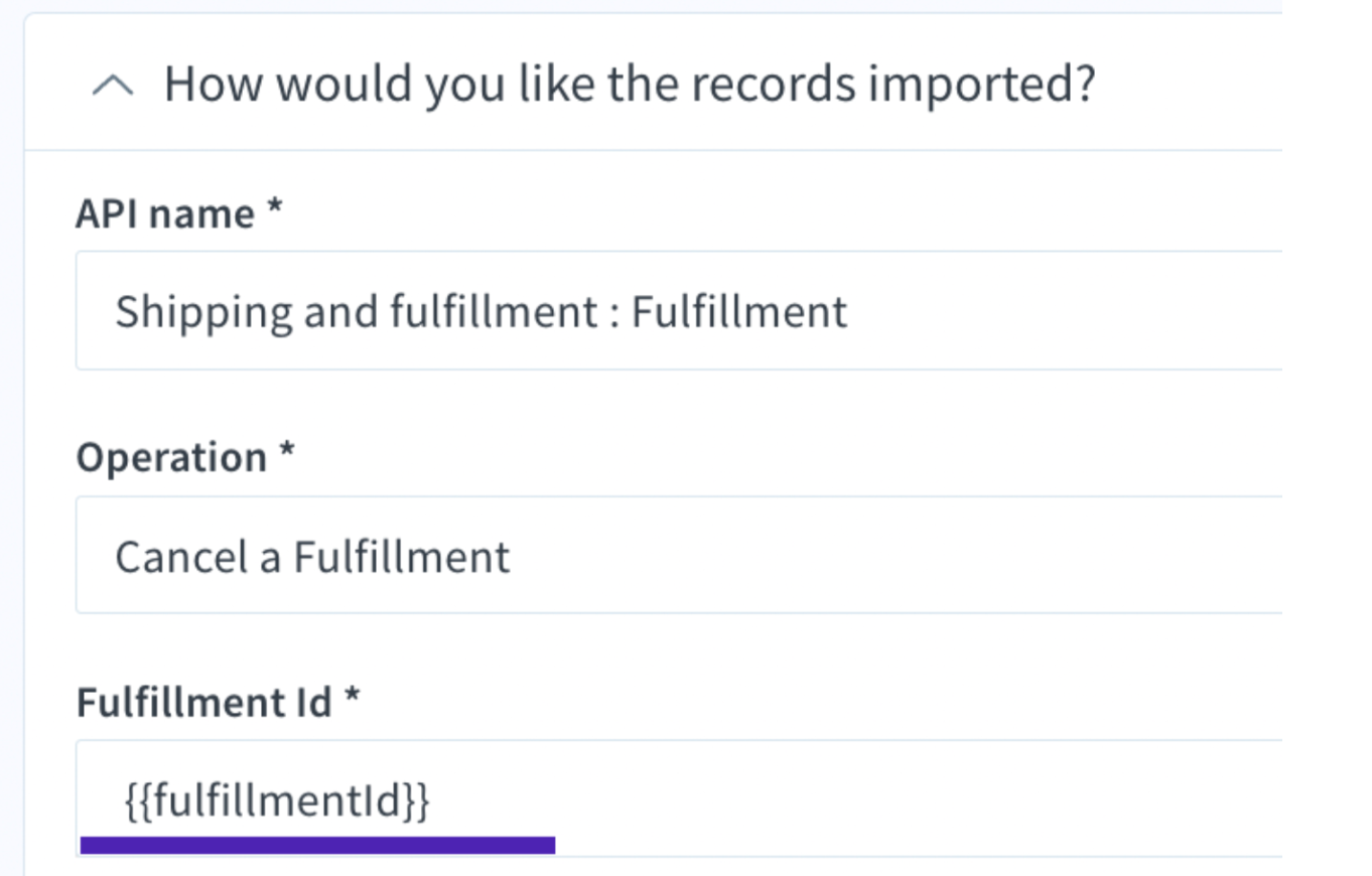

Cancel a Fulfillment(Deprecated) to Cancel a Fulfillment
  1. Go to the existing flow that uses the endpoint Cancel a Fulfillment(Deprecated) .
  3. Delete any import that is using this deprecated endpoint.
  4. Create an import using Cancel a Fulfillment or update the existing import by changing the endpoint to Cancel a Fulfillment .
  5. Provide the fulfillment ID value using handlebars. See the screenshot below for an example.
