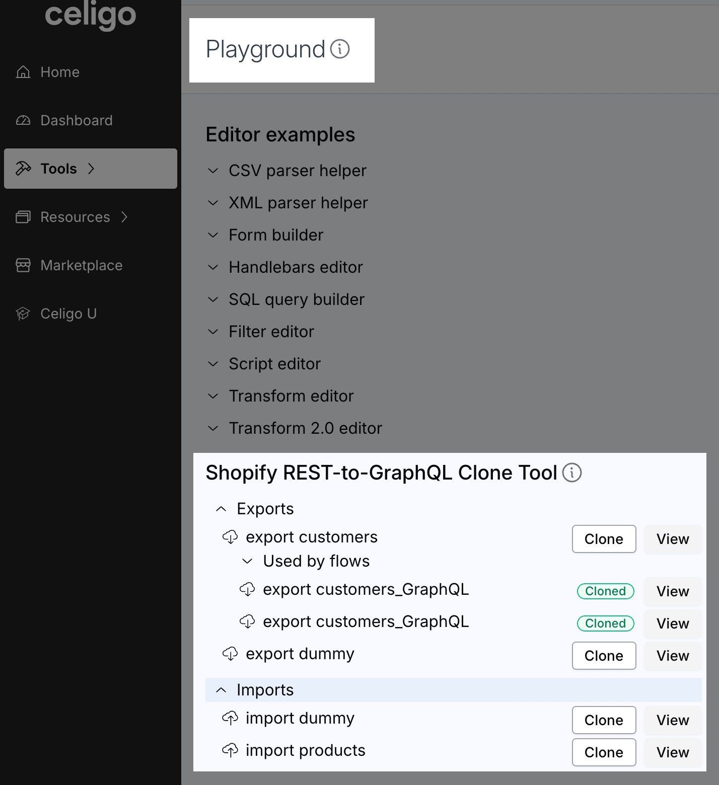

  2. Navigate to Tools > Playground > Shopify REST-to-GraphQL clone tool.
  3. Expand Exports to see the list of all Shopify exports.
  4. Choose the required export and click Clone.
    You can also View/Edit the export and see the flows where that export has been Used by.

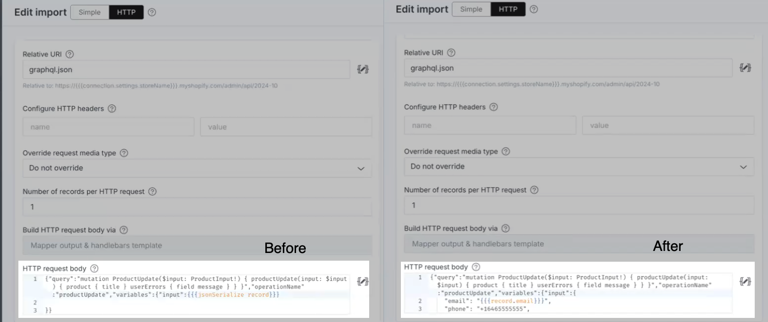

  5. Once cloning is complete, you can see the cloned GraphQL export under Exports. For example, if you clone an export named Test, it will appear as Test_GraphQL.

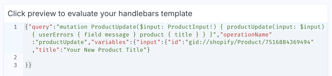

  6. The cloned export gets the GraphQL URL in the Relative URI and GraphQL query in the HTTP request body.
