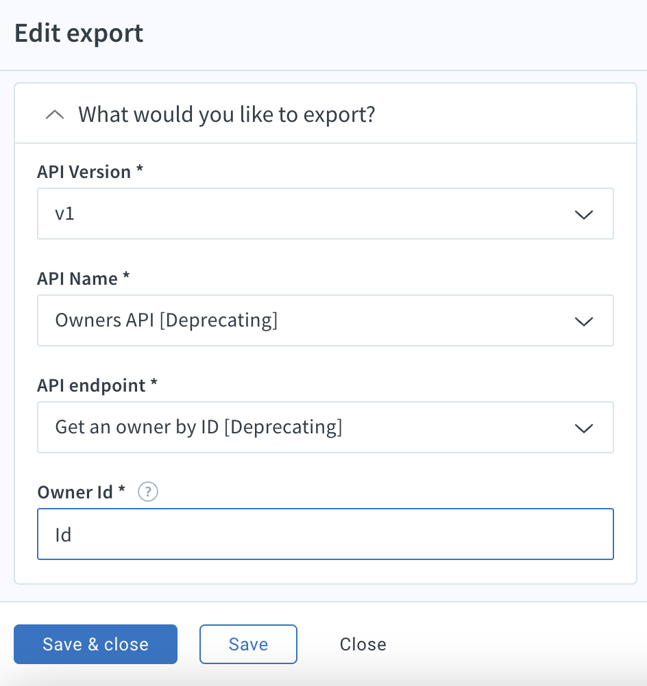

If the existing export is configured as follows:
API version: v1
API name: Owners API [Deprecating]
API endpoint: Get an owner by ID [Deprecating]

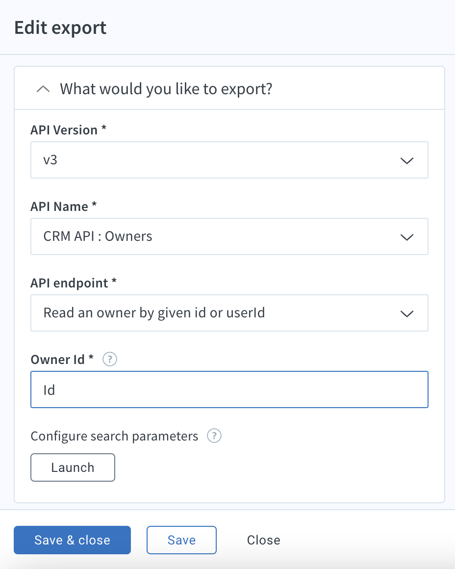

Then, convert it according to the above table, as follows, and as shown in the image below:
API version: v3
API name: CRM API: Owners
API endpoint: Read an owner by given ID or user ID
