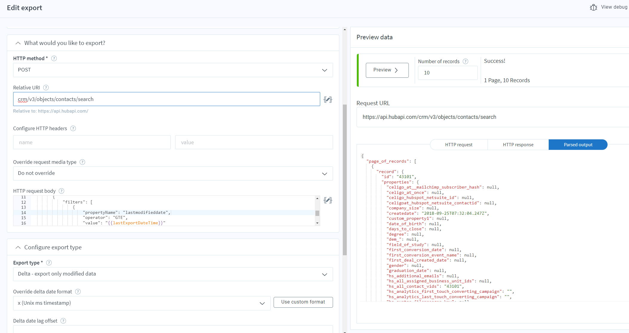

Create a HubSpot export and enter the general details. See Export data from an HTTP source application
In the What would you like to export? section, configure the following details:
{ "limit":100, "sorts": [ { "propertyName": "lastmodifieddate", "direction": "ASCENDING" } ], "filterGroups": [ { "filters": [ { "propertyName": "lastmodifieddate", "operator": "GTE", "value": "{{lastExportDateTime}}" } ] } ] } -

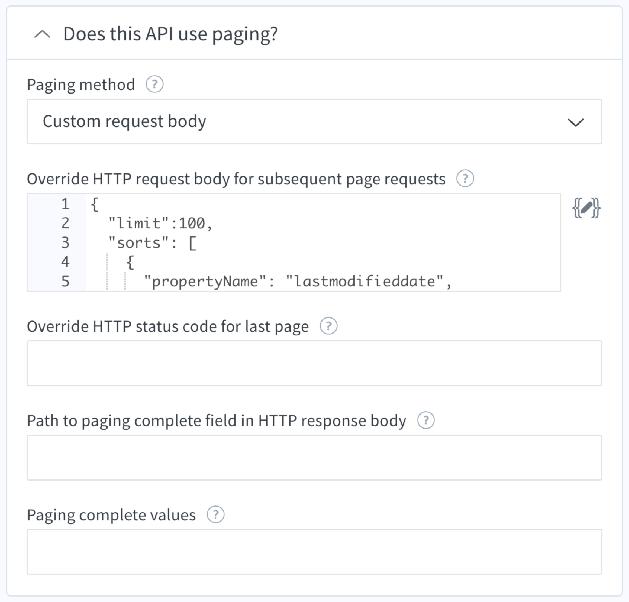

In Does this API use paging?, configure the following details:
{ "limit":100, "sorts": [ { "propertyName": "lastmodifieddate", "direction": "ASCENDING" } ], "filterGroups": [ { "filters": [ { "propertyName": "lastmodifieddate", "operator": "GT", "value": "{{{previous_page.last_record.properties.lastmodifieddate}}}" } ] } ] } -

Using this option, you can achieve full delta functionality in v3 of the HubSpot API with the following steps:
Create a HubSpot export with the following settings:
API version: v3
API name: CRM API: Companies
API endpoint: Search for Companies
In the Configure body parameters section, click Launch. The Search parameters window opens.
Enter the following code in the filterGroups section:
[ { "filters": [ { "propertyName": "hs_lastmodifieddate", "operator": "GT", "value": "{{lastExportDateTime}}" } ] } ] -
Save and close the filter, and run the flow.
