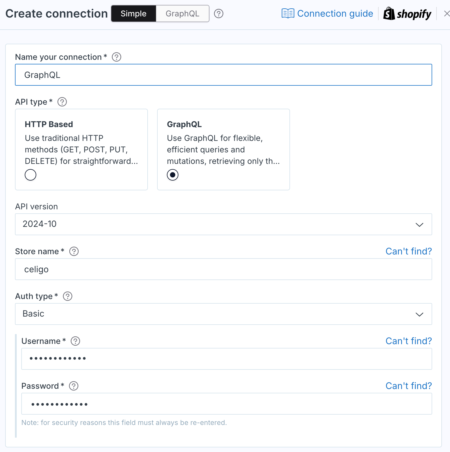

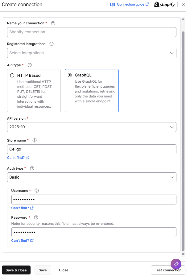

  1. Sign in to your Celigo integrator.io account.
  2. Navigate to Resources > Connections > + Create connection > select Shopify.
  3. Enter a Connection name.
  4. Select GraphQL as the API type. For detailed information, see Set up a connection to Shopify.

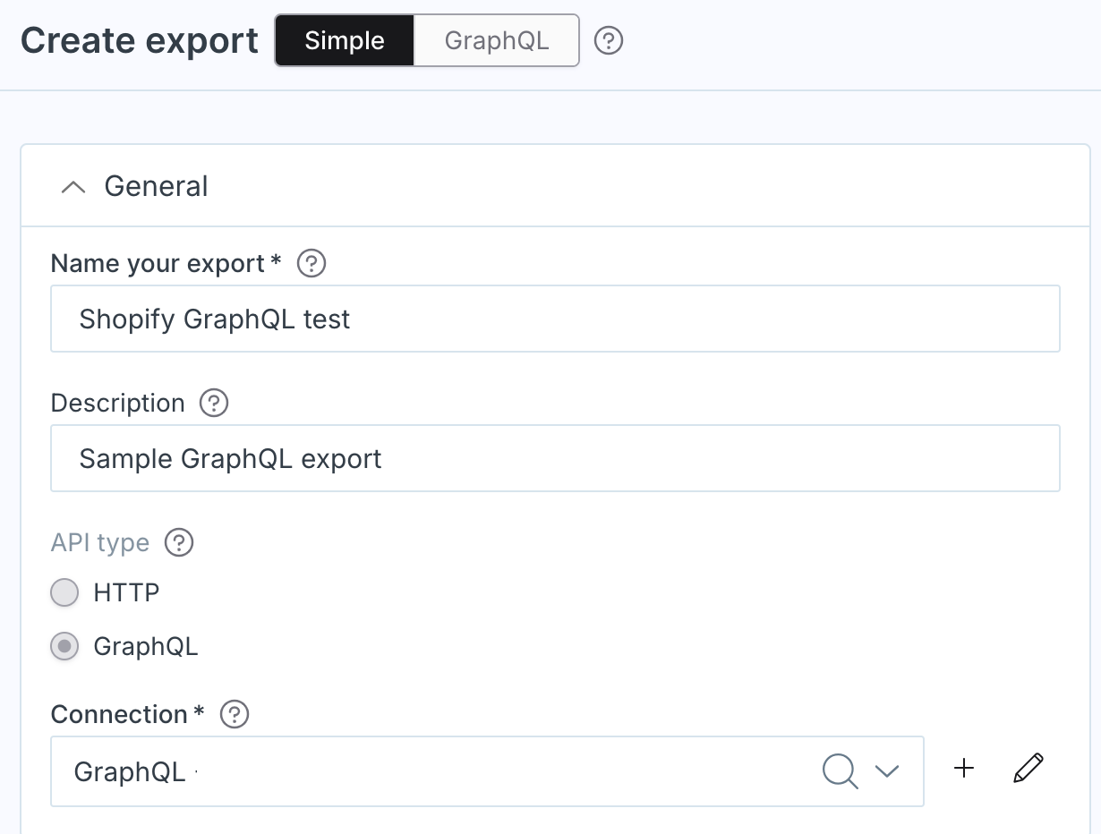

  1. Navigate to Tools > Flow builder > Add source > Select Shopify.
  2. In Flow step type, select Export records from source application.
  3. Enter a Name for your flow step.
  4. Click Next. The Create export page appears.
  5. In API type, choose GraphQL.
  6. In Connection, select the Shopify GraphQL connection that you created in the previous section.
  7. In What would you like to export?, build the GraphQL queries.
    You can switch to GraphQL form for more configuration, control, and authentication options. For detailed information, see Simple vs. HTTP or GraphQL forms.
  8. Configure the Export type and click Save and close.
