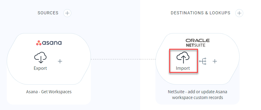

  1. Open the Edit import form for your import.

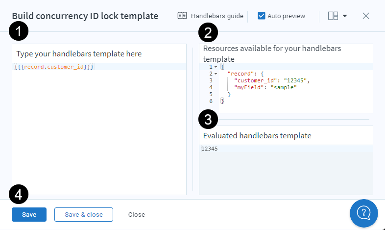

Build concurrency ID lock template
The concurrency ID lock template defaults to the trace key value. To change the concurrency ID lock, click the pencil icon (Open handlebars editor button) to the right of the Concurrency ID lock template field to open the editor.
  1. Type your handlebars template here: Enter the handlebars expression you want to use as your template.
  2. Resources available for your handlebars template: This displays sample data to test your expression.
  3. Evaluated handlebars template: This displays the value captured by your handlebars expression that would be used when processing the sample record.
  4. Save: Click Save or Save & close to save your configuration.
