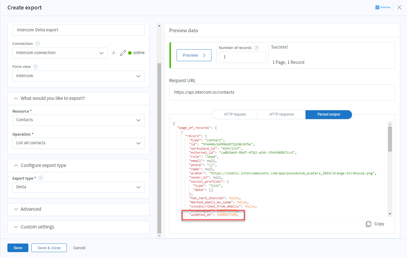

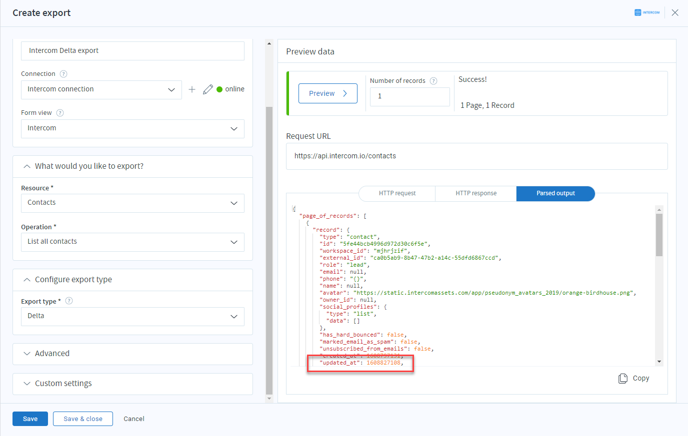

Create an Intercom export with the following settings:
Resource: Contacts
Operation: List all contacts
Click the Preview button, and record the JSON path to the “updated at” field in the response data – in this case, updated_at.
Save and close the export.

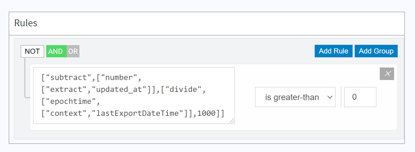

Returning to Flow Builder, create an output filter:
Click Define options (+) on the export, and select Output filter (
). The Define output filter panel opens with an empty initial rule.
Click to edit the Operand settings (
), set the Operand type to Expression, and click Save to close the dialog.
Paste the following expression into the first operand field, where
updated_atis the value from step 2 (see image below):["subtract",["number",["extract","updated_at"]],["divide",["epochtime",["context","lastExportDateTime"]],1000]] -
Choose is greater-than for the operator.
Change the second operand’s Operand type to Value and its Data type to Number, and set its value to
0.
Save and close the filter, and run the flow.
This new filter excludes all records that were modified before they were last exported, based on calculating the difference between the timestamps in updated_at and lastExportDateTime (after converting it from milliseconds to seconds). Thus, a record with a positive value – meaning that its “last exported” date/time is earlier than its “updated at” date/time – proceeds in the flow.
