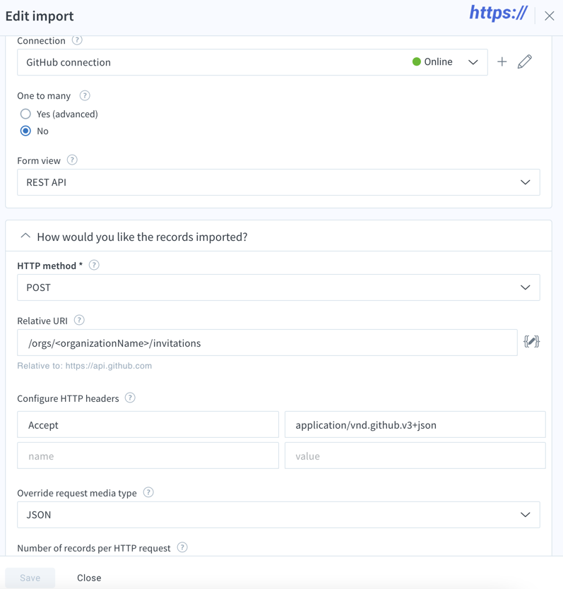

GitHub:
  • Configure mandatory mappings for email in the Import field (GitHub).
  • Configure the Relative URI with the organization name.
  • The provisioned user will receive an activation email once the user is created.

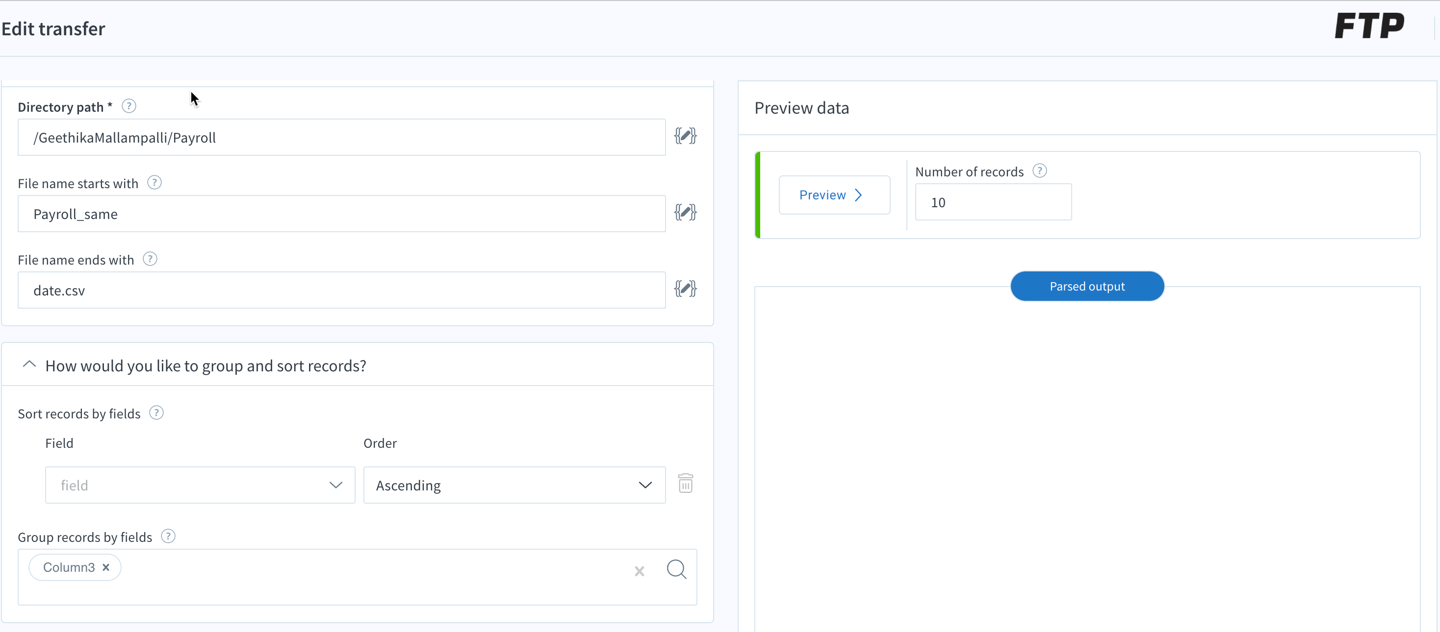

FTP: For FTP, the user has to generate a report from ADP in the format of a sample file and upload it to a FTP server.
To export files to the FTP server, referExport file to FTP server.
Under settings, configure Directory Path. Configure Backup Path only if files have to be moved to this path after processing. Otherwise, this field should be left blank.

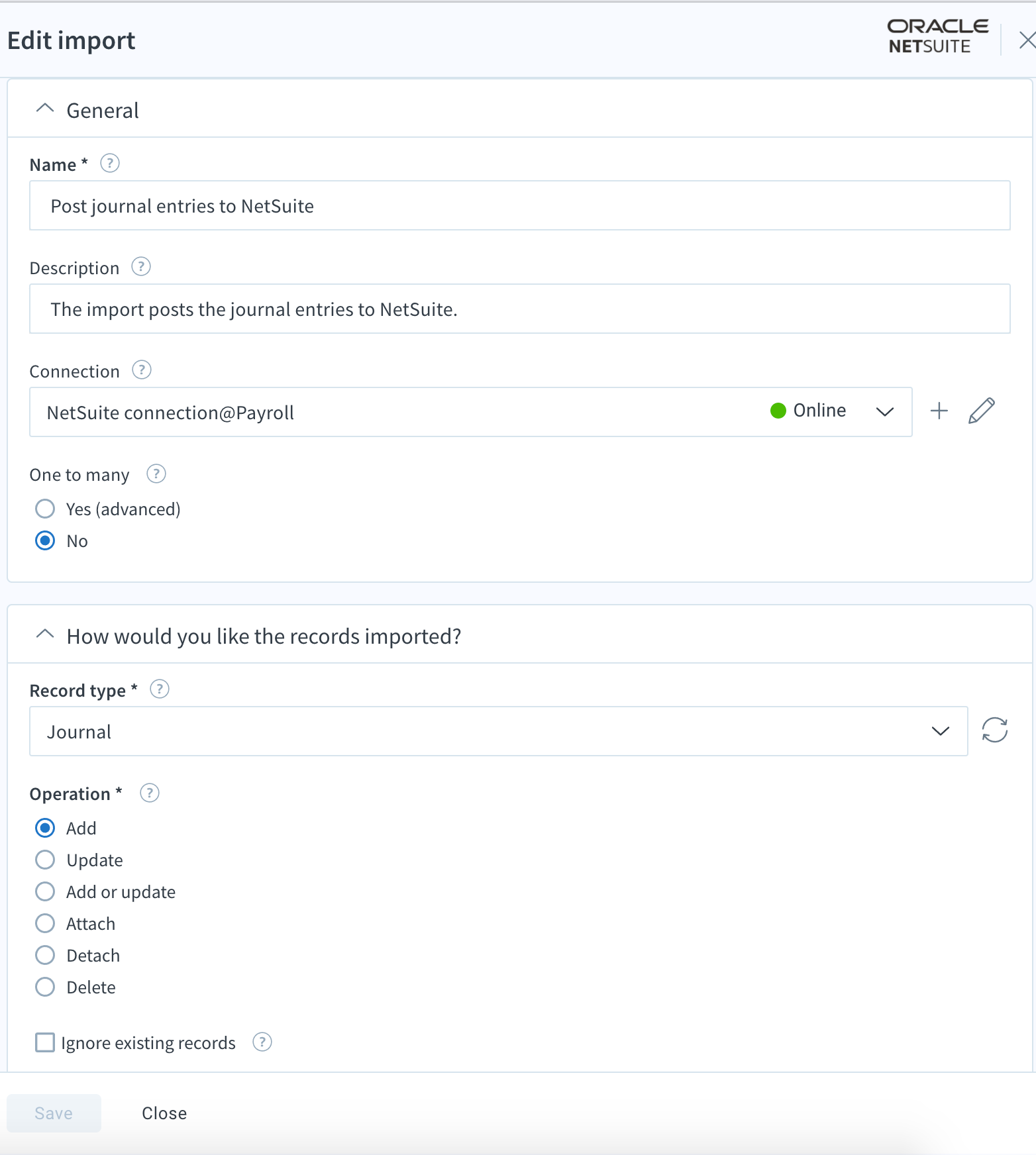

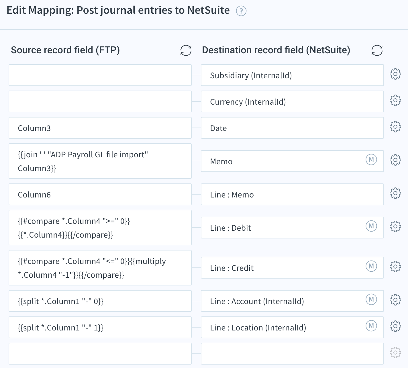

Configure input (Post journal entries to NetSuite)
  1. The default import setting of the Record type is set as Journal.
  2. Configure the subsidiary and currency fields in the mapping settings.

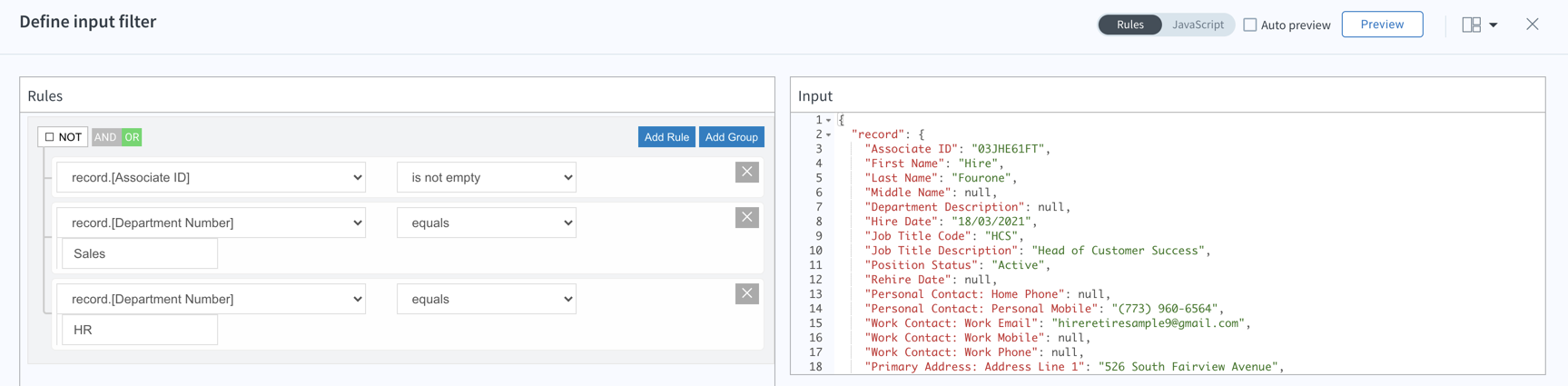

  • You can filter the employee department-wise on each Input application(by adding an input filter).
  • Below is an example, in case you want to define an input filter with criteria having Associate ID and Department Numbers.

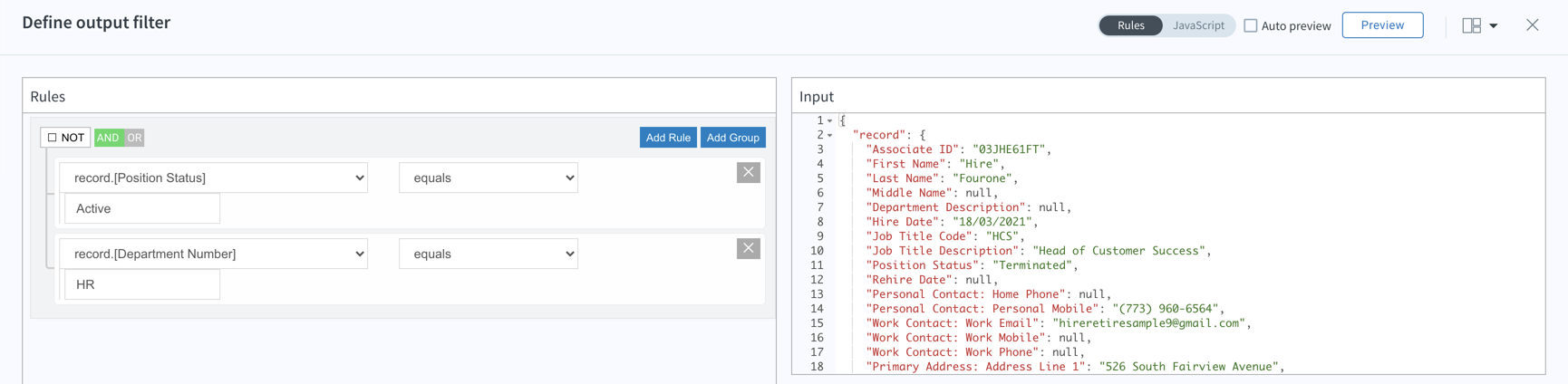

  • You can also create separate flows and add output filters to the export application.
  • Below is an example, in case you want to define an output filter with criteria having Position Status and Department Number.
