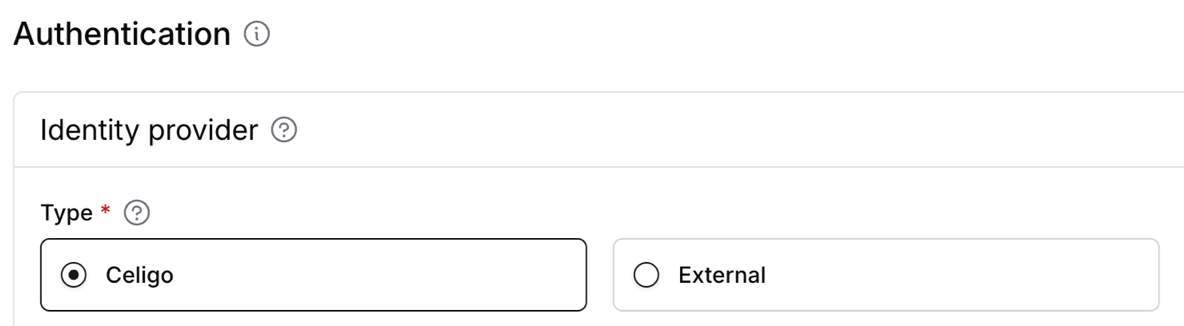

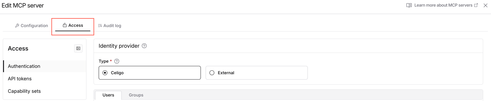

By default, all new MCP servers use Celigo Identity. Perform the following steps to switch providers:
When Token validation is selected, the Access tab no longer displays the Users list, as your IdP manages all access permissions. Furthermore, individual per-user logins (such as Gmail or Salesforce) aren't supported with Token validation.
Select an identity provider

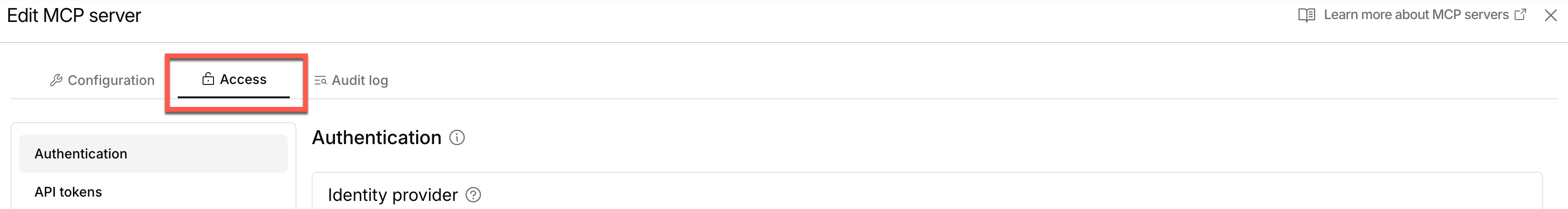

  1. Go to AI studio → MCP servers and select the server.
  2. In the Access tab. On the left, by default, the Authentication tab is selected.
  3. You can configure either of the following authentication Type under Identity provider:

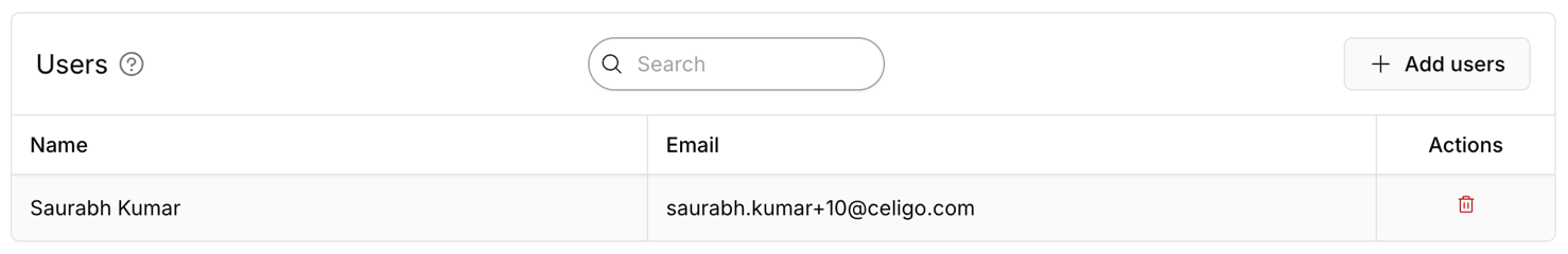

    • Celigo Identity: When you select Celigo Identity, the Access tab displays Users, Groups, and Roles tabs to manage access to the MCP server.
      • Users: Displays end users with access to the MCP server and the following details:
        • Name: The end user's name.
        • Email: The end user's email address.
        • Access via: Shows how the end user receives access to the MCP server:
          • Direct: Access assigned directly to the end user.
          • Group name: Access inherited through a group.
          • Role name: Access granted through an assigned role.
          • —: No access source is displayed.
          Multiple entries appear when access is granted through more than one source. Select the + Assign roles entry to see the roles and the capabilities they grant.
        • Remove: Select the delete icon to remove the end user's assignment to the MCP server.
      • Groups: Displays assigned groups with their Name/Description and Users count, and a Remove column.
      • Roles: Displays assigned roles with their Name/Description and Users count, and a Remove column.
      You can search for assignments, assign additional users, groups, or roles, and remove existing assignments from the corresponding tab by selecting the delete icon in the Remove column.

      To assign users, groups, or roles:
      1. Go to AI studio > MCP servers, and open the MCP server.
      2. Select Access > Authentication. Make sure Celigo Identity is selected.
      3. Select the required tab:
        • Users: Select Assign users.
        • Groups: Select Assign groups.
        • Roles: Select Assign roles.
      4. In the Users, Groups, or Roles step, search for and select the users, groups, or roles you want to assign.
      5. In the Capabilities step, select the capabilities to grant access to. Use Capability sets, Tools, APIs, Prompts, and Resources to find them.
      6. Select Save & close.
      For more information about managing access, see Invite and manage end users, Create and manage end user groups, and Create and manage end user roles.

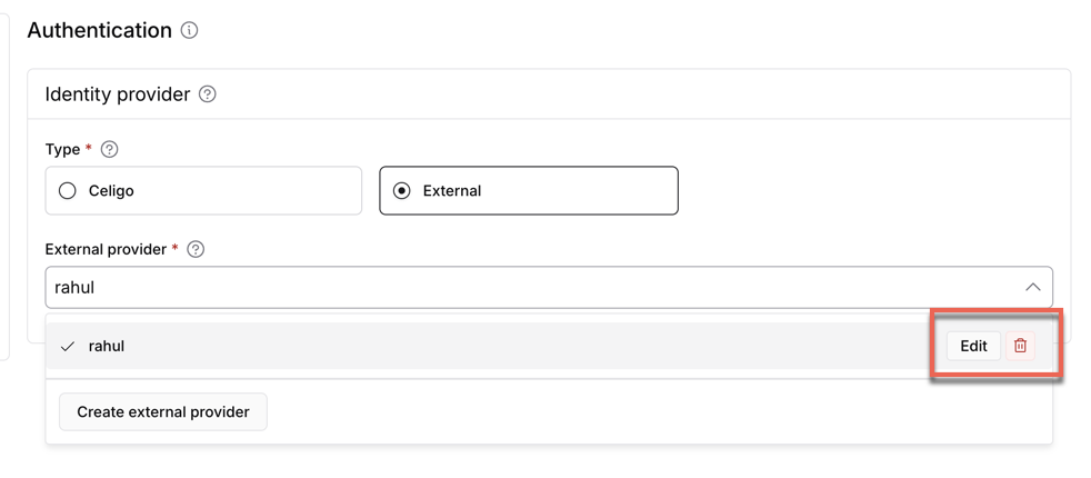

    • Token validation: Previously, you entered external IdP settings separately on each MCP server. Now, you configure an external IdP once at the account level and reference it from any MCP server.
      1. If you have previously created a user, use the Token Validation drop down to select an existing IDP.
        Or
      2. Click Create external provider to add a new one and enter the required details:
        • Name: Name your external provider.
        • Issue URL: The expected token issuer (iss). Copy this from a real access token issued by your IdP.
        • Audience: The expected token audience (aud). The MCP server accepts tokens only if their audience matches this value.

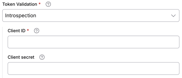

        • Token validation: Select how an MCP server validates access tokens.
          • JWKS (JSON web key set): Validates JWT access tokens locally using the issuer’s JWKS. Requires JWT access tokens.
          • Introspection: Validates tokens by calling the issuer’s introspection endpoint. Use this for opaque tokens or revocation-sensitive setups. Requires Client ID (required) and Client Secret (optional).
            Client ID and Client secret (Introspection only): Credentials used by an MCP server to authenticate the issuer’s introspection endpoint. Store these securely and rotate them if exposed.
        • Permissions: Select the permissions this MCP server requires.
          • mcp:read: Allows read-only / non-destructive MCP operations.
          • mcp:write: Allows operations that may change data or state.
            The token must include the required scopes (commonly in a scope or scp claim, depending on IdP). If a token is valid but missing required scopes, access will be denied.
      3. Click Save & close.The newly created external provider name is displayed in the External provider field. You have options to Edit or Delete the selected provider.
      4. Click Save & close.

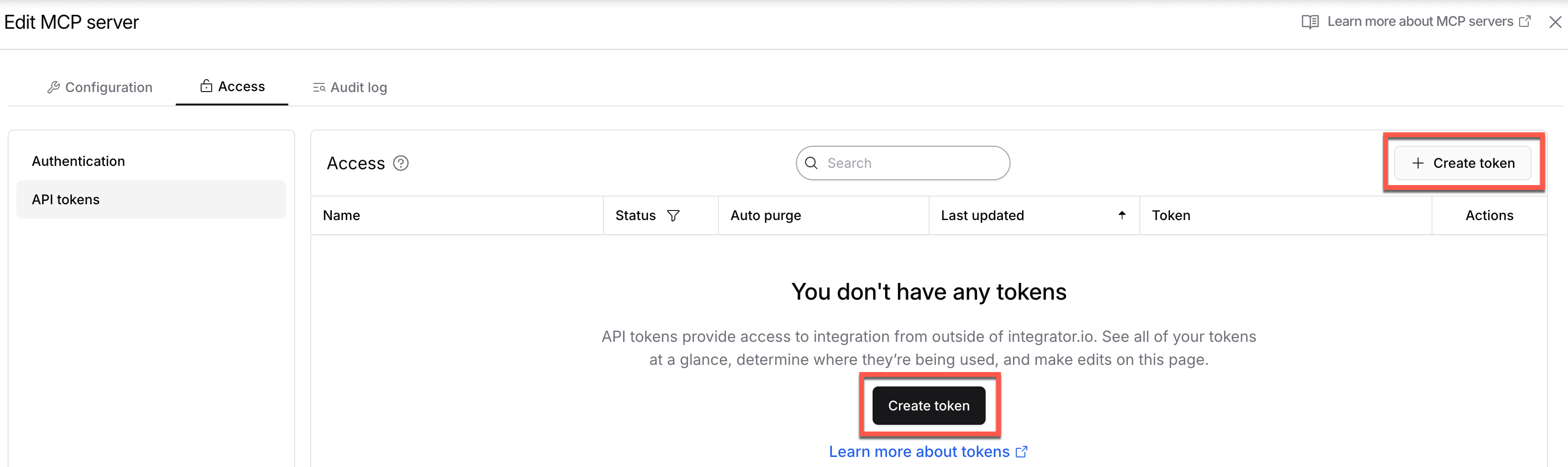

Configure API token
  1. In the Access tab, If you don’t have any existing tokens click Create token.
    If you have previously created a token, click + Create token in the upper right side of the page.

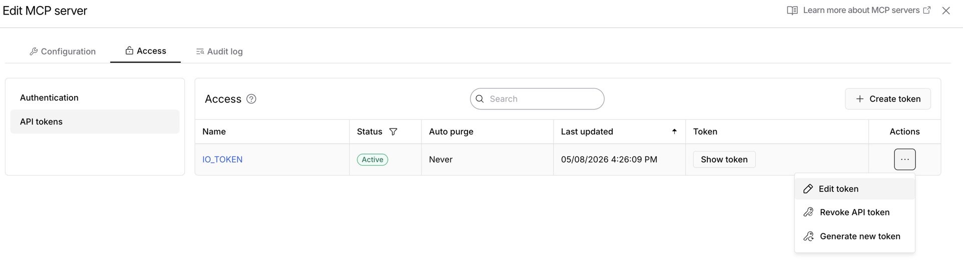

Manage an API token
Maintaining an API token after it's been created is very straightforward. The Access section lists all the API tokens you've created, including:
  • Name: Displays the name you gave your API token
  • Status: Displays current API token status (Active or inactive)
  • Auto purge: Displays time selected for the API token to auto purge
  • Last updated: Displays the last updated date and time
  • Token: Displays the token to copy, click Show token and select the copy button
  • Actions: You can perform the following action for each token:
    • Edit token
    • Revoke API token
    • Generate new token
