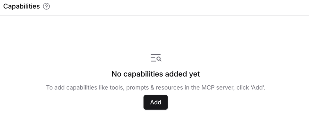

  1. While creating an MCP server, on the right side, in the Capabilities section click Add. The Add capabilities page is displayed.

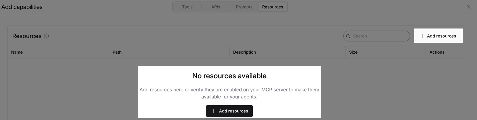

  2. On the top of the page, click Resources. If you don’t have any existing resources click Add resources.
    If no resources have been added yet, the Resources tab displays: "No resources available. Add resources here or verify they are enabled on your MCP server to make them available for your agents."
    If you have previously added a resource, click + Add resources on the upper right side of the page.

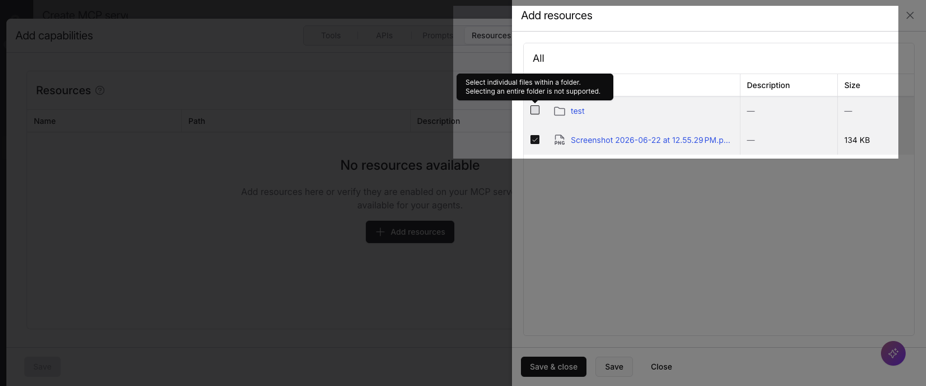

  3. The Add resources window opens, showing your Celigo file storage folders and files. Select the files you want to add.
    • Check the box next to each file you want to add.
    • Folders cannot be selected. Click a folder to open it and select files inside it.
    • The parent folder shows how many files are selected inside it.
    • Files must be under 3 MB to be read by agents. Larger files can be attached but return an error when an agent reads them.
  4. Click Save & close to apply your selection and return to the Add capabilities page.
