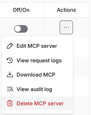

Go to AI studio > MCP servers to see every MCP server in your account. The list shows the key details for each server.
MCP servers list with the Actions menu open.
To install an MCP server from a ZIP file, select Upload next to Create MCP server. See Upload an MCP server.

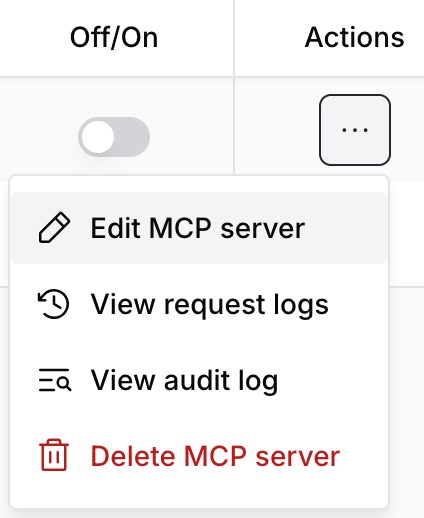

Select Actions (...) next to a server to open these options:
  • Edit MCP server – Update the server's configuration and the tools it exposes.
  • View request logs – Open the server's request history to see every request MCP clients sent, open a trace view for a request, and delete stored request data.
  • View audit logs – See the history of configuration changes made to the server.
  • Download MCP – Downloads the MCP server as a ZIP file that you can upload to another account or environment.
  • Delete MCP server – Remove the server from your account.

  2. Click the Actions (...) icon for the required MCP server and select Edit MCP server.

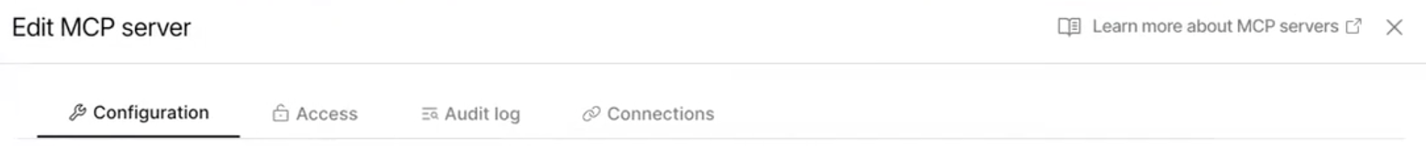

  3. Use the following tabs to make the required changes in the Edit MCP server page.
    Edit MCP server page showing the Configuration, Access, Audit log, and Connections tabs.
Edit MCP server tabs
Tab What you can do
Configuration Add or remove MCP tools, rename the server or update its description, edit the server URI, view or update the assigned token, and enable or disable the server. Select Test server to see the tools the server exposes.
Access Choose how users and clients authenticate to the server, manage API tokens, and see which end users, groups, and roles have access. Create capability sets to assign groups of capabilities together. For more information, see Set up authentication for an MCP server, Create and manage capability sets on MCP servers, and manage API tokens.
Audit log View detailed configuration change history for a selected time frame. Select Download to export the details.
Connections View the connections used by the server's tools, configure end user authentication for a connection, and check the status of connections that end users have configured.

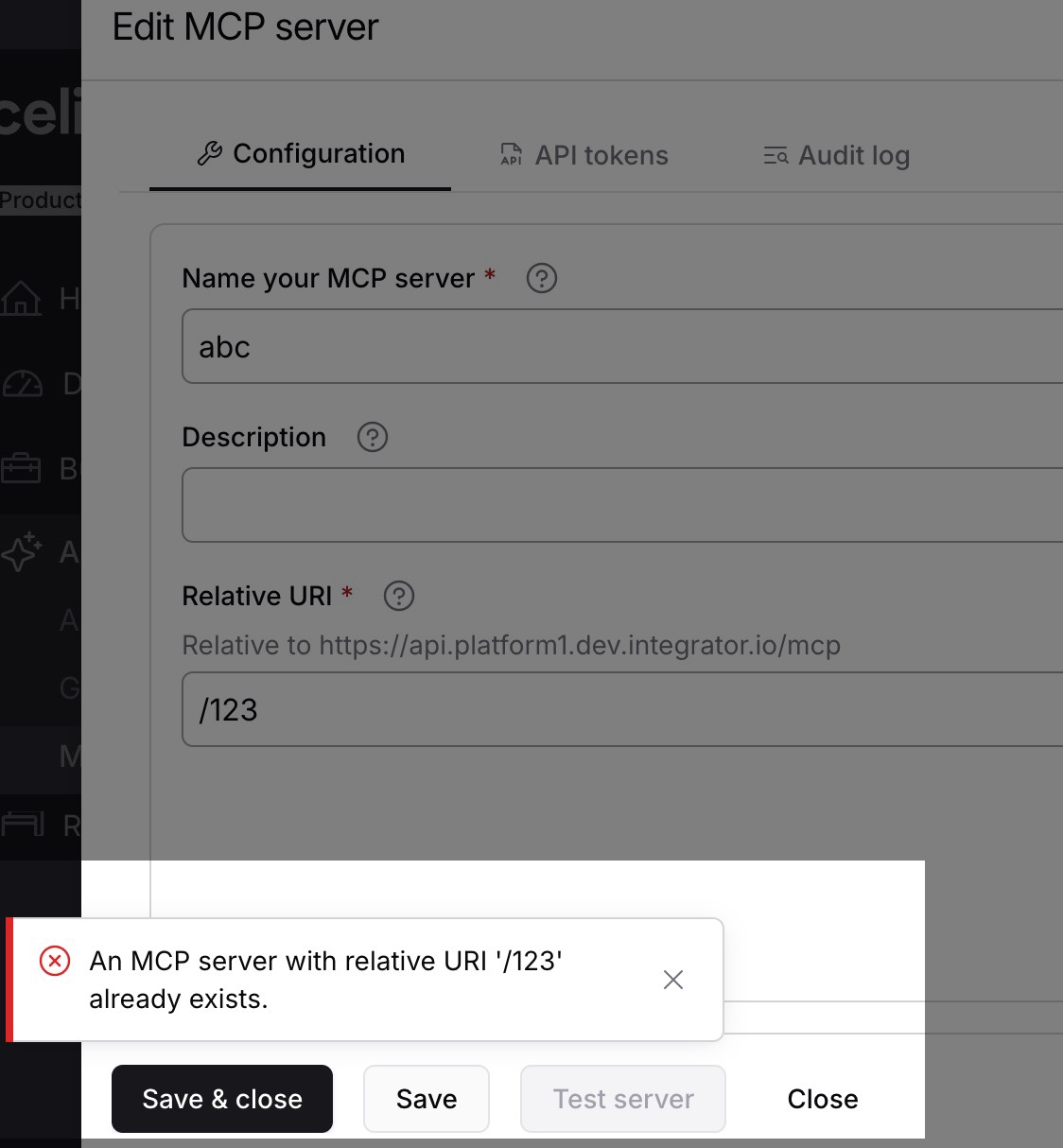

Set the MCP server URI
The Relative URI field sets the resource path that MCP clients use to reach the server. The URI must meet these rules:
  • It's a single root-level segment.
  • It starts with exactly one leading slash (for example, /orders).
  • It contains no other slashes, so nested paths such as /sales/orders aren't allowed.
  • It's unique within your account.
If another MCP server in your account already uses the same URI, you see this error when you save: An MCP server with relative URI 'URI name' already exists. Enter a different URI and save again.

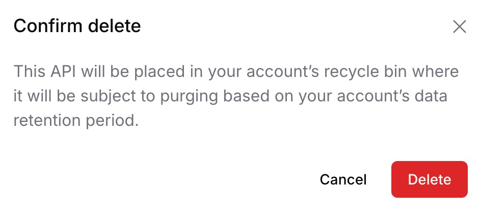

Delete an MCP server when you no longer need it. Only account owners and administrators can delete MCP servers.
Before you delete a server, remove all the associated references to it. For example, if an access token is assigned to the MCP server, go to the Access tokens tab, find the token, and delete it first.
Confirmation to delete an MCP server.

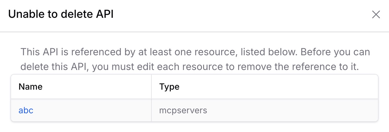

If the server is still referenced by another resource, Celigo blocks the deletion and shows this message:
Unable to delete MCP server. This MCP server is referenced by at least one resource. Before you can delete this MCP server, you must edit each resource to remove the reference.
Message shown when an MCP server can't be deleted because another resource refers to it.
