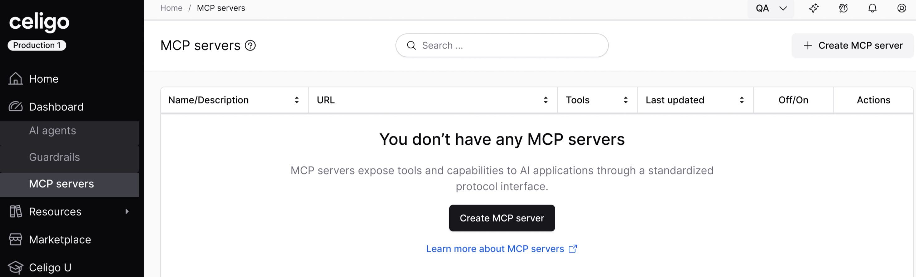

  1. Navigate to AI studio → MCP server. If you don’t have any existing servers click Create MCP server.
    If you have previously created a server, click + Create MCP server in the upper right side of the page.

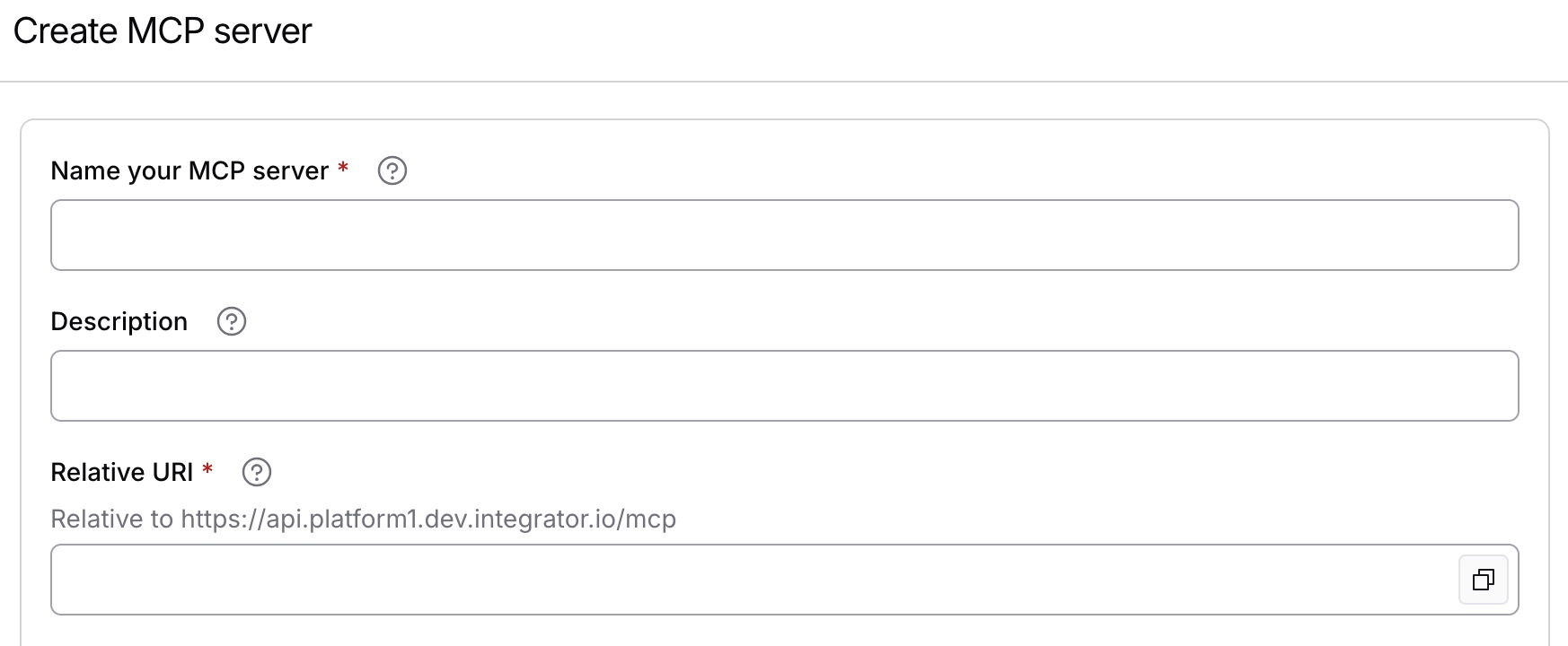

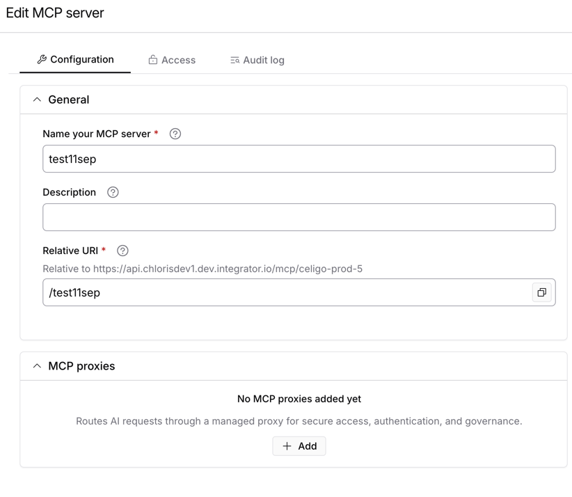

  2. In the Create new MCP enter the following required details:
    • Name your MCP server - Name your MCP server to reference it from other parts of the application.
    • Description (optional) - Enter a clear and concise description of your MCP server to help your AI agents and others understand its purpose. Keep this description updated as you make changes.
    • Relative URI - Use this field to define a unique Relative URI or the path of your MCP server within your account. The field value should start with “/” and cannot be empty.
    • MCP proxies - Add capabilities from an external MCP server to make them available through this MCP server. Select an MCP connection, then choose the tools, prompts, and resources you want to expose. Learn more about how to add MCP proxies.

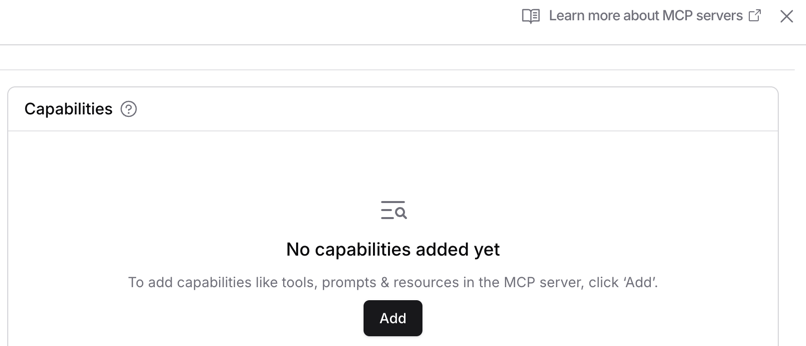

  3. On the right side, In the Capabilities section click Add.
  4. In the Add capabilities page, select the APIs, tools, prompts, and resources you want to expose as MCP tools from the available list or search to select.

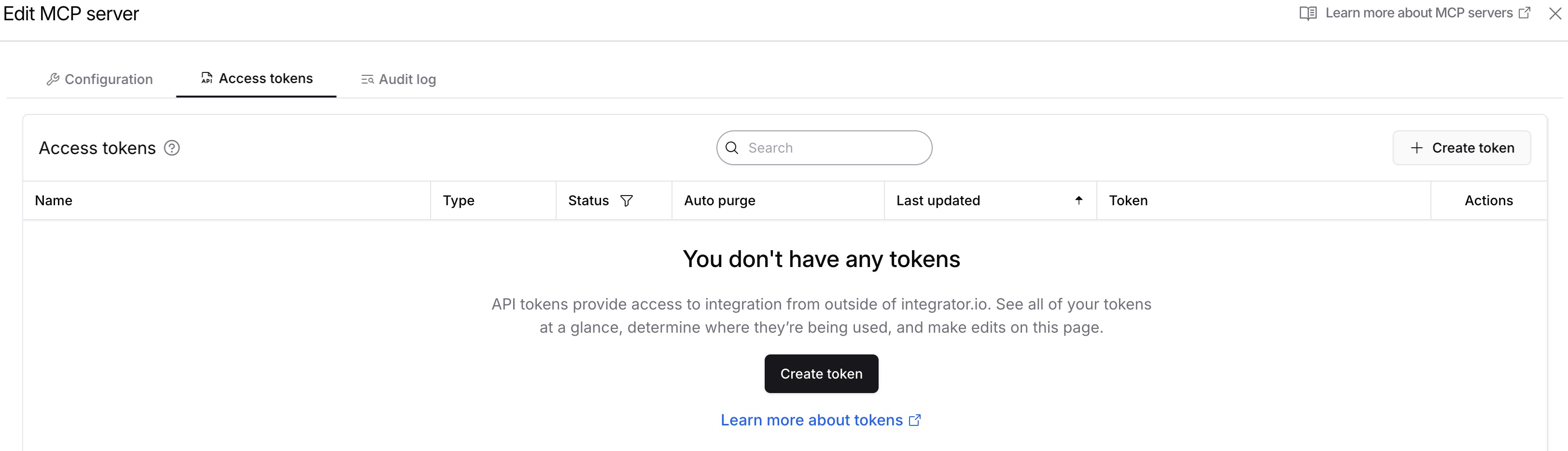

  1. Click Save. On saving, the page name changes from Create MCP server to Edit MCP server. You must assign an access token to invoke the MCP server. To add, click the Access tab and select API token. Select from the existing list or if you wish to create a new token click Create token. Click Close. The MCP server is now listed in the MCP servers page. It's a good practice to enable and test the MCP server.

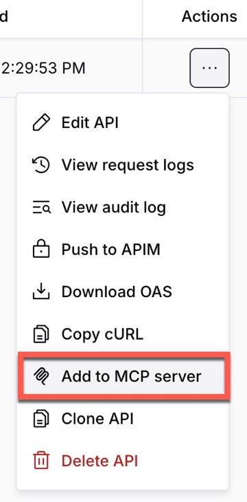

  1. Navigate to Resources → API → Actions (...) → Add to MCP server.
  2. Choose one option:
    • Create new MCP server: If you want, create a new server and add the selected API as a tool.
    • Add to existing MCP server: Adds the selected API to an existing server.

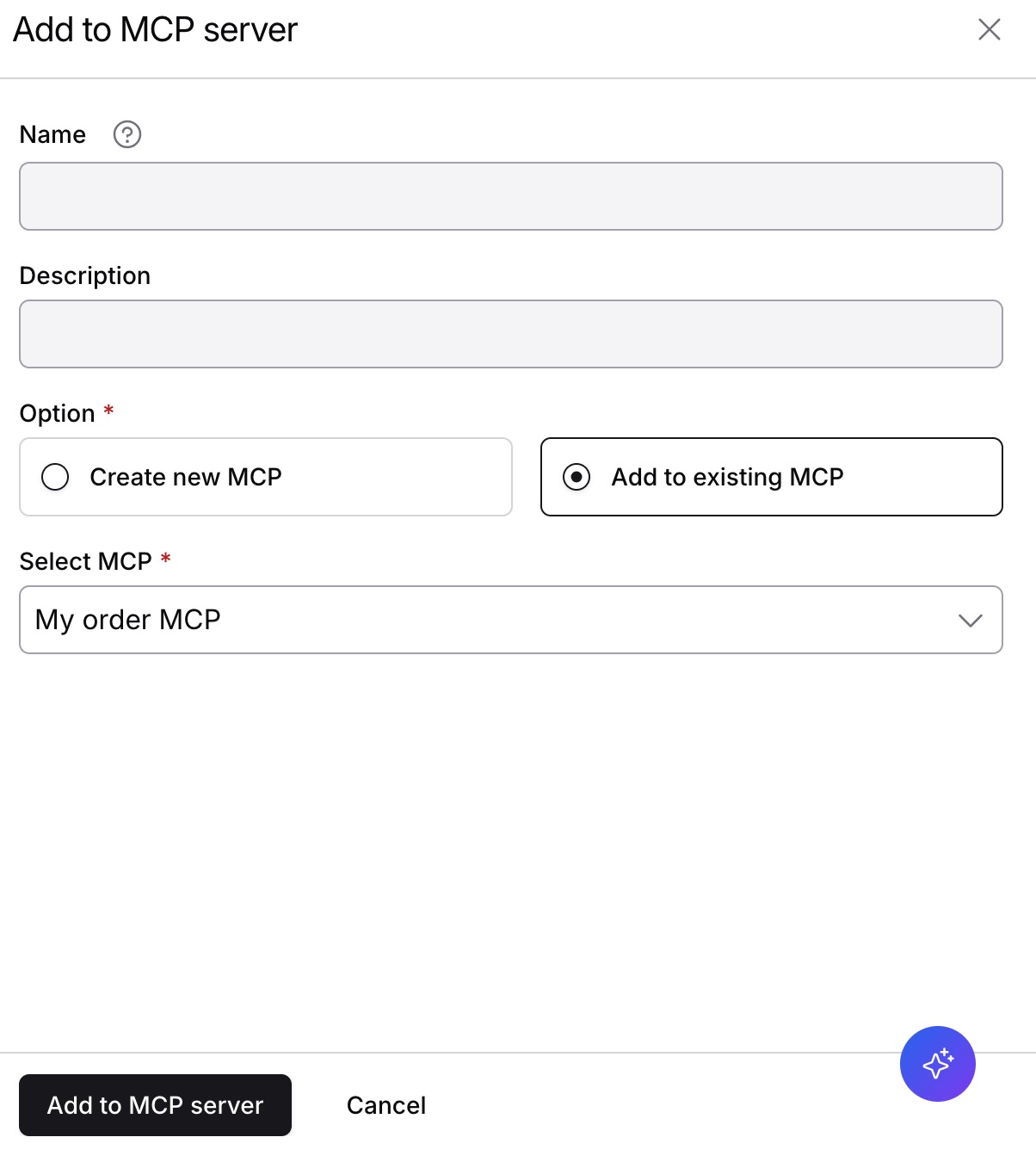

  1. Navigate to Resources → API → Actions (...) → Add to MCP server. Then, select Add to existing MCP under the Options field.
    Select MCP server field is available only on selecting Add to existing MCP option.
  2. Select an MCP server from the Select MCP server drop down and click Add to MCP.

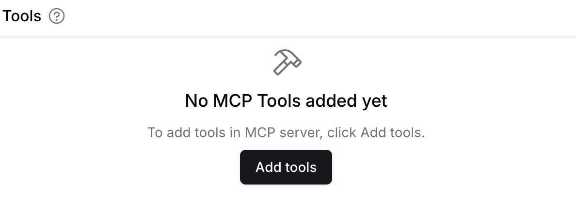

The Capability section on the right side of the Create MCP server or Edit MCP server page allows you to add MCP tools.
  1. Click Add. The Add capabilities panel opens.

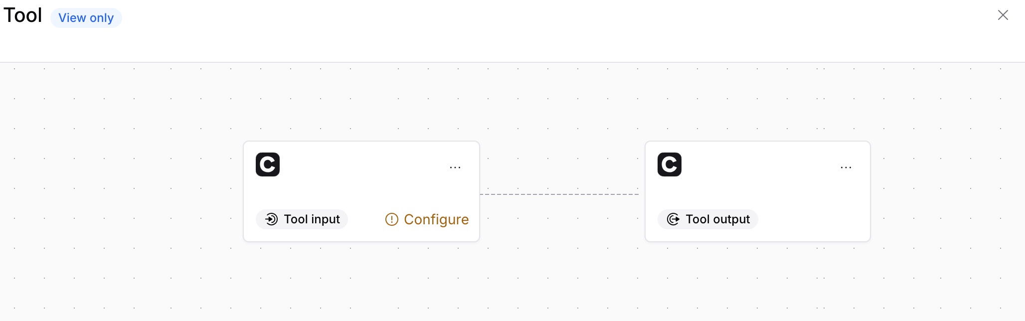

  4. Click the View icon in the View column next to the added Tools, APIs, Prompts, and Resources, to open it in Flow Builder. Review the configuration, then close Flow Builder to return.

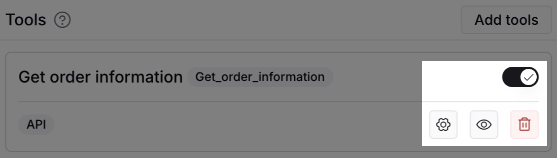

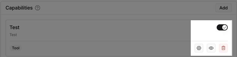

All the selected APIs are added to the MCP server. For each tool you have options to:
  • Enable/Disable
  • View - Click to view it in the flow builder and close it.
  • Delete - Click to delete the tool.

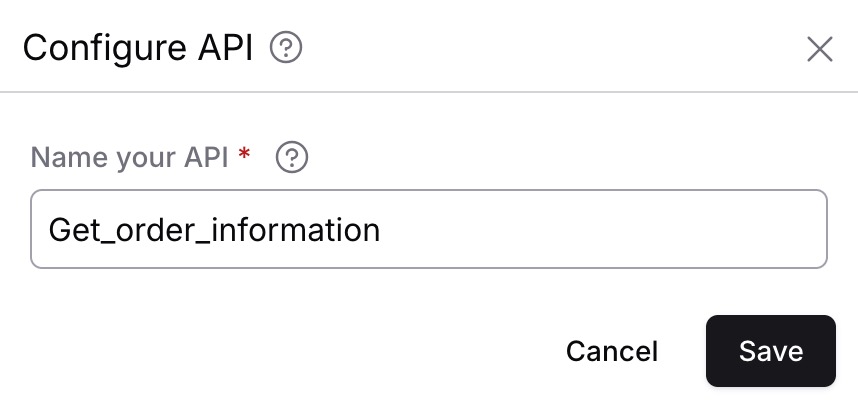

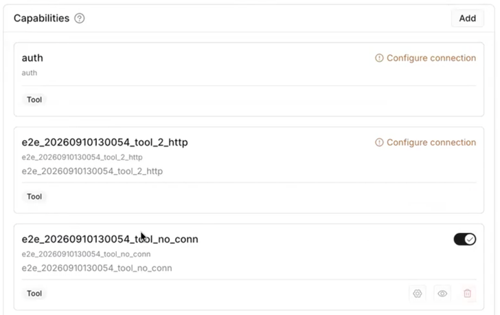

  • Configure - Click the gear icon to rename the tool, select the required Annotations, and configure connection. Then, click Save.
    Note: Configure connection appears only for tools that use a connection.
