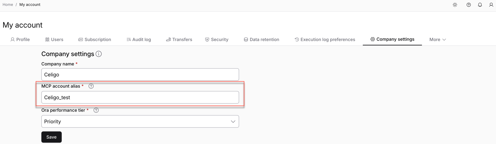

    To create an account alias:
    1. Sign into integrator.io as an account owner or admin, click the avatar icon in the upper right corner of integrator.io, then click Company.
    2. Select Company info tab on the left.
    3. In the MCP account alias field, enter a unique alias name.
    4. Click Save. The alias you create will be a part of all the MCP URL.

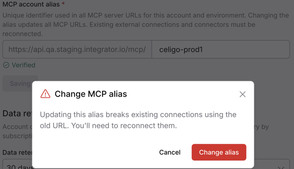

    Avoid changing the account alias after it is set. Updating the alias changes all MCP URLs, which can break existing connections. You must update and rebind any integrations using the new URL.

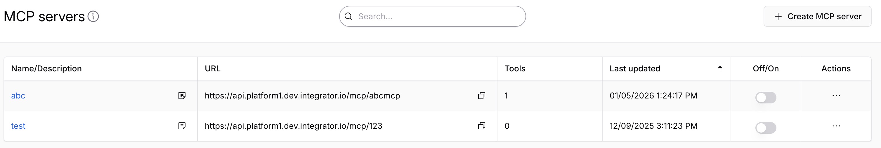

Go to AI Studio > MCP servers to create and manage MCP servers, manage tools, assign tokens, and review activity.
The main dashboard provides a comprehensive overview and management interface for your MCP (Model Context Protocol) servers. This central hub allows you to quickly assess the status and key properties of all configured servers.
  • Name/Description - Displays the MCP server name.
  • URL - MCP server URL
  • Tools - Displays the number of tools added.
  • Last updated - Displays the last updated date and time.
  • On/Off - Use the toggle to button to enable or disable a MCP server.
  • Actions - Click Actions (...) and select any of the actions mentioned in the table below.
The search functionality lets users quickly locate an MCP server by name, description, or other identifiers, helpful for managing many deployed servers.
The Create MCP server button on the top right starts the workflow for provisioning and configuring a new MCP server.

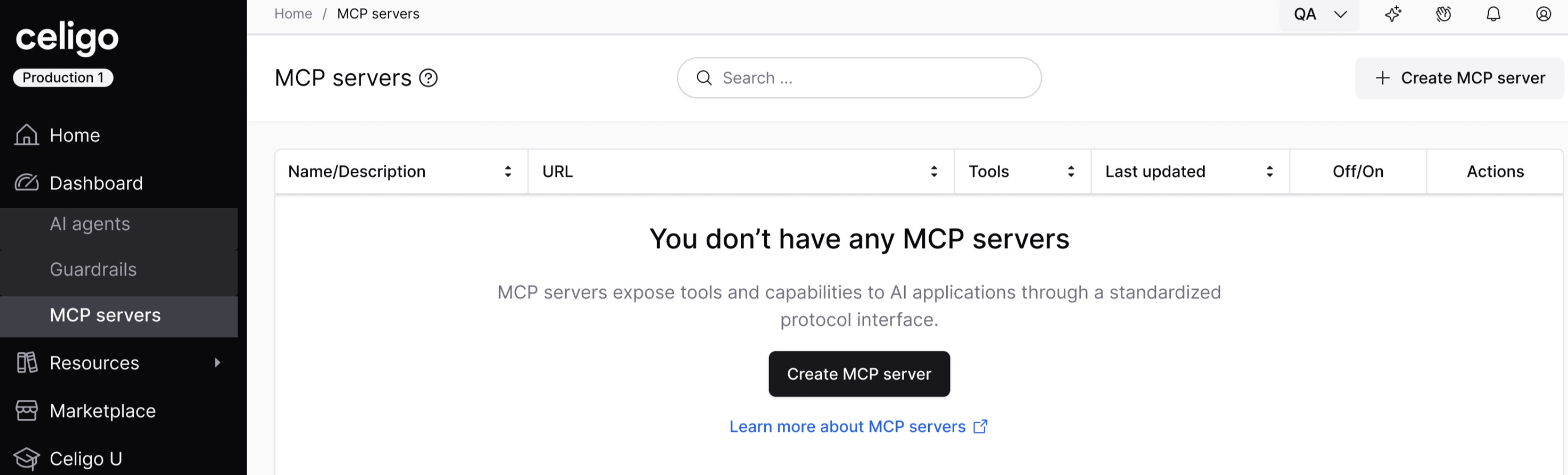

Navigate to MCP server
  1. To create your own MCP server, navigate to the Home → AI studio → MCP servers  → Create MCP servers.
    If you have previously created any server, click + Create MCP server in the upper right side of the page.

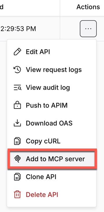

  3. You can add an existing API to an MCP server that can be published as an MCP tool directly from its corresponding API resource.
    Navigate to Resources → API → Actions (...) → Add to MCP server. Select Create new MCP under the Options field and click Add to MCP server.
