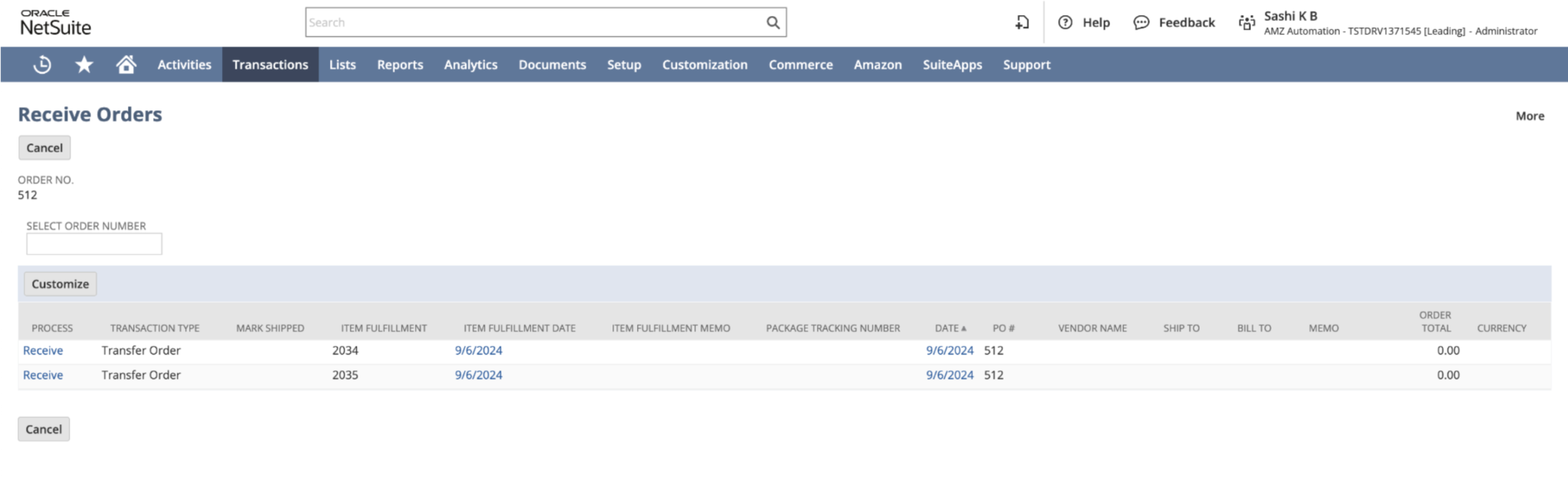

The flow initializes the Item Receipt transform directly from the Transfer Order record. When a single Transfer Order has multiple FBA shipments (and therefore multiple Item Fulfillments), NetSuite can't determine which specific Item Fulfillment's lines to mark as received. NetSuite rejects any attempt to modify the static sublist and throws SSS_INVALID_SUBLIST_OPERATION.
This is a NetSuite behavior requirement, not a Celigo product defect. In the NetSuite UI, when you select Receive on a Transfer Order that has multiple Item Fulfillments, NetSuite prompts you to select the specific Item Fulfillment to receive from. The flow must replicate this behavior by resolving the correct Item Fulfillment record and initializing the transform from it.

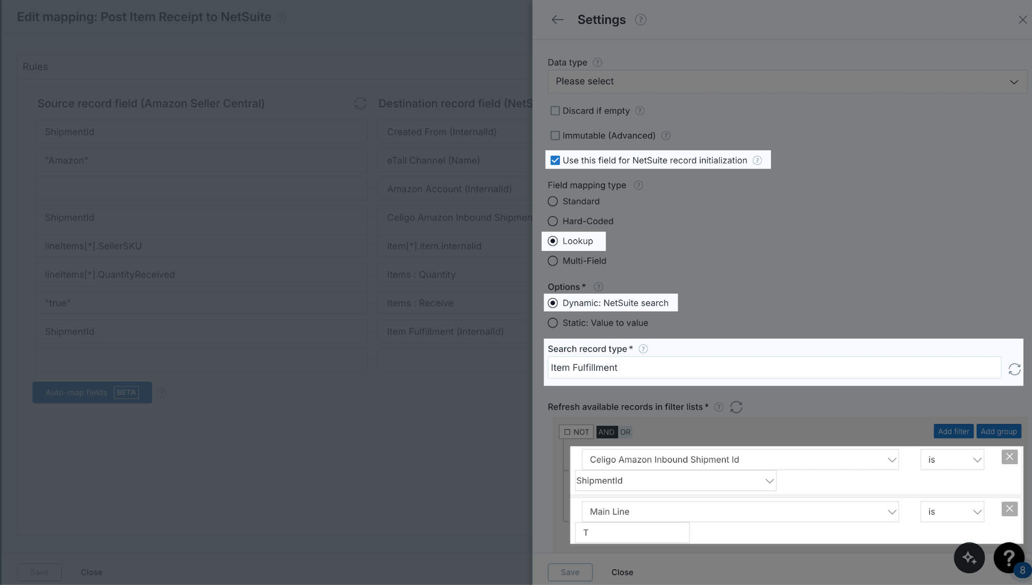

Add a lookup mapping on the Item Fulfillment (InternalId) field in the Item Receipt import and enable Use this field for NetSuite record initialization. This resolves the specific Item Fulfillment linked to the current FBA shipment ID and uses it to initialize the NetSuite transform.
Configure the Item Receipt mapping
  1. Open the Amazon Delivered Shipments to NetSuite Item Receipt flow.
  2. Select the Post Item Receipt to NetSuite import.
  3. Go to the Mapping tab.
  4. Locate or add the Item Fulfillment (InternalId) destination field.
  5. Open the field settings and set Field mapping type to Lookup.
  6. Under Options, select Dynamic: NetSuite search.
  7. Set Search record type to Item Fulfillment.
  8. Add the following filters:
    • Celigo Amazon Inbound Shipment Id is ShipmentId
    • Main Line is T
  1. Select Use this field for NetSuite record initialization.
  2. Set Result field to Internal Id.
  3. Set Name (lookup name) to something identifiable, for example itemFulfillmentLookup.
  4. Select Save.
  5. Retry the failed records from the flow's error page.
