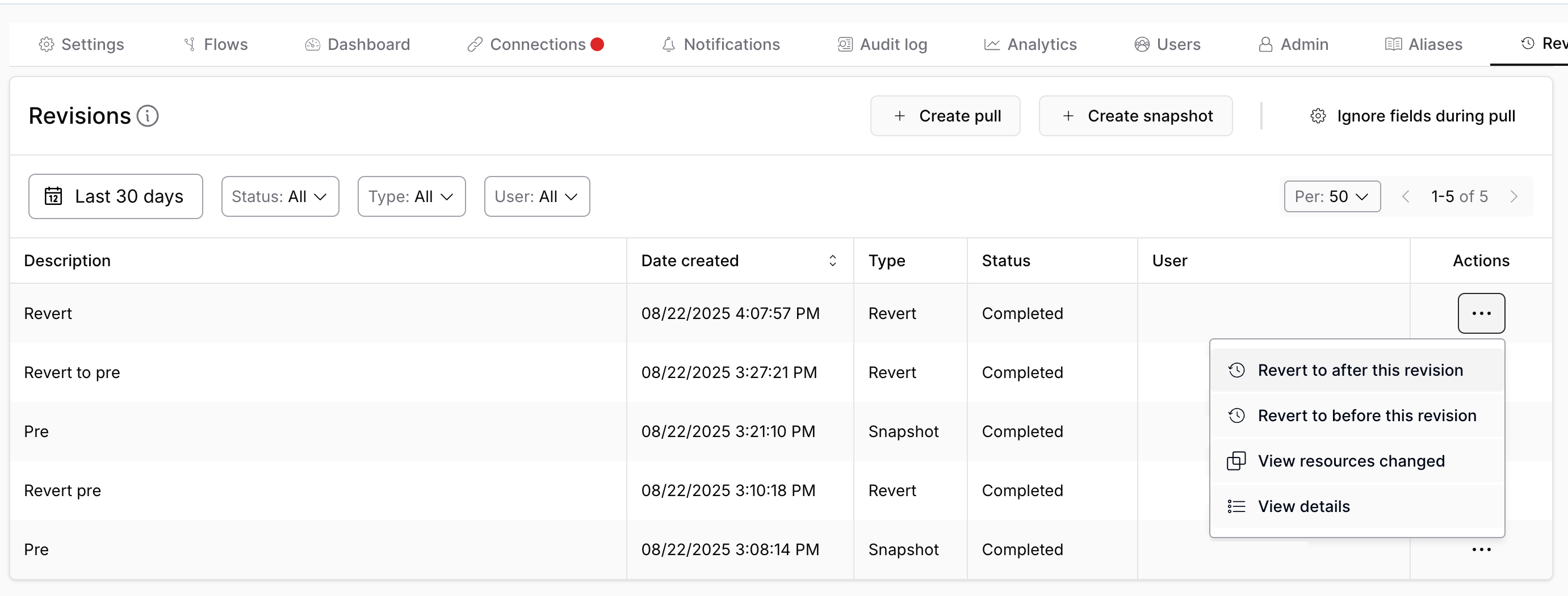

Revert to a snapshot
You can revert to a snapshot you’ve created if you’ve encountered an issue.
  1. On the Home page, click an integration to open it.
  2. On the integration page, click the Revisions tab.
  3. In the Revisions list, select the snapshot revision and click the Actions overflow (...) menu.
  4. In the dropdown list, select Revert to this revision.

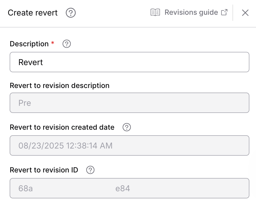

  5. Enter a description for the revert revision and click Next.

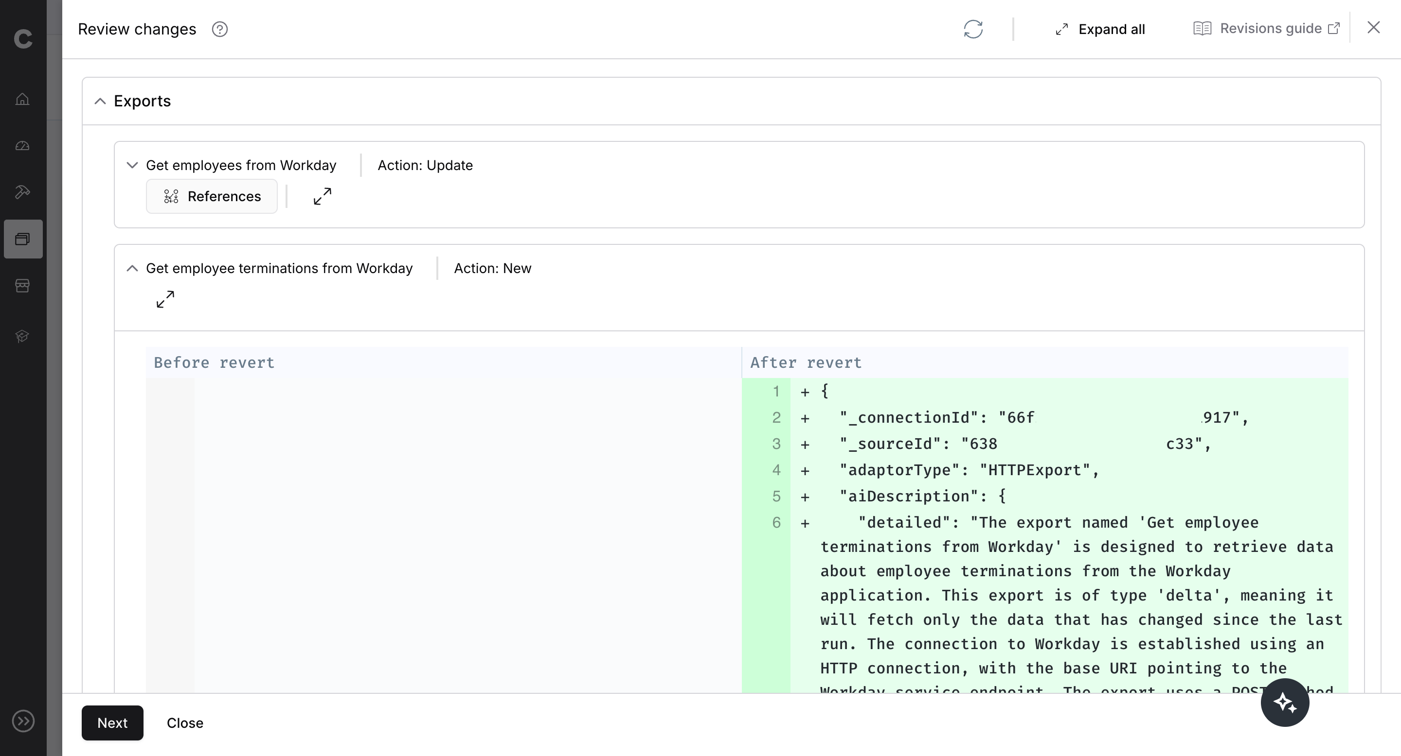

  6. Review changes and click Next.

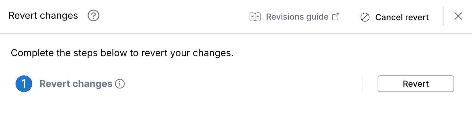

  7. In the Revert changes pane, click Revert. When the revert is completed, this revision is added to the Revision list.

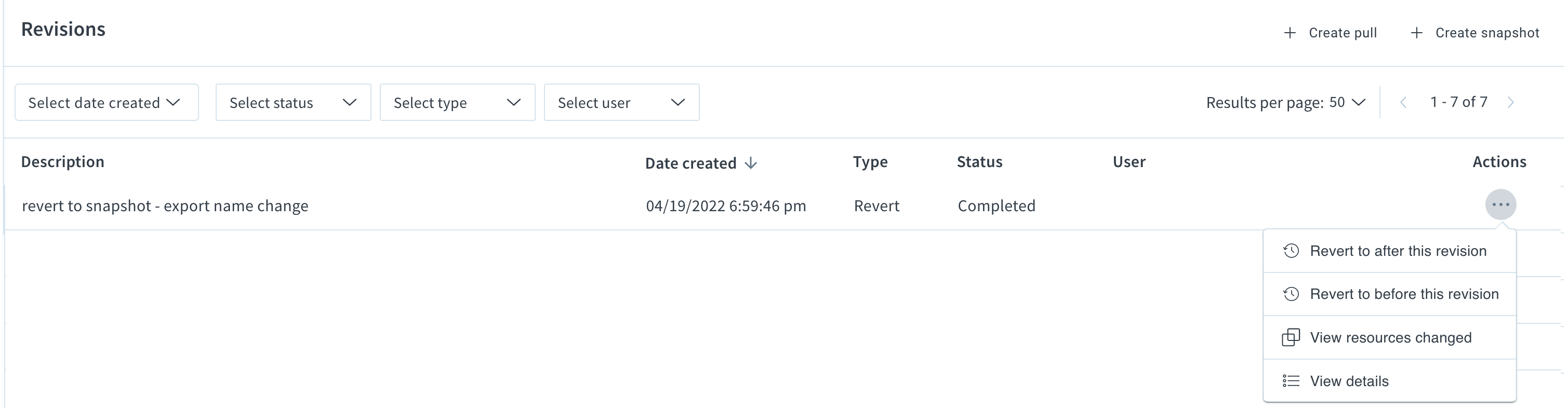

Revert to a pull or revert
  3. In the Revisions list, select either a pull or revert revision and click the Actions overflow (...) menu.
  4. In the drop-down list, choose one of the following options:
    • Revert to before this revision: Select this option to revert to an integration state before the pull or revert was made.
    • Revert to after this revision: Select this option to revert to an integration state after a pull or revert was made.
  5. Review changes and click Next to continue. Note that reverting your changes will never create conflicts.
  6. In the Revert changes pane, click Revert. When the revert is successfully completed, the revision is added to the Revision list.

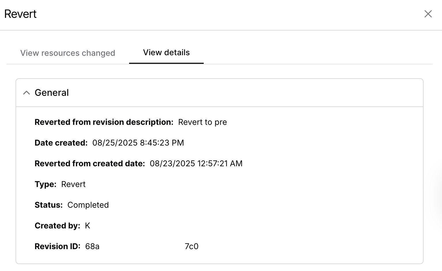

View details of a revert
You can view details of any revert listed in the revision history.
  3. In the Revisions list, select the revision and click the Actions overflow (...) menu.
  4. In the drop-down list, select View details.
  5. Review the details and click Close.

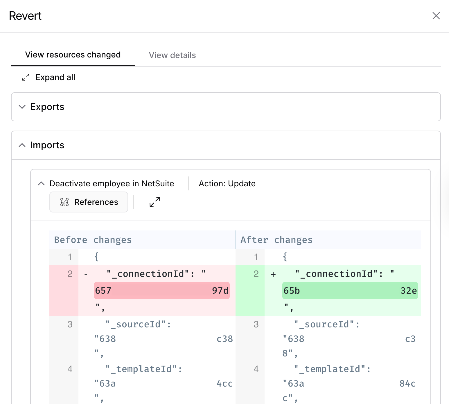

View resources changed in a revert
You can view the resources that have changed in a revert.
  3. In the Revisions list, select the revert revision and click the Actions overflow (...) menu.
  4. In the drop-down list, select View resources changed.
  5. Expand each section to review the modified resources and click Close.
