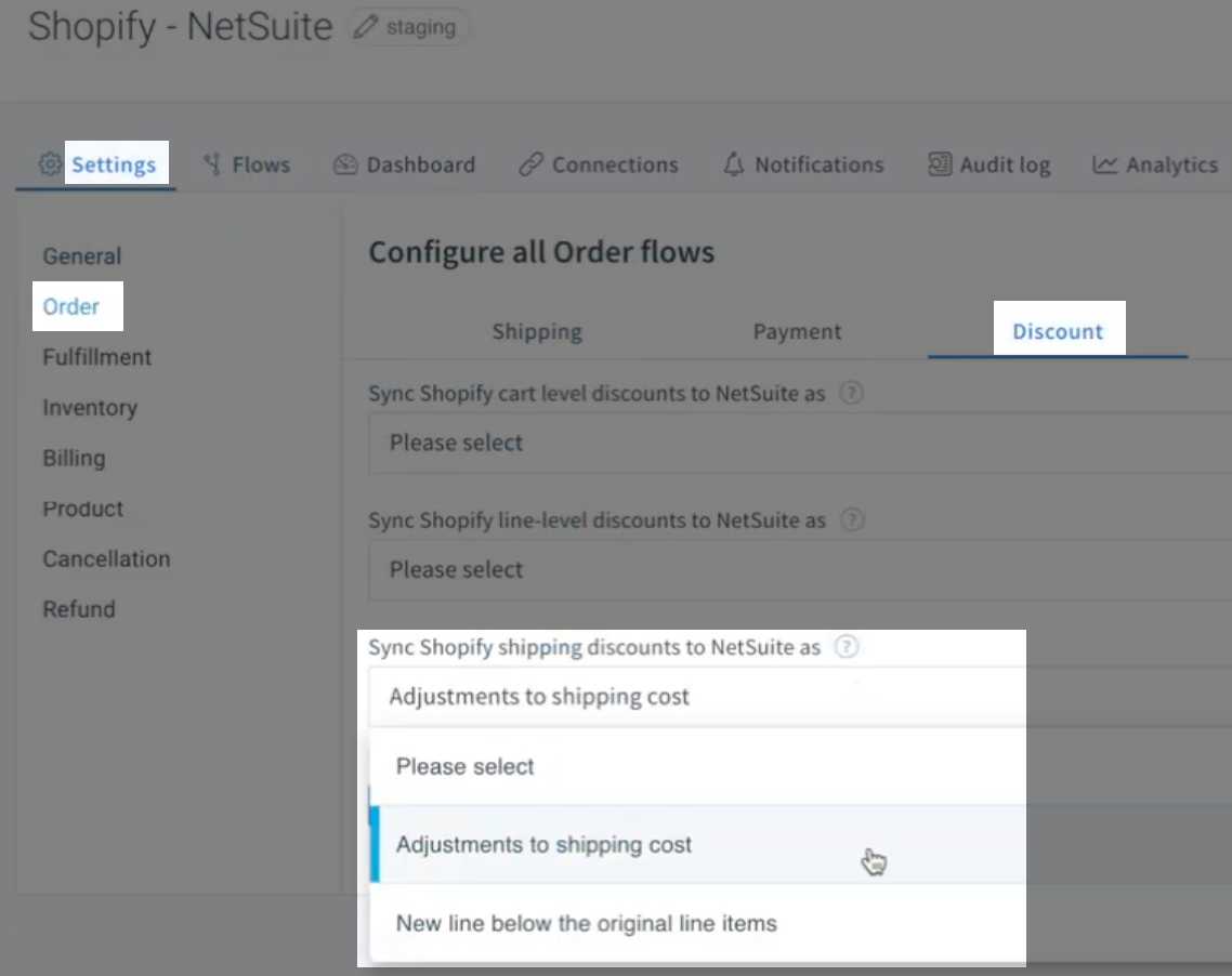

Sync Shopify shipping discounts to NetSuite as: Choose an option to sync shipping discounts from Shopify to NetSuite, depending on your business requirement. The following are the scenarios:
  • Adjustments to shipping cost: When you select this option, the integration app adjusts the shipping discount within the line item price, and the final price is displayed in NetSuite. For example, consider the item's original price was $100. A coupon code was used in Shopify to get $20 as a shipping discount. In this scenario, the integration app will update the price of the item as $80 in NetSuite.
  • New line below the original line items: Select this option to track the shipping discounts against a single item in NetSuite. The NetSuite discount item to track the Shopify shipping discounts field is displayed when you select this option. This field allows you to select the default NetSuite discount item against which all the shipping discounts are synced. The shipping discounts are reflected on the NetSuite sales transactions as a separate line item, below the original line items.
    Important: To sync shipping discounts against a single item in NetSuite, ensure that you select an item in the NetSuite item to track Shopify shipping cost as a line item available on the Settings > Order > Order tab.

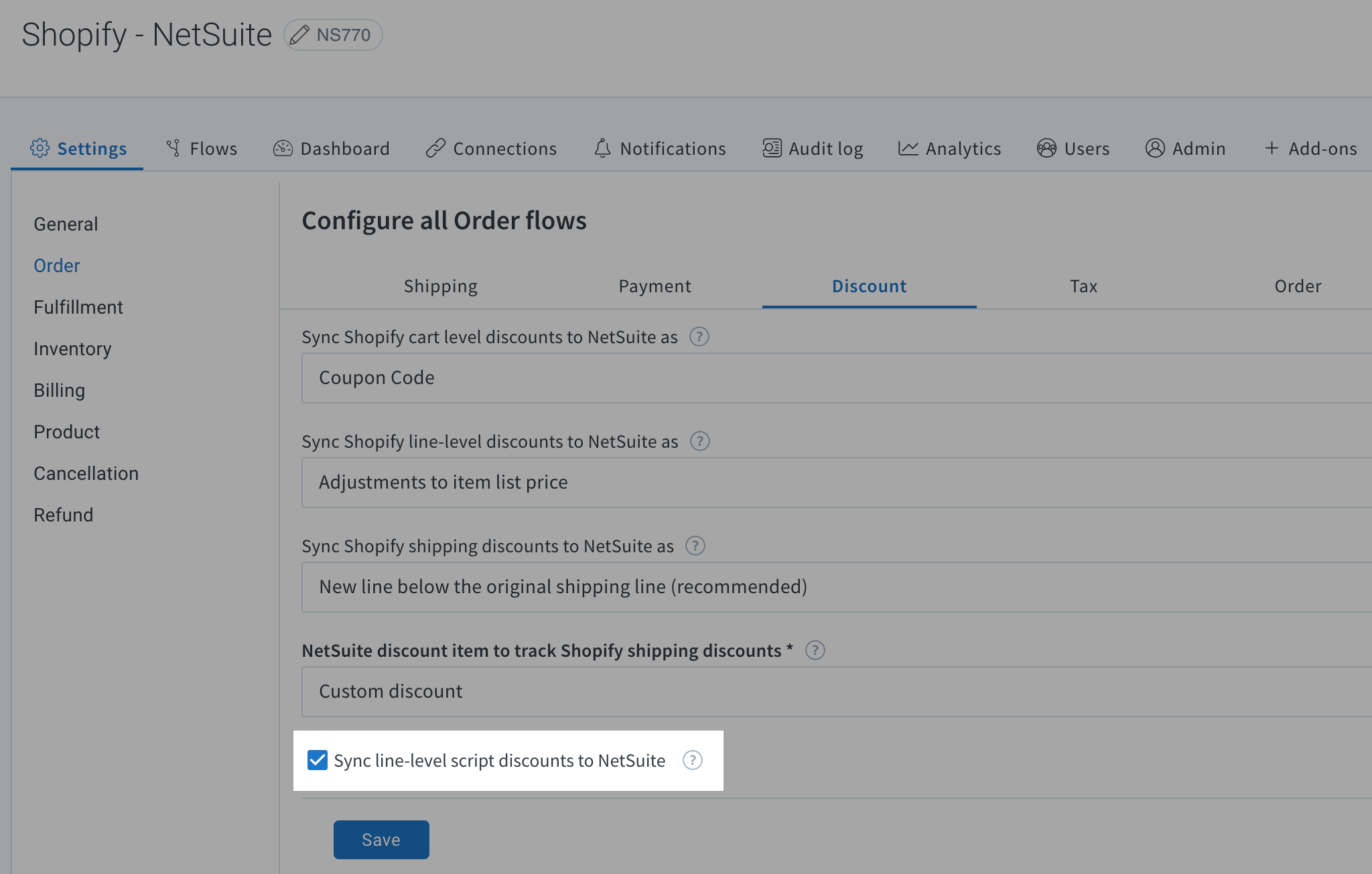

Sync line-level script discounts to NetSuite: Check this box to sync multiple discounts from Shopify to NetSuite, when line-level script discounts are combined with other line-level discounts.

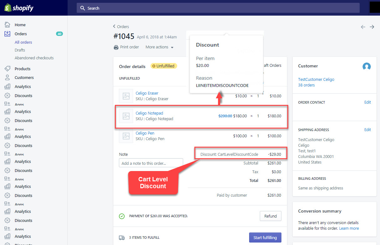

To demonstrate the functionality, let’s consider the following order from Shopify:
This order consists of 3 items:
  • Celigo Eraser: $10
  • Celigo Notepad: $200 – $20 (Line item discount) = $180
  • Celigo Pen: $100
Total order cost: $290
Cart level discount: 10%  of total order cost = $29
Let’s see what happens when this order is imported in NetSuite.

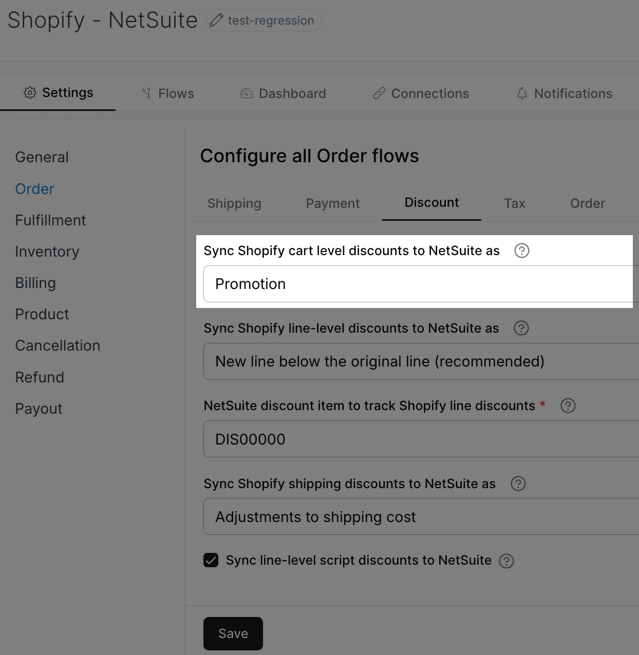

The following screens demonstrate how the discount associated with an order is imported into NetSuite when you select:
  • the Promotion option for the Sync Shopify cart level discounts into NetSuite as drop-down list
  • the New line below the original line (recommended) option for the Sync Shopify line level discounts into NetSuite as drop-down list
The Discount tab under Settings > Order section:

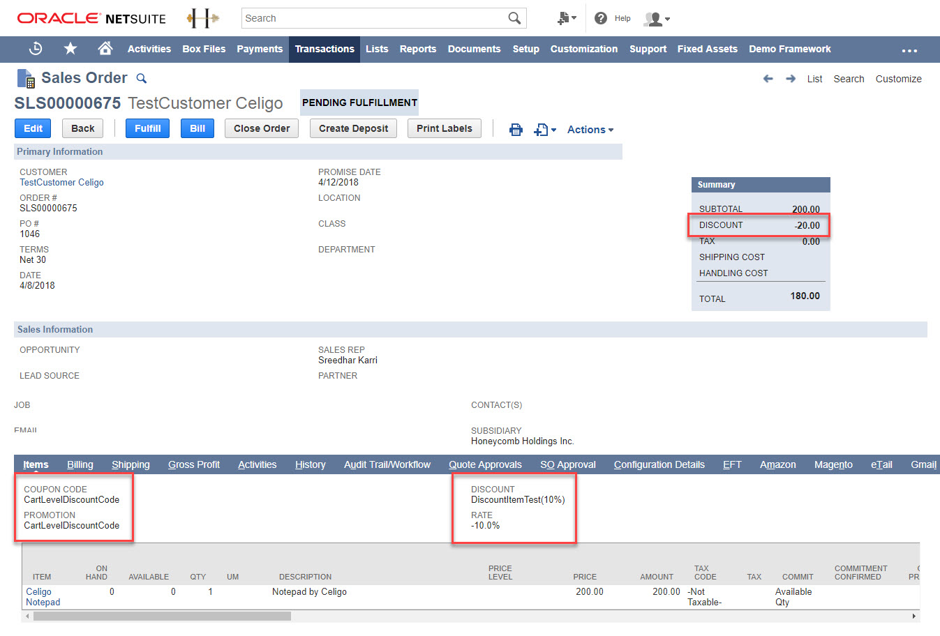

Order in NetSuite:

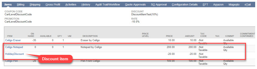

You can see that the cart level discount of $29 is being displayed in the Summary pane. Also the coupon/promotion code “CartLevelDiscountCode” is being displayed that was used to avail the discount of $29.
In the Shopify order, $20 line item discount was applied for the item Celigo Notepad and in the intgeration app, the New line below the original line (recommended) option was selected with the NetSuite discount item to track Shopify line discounts field set as HolidayDiscount. Hence, in NetSuite, you can see that a line with HolidayDiscount as the item is showing up below the CeligoNotepad with the price of $-20.

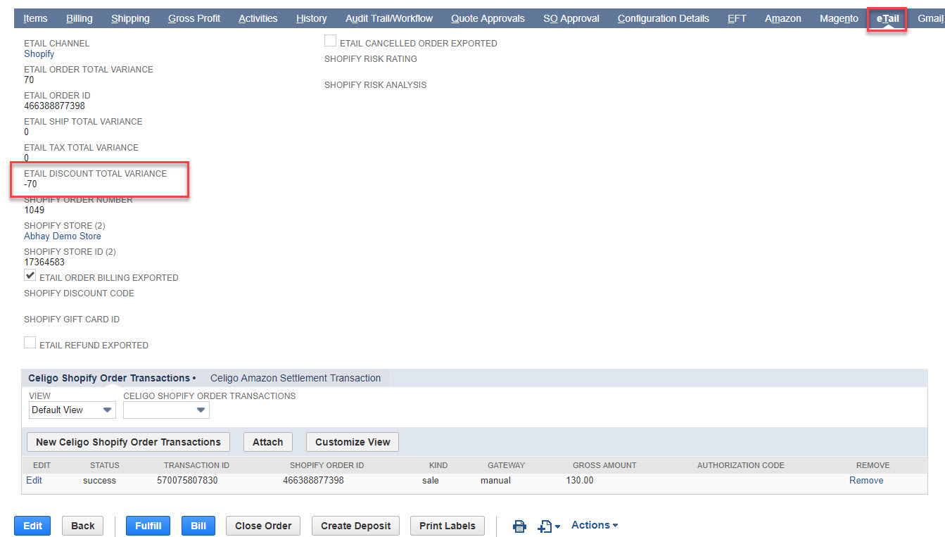

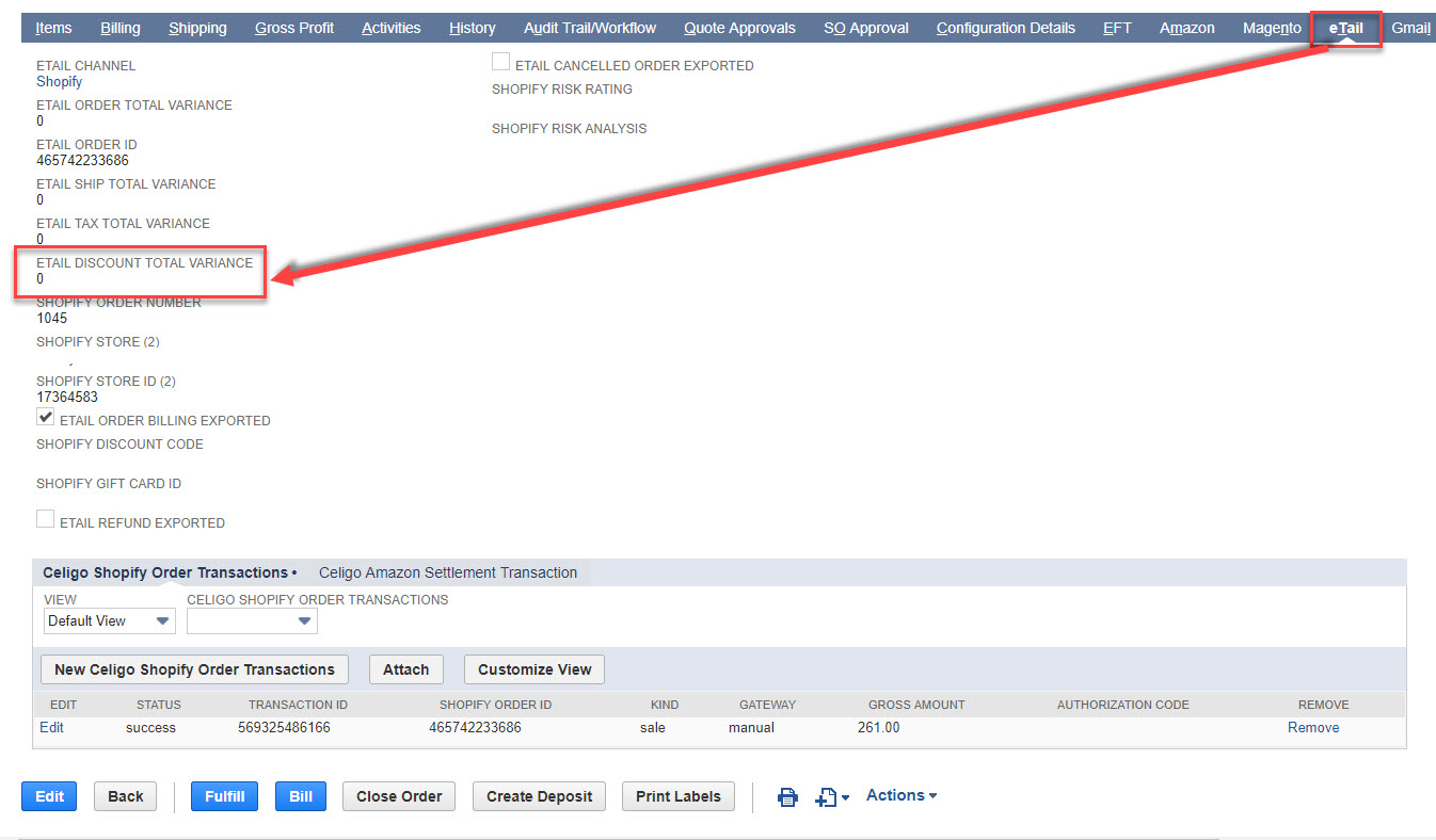

Since the entire discount amount in Shopify matches with the order in NetSuite, you can see that the eTail tab > ETAIL DISCOUNT TOTAL VARIANCE field (used for capturing the difference in the discount total between Shopify and NetSuite) shows 0.

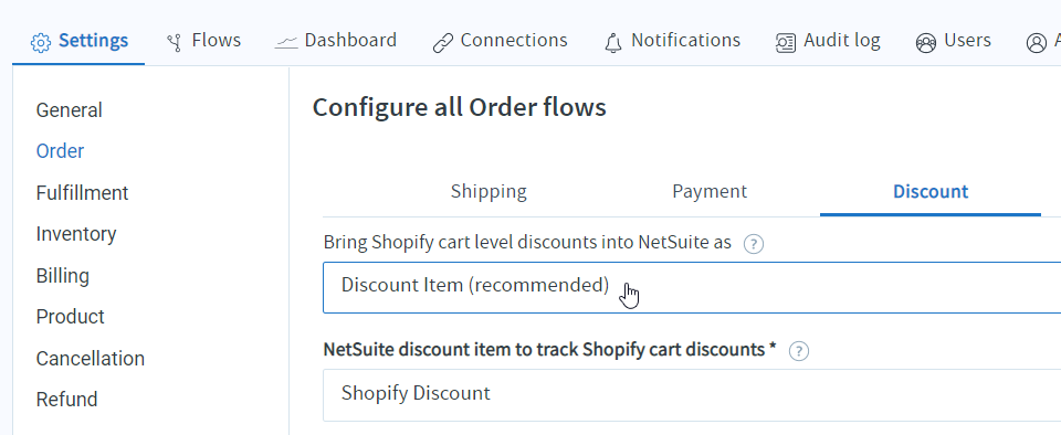

Scenario 2: Impacts of using Discount Item
When you use the Discount Item (Recommended) option, the integration app searches for the same discount item in NetSuite and displays the Shopify discount total at the cart level in NetSuite.
Note: When using the default discount item, the integration app uses the same discount item, but updates the rate as per cart level discount when the order is imported into NetSuite.
  • the Discount Item (Recommended) option for the Sync Shopify cart level discounts into NetSuite as a drop-down list
  • the Adjustments to item list price option for the Sync Shopify line-level discounts to NetSuite as a drop-down list

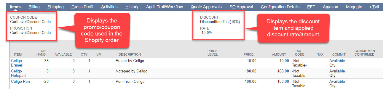

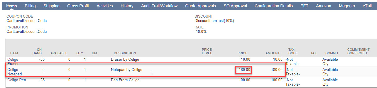

You can see that the cart level discount of $29 is being displayed in the Summary pane. Also, the Discount field is displaying the discount item as “DiscountItemTest”, which is same as the discount item selected in the integration app in the NetSuite discount item to track Shopify cart discounts field.
In the Shopify order, $20 line item discount was applied to the item Celigo Notepad and in the integration app, the Adjustments to item list price option was selected. Hence, in NetSuite, you can see that the line item “Celigo Notepad” is displaying the adjusted price of $180 instead of the original price of $200.

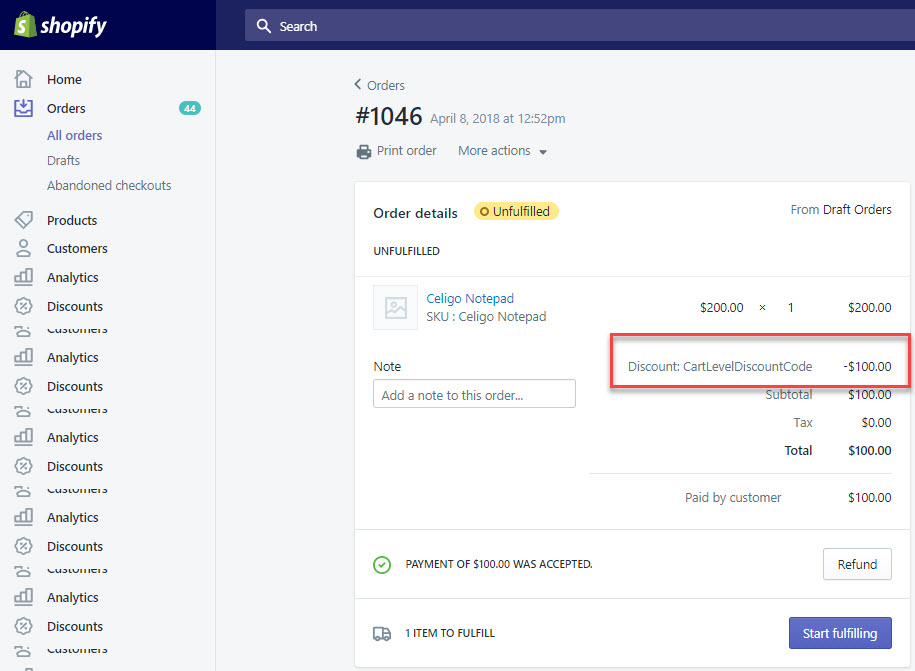

Q1: What happens when the rate/amount associated with the promotion/coupon code differs in NetSuite and Shopify?
A: When you use the discount item option for the Sync Shopify cart level discounts into NetSuite as field, the integration app uses the discount item you specify in the NetSuite discount item to track the Shopify cart discounts field, but updates the rate/amount as per cart level discount applied in Shopify when the order is imported into NetSuite.
When you use the Promotion or Coupon code option for the Sync Shopify cart level discounts into NetSuite as field, the integration app does not override the coupon code of Shopify with the coupon code rate in NetSuite. The integration app simply identifies the same coupon or promotion code in NetSuite and applies the rate/amount associated with the promotion/coupon code in NetSuite. Hence, we recommend you only to use this option if you maintain a 1:1 match between the promo codes in NetSuite and Shopify and the discount amounts match exactly between the two systems. This situation results in the variance being recorded in case if there is a difference in the discount offered on Shopify and NetSuite using a coupon code or promo code.
The following example demonstrates the impact when the same Shopify and NetSuite order has a different amount/ rate as a discount.
Shopify order
In this order, you can see that the promotion/coupon code CartLevelDiscountCode is used to receive a discount of $100.
When the integration app imports this order in NetSuite, it will match CartLevelDiscountCode with a similar record in NetSuite. The discount associated with CartLevelDiscountCode in NetSuite is 10% of total order value.  So, the integration app will only apply the $20 discount (10% of $200) on order in NetSuite.
The actual discount associated with CartLevelDiscountCode in NetSuite is $100 and as only $20 has been used, the integration app reflects the remaining amount of $80 in the eTail tab > ETAIL DISCOUNT TOTAL VARIANCE field.

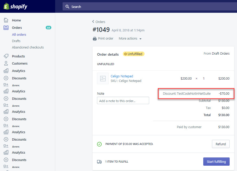

Q2: What happens when the coupon code applied in Shopify does not exist in NetSuite?

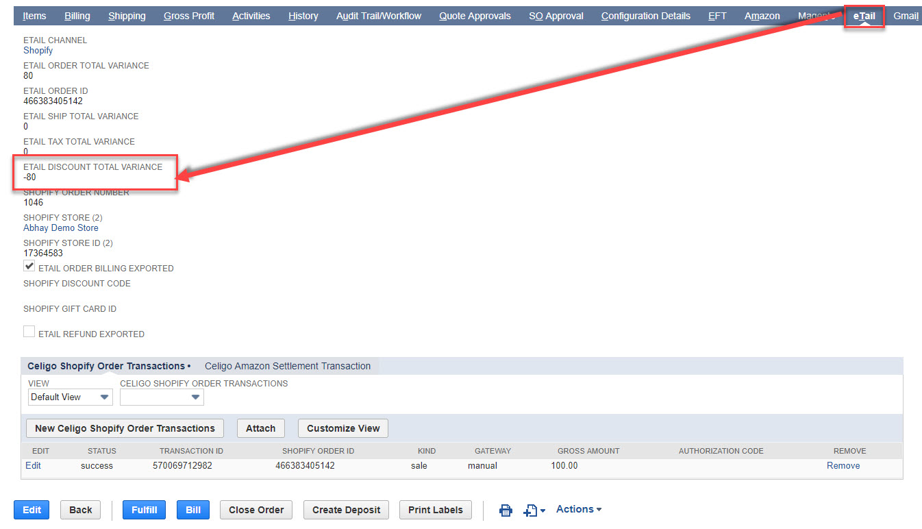

A: Another issue when you use the Promotion or Coupon code option for the Sync Shopify cart level discounts into NetSuite as field is the discount variance in order when the promotion/coupon code applied in Shopify does not match with the promotion/coupon code in NetSuite. In this case, no coupon code is applied against the order imported in NetSuite and the total discount amount will directly be added to the eTail tab > ETAIL DISCOUNT TOTAL VARIANCE field.
The following example demonstrates the impact when the promotion/coupon code used in  Shopify does not exist in NetSuite.

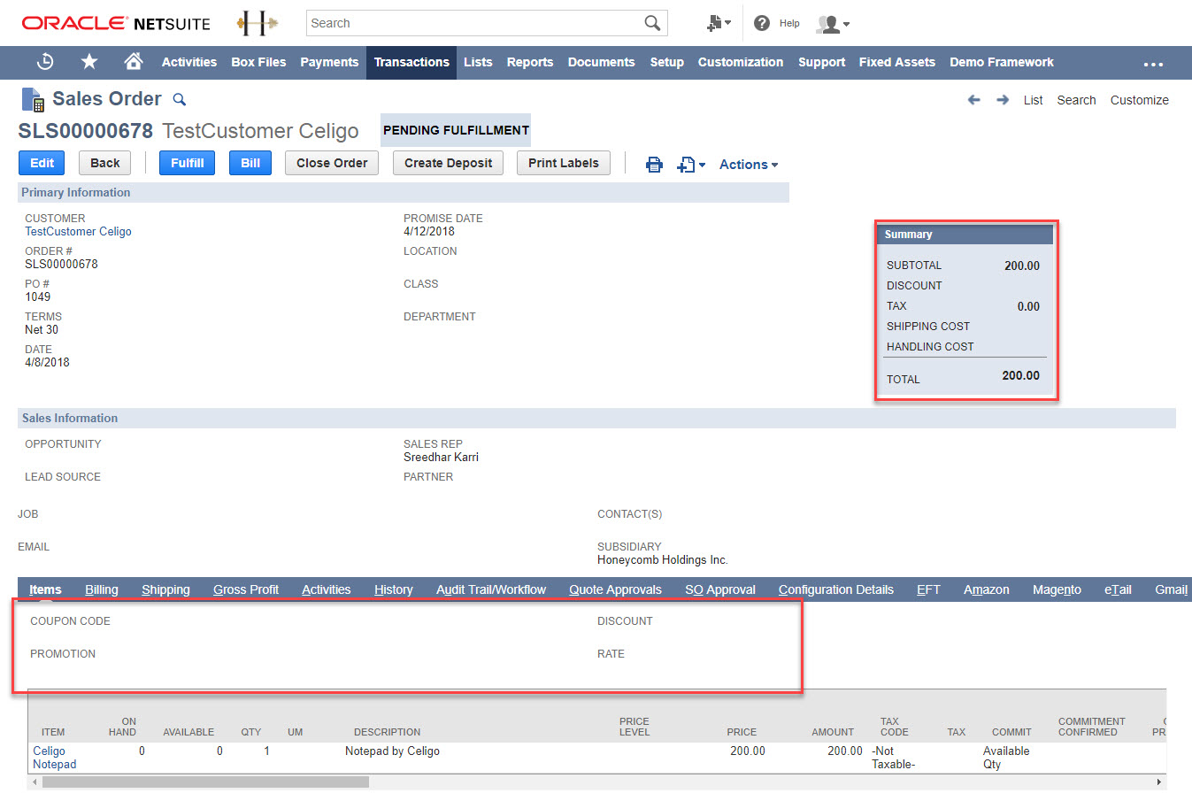

Shopify order
In the above order, promotion/coupon code TestCodeNotInNetSuite is used to avail a discount of $70. This is the code that is not present in NetSuite.
When the integration app processed this order, the following image demonstrates the results:
No discount gets applied to the order. The integration app does not even applies the promotion/coupon code applied in Shopify to the order imported in NetSuite. Hence the entire discount amount of $70 is updated in the eTail tab > ETAIL DISCOUNT TOTAL VARIANCE field.
