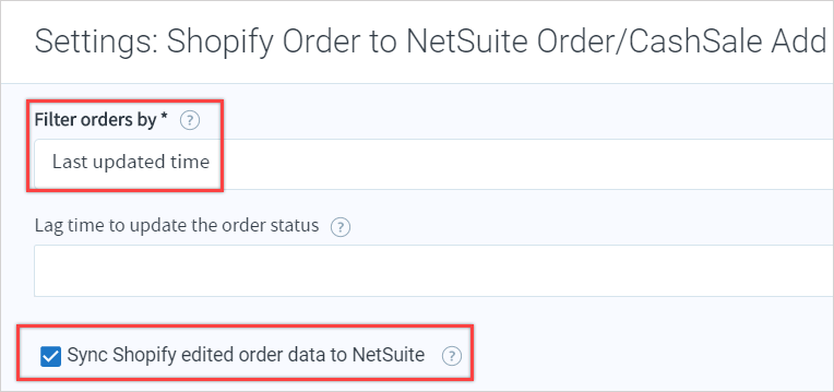

Prerequisite: In the line of Shopify order to NetSuite order (cash sale or sales order), click Configure Settings:
  • In the Filter orders by* setting, select Last updated time.
  • Check the Sync Shopify edited order data to NetSuite box.

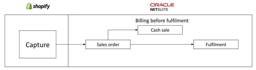

When you sync the Shopify order in the Captured payment status and if the billing happens before fulfillment:
  • For positive adjustments:
    • The sales order is updated with the order edit adjustments.
    • Note: Update the cash sale record manually.
  • For negative adjustments:
    • The cash sale is not updated.
    • In this scenario, as the order is already billed, two refund records are created:
      • An auto-generated cash refund record with a $0 amount is created for restocking the inventory.
      • Another cash refund record is created with the actual refund amount for the negative adjustments made to the order.

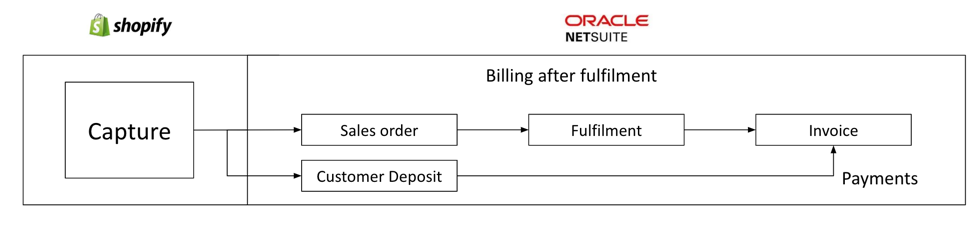

 Scenario 2
When you sync a Shopify order with Capture status and billing is after fulfillment:
    • An additional customer deposit record is created for the positive adjustments made to the order.
    • In this scenario, as the order is adjusted before billing, restocking the inventory is not required. Only one customer refund record is created for the refunded amount.

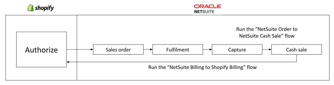

Scenario 3
When you sync the Shopify order in the Authorize payment status:
  • The sales order is updated with the order edit adjustments for positive adjustments.
    • As the order is not billed and the payment is not captured, refund records are not created in this scenario. Also, the $0 refund record that is used to restock the inventory should be ignored. To achieve this, it is recommended to add the below mapping in the “Shopify Refund to NetSuite Refund Add” flow for the “NetSuite Refund Order Import Adaptor”, below the “Import Mappings”. If the mapping is set to “true”, the flow ignores to create the $0 refund record.

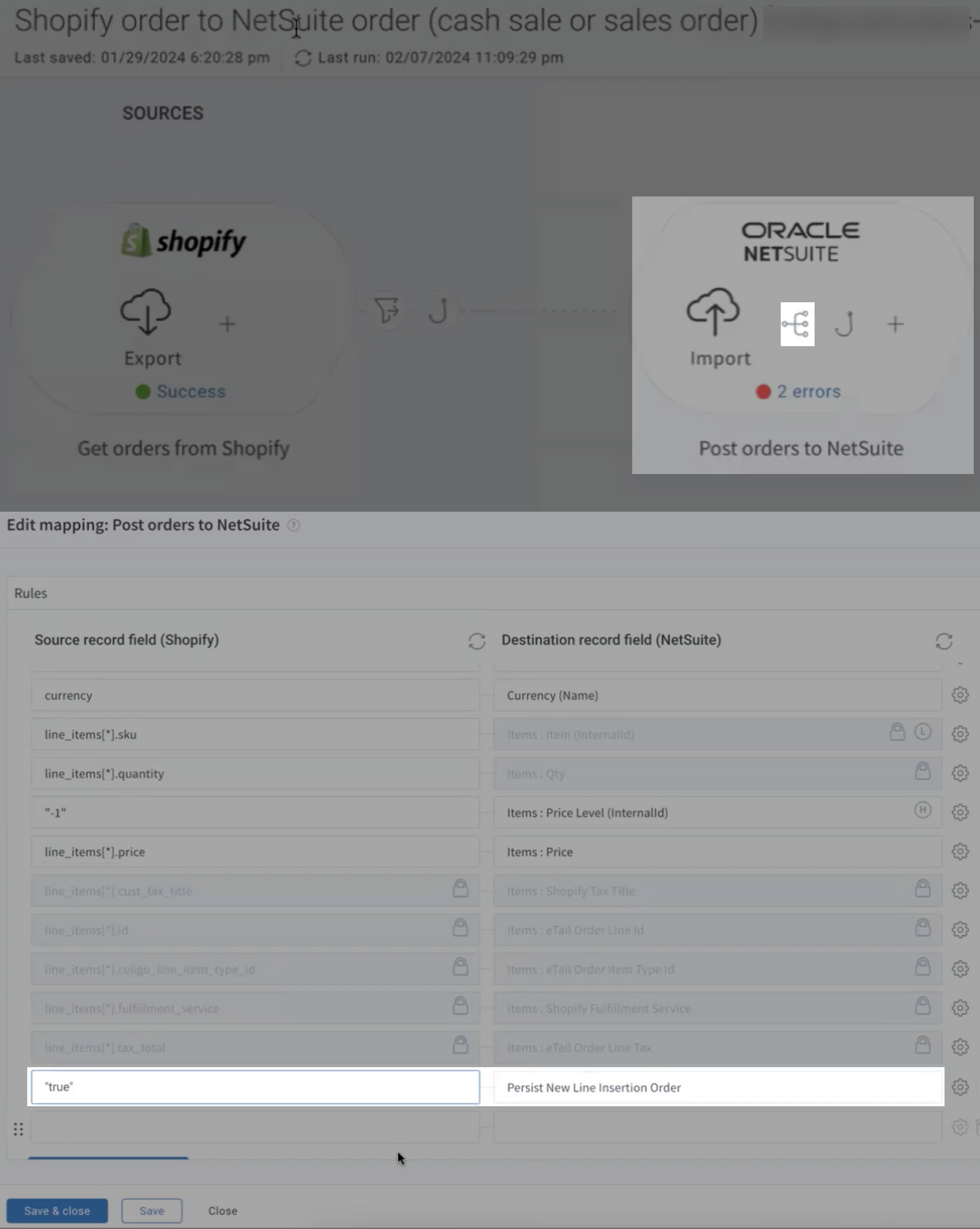

Discount lines appear in the wrong order
Symptom
After synchronizing an edited Shopify order that adds a new item to an order containing discounted items, the line sequence in NetSuite is incorrect. Discount lines may appear out of order or no longer align with their associated items.
Cause
The Persist New Line Insertion Order field mapping is either:
  • Missing, or
  • Set to false.
Resolution
  1. Open the Post Orders to NetSuite flow.
  2. Add or edit the Persist New Line Insertion Order field mapping.
  3. Click Settings.
  4. Set Field Type to Boolean.
  5. Select True from the value list.
  6. Save the mapping.
  7. Re-run the order synchronization.
Edited Shopify orders don't synchronize
Symptom
The Sync Shopify edited order data to NetSuite setting is enabled, but updates made to Shopify orders never appear in NetSuite.
Cause
You're using the real-time Shopify order flow.
The real-time flow processes an order only when it is created. It doesn't process subsequent edits.
Resolution
Use the scheduled Shopify Order to NetSuite Order/Cash Sale Add flow to synchronize edited orders.
