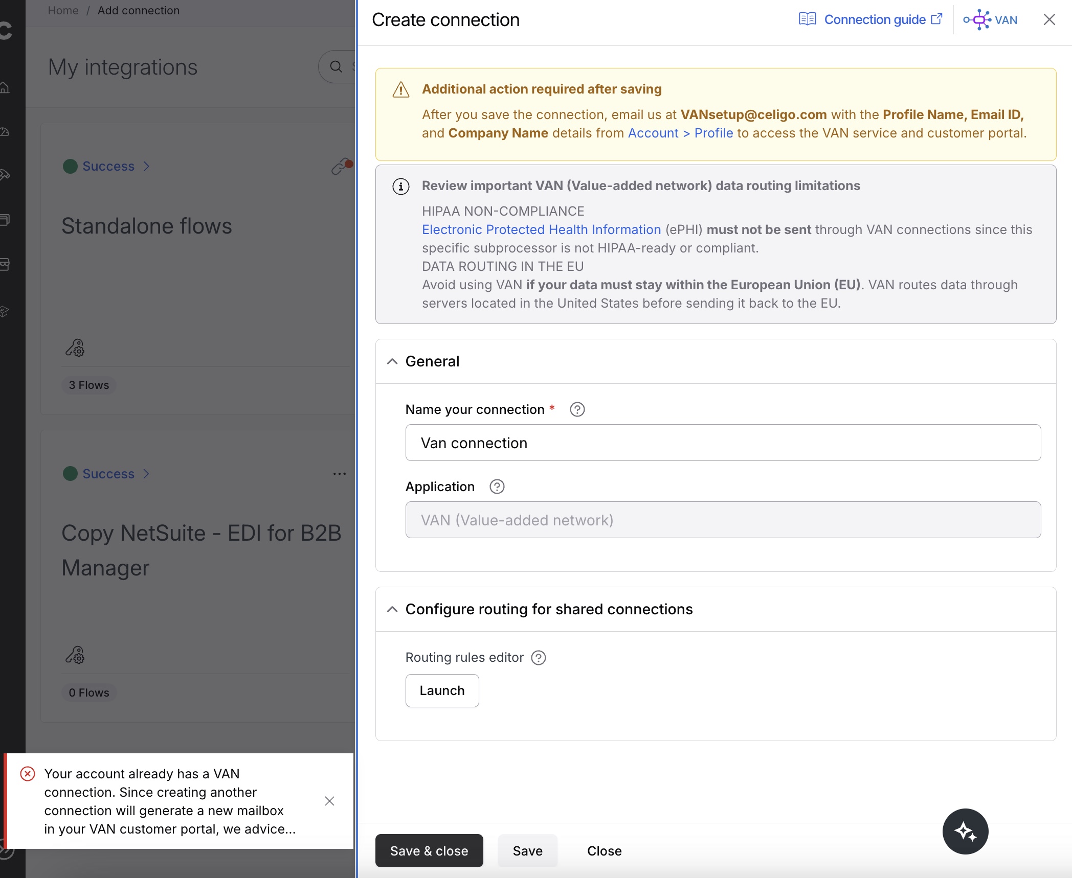

Request access and set up a connection to the Value-added network (VAN) connector
  • You can configure only one VAN connection per environment. If you try to create and save more than one VAN connection in an environment, an error message is displayed.
  • When you create a VAN connection in an environment, an ECGrid mailbox is created and associated with only that environment. You cannot create a VAN connection in one environment and use it in another environment. For example, if you have a production and sandbox environment, and you have created a VAN connection in the sandbox environment, then you cannot use the sandbox connection in the production environment. You must create another connection like the sandbox one for the production environment. The setup is the same for both as explained in the sections below.

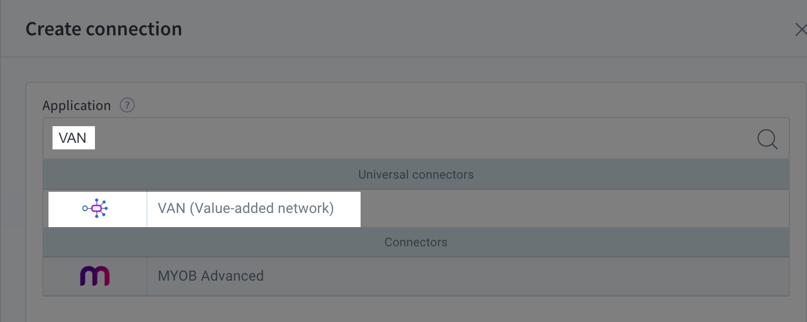

  3. In the Application field, enter VAN.
  4. From the Universal connectors list, select VAN (Value-added Network).

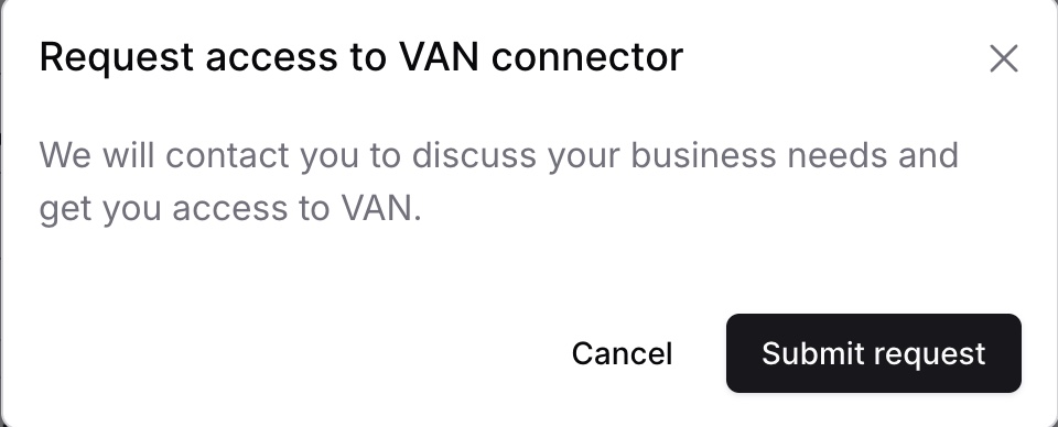

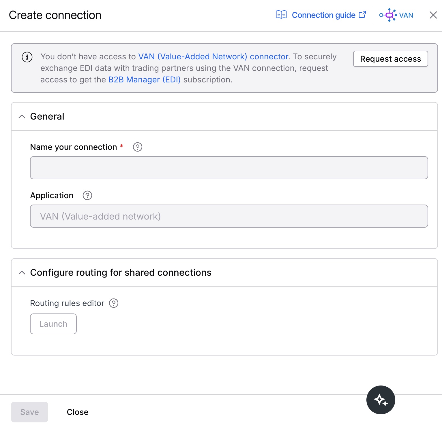

  5. By default, all fields are disabled on the Create connection page. To create a connection to the VAN connector, click Request access.
  6. On the Request access to VAN connector pane, click Submit request. The Celigo team will receive an email to initiate the request.
    Once your request is validated, you can set up your VAN connection and request access to ECGrid in parallel.

  1. In the upper right of the page, select the environment you want to create the VAN connection if you have a non-production or sandbox environment.
  2. From the left menu, navigate to Resources > Connections. Then, click + Create connection at the top right.
  3. In the Application field, enter VAN; in the resulting application list, select VAN (Value-added network).

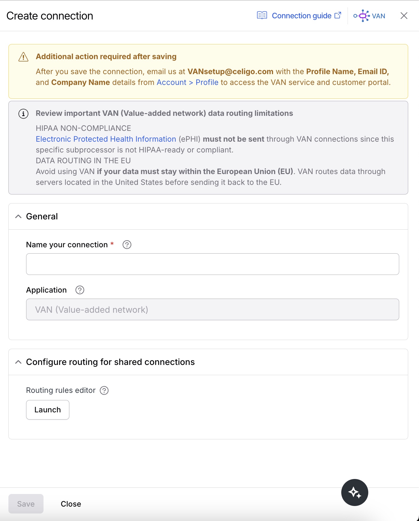

  4. The Create connection pane opens with the required settings.
  • General:
    • Name your connection (required): Provide a clear and distinguishable name. Throughout integrator.io imports and exports, you will have the option to choose this new connection, and a unique identifier will prove helpful later when selecting among a list of connections that you’ve created.
    • Application (required, non-editable): A reminder of the app you’re editing.
  • Configure routing for shared connections:
    • Routing rules editor: Define the rules that integrator.io will use to send messages from your trading partners to the right flow. Script-based routing rules determine the way inbound files received are sent to the correct flows. Click Launch. For more information, refer to the Understand the content-based routing (CBR) rules section in Understand content-based routing for AS2 connections.
  • Once you have configured the connection, you have a few options for continuing:
    • Save: Click to test the connection, and commit the new connection so that it will be available to all integrations for your account
    • Save & close: Click to test and save the connection and exit the Create connection pane
    • Close: Click to exit the window

After creating a VAN connection, email the integrator.io account owner details (Profile Name, Email ID, Company Name) to VANsetup@celigo.com to request access to the VAN (Value-Added Network) service portal (ECGrid). To get these details, go to Account > Profile. For more info, see Manage your profile. You will receive an invitation link with the ECGrid access details within 1-2 business days.
A separate ECGrid mailbox should be set up for each environment.

This is an optional step if you wish to delete your connection. Before adding another VAN connection, you must remove the existing VAN connection, which requires deleting the import, export, and flows that reference the VAN connection.
In the future, if you wish to delete your existing VAN connection:
  2. If you have
  3. From the left menu, go to Resources > Connections.
  4. On the Connections page, search for the VAN connection.
  5. In the Actions column, click Actions.jpg to expand.
  6. From the options, select Delete connection.
After you delete the existing VAN connection, you can create another VAN connection.
