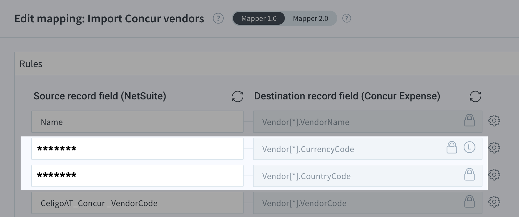

A. New field mappings
According to the SAP Concur Invoice changes, Celigo has updated the relative URL of the Vendor API and made CountryCode and CurrencyCode fields mandatory to the POST operations. Hence, verify all the POST mappings in your existing flows and update these fields respectively.

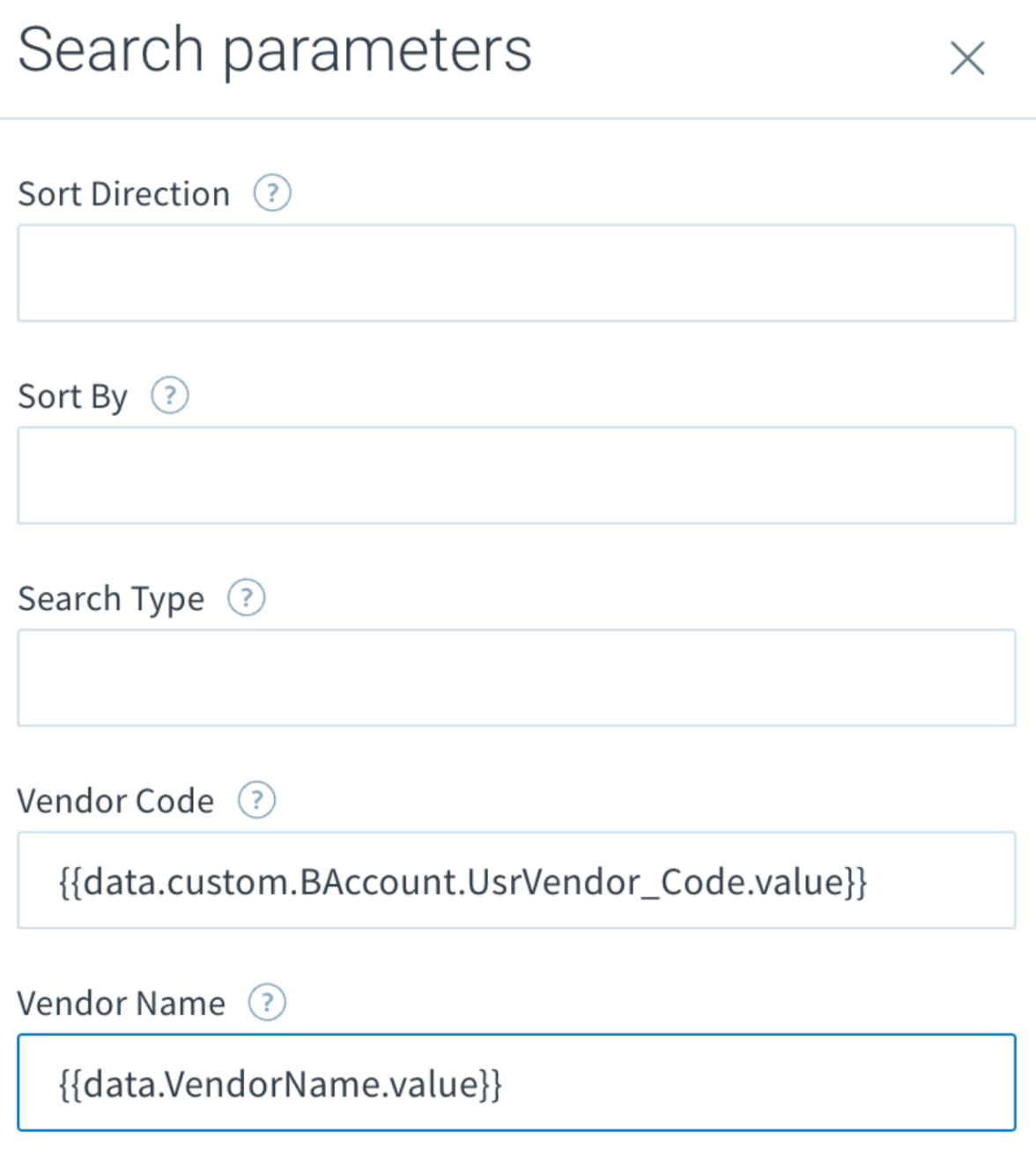

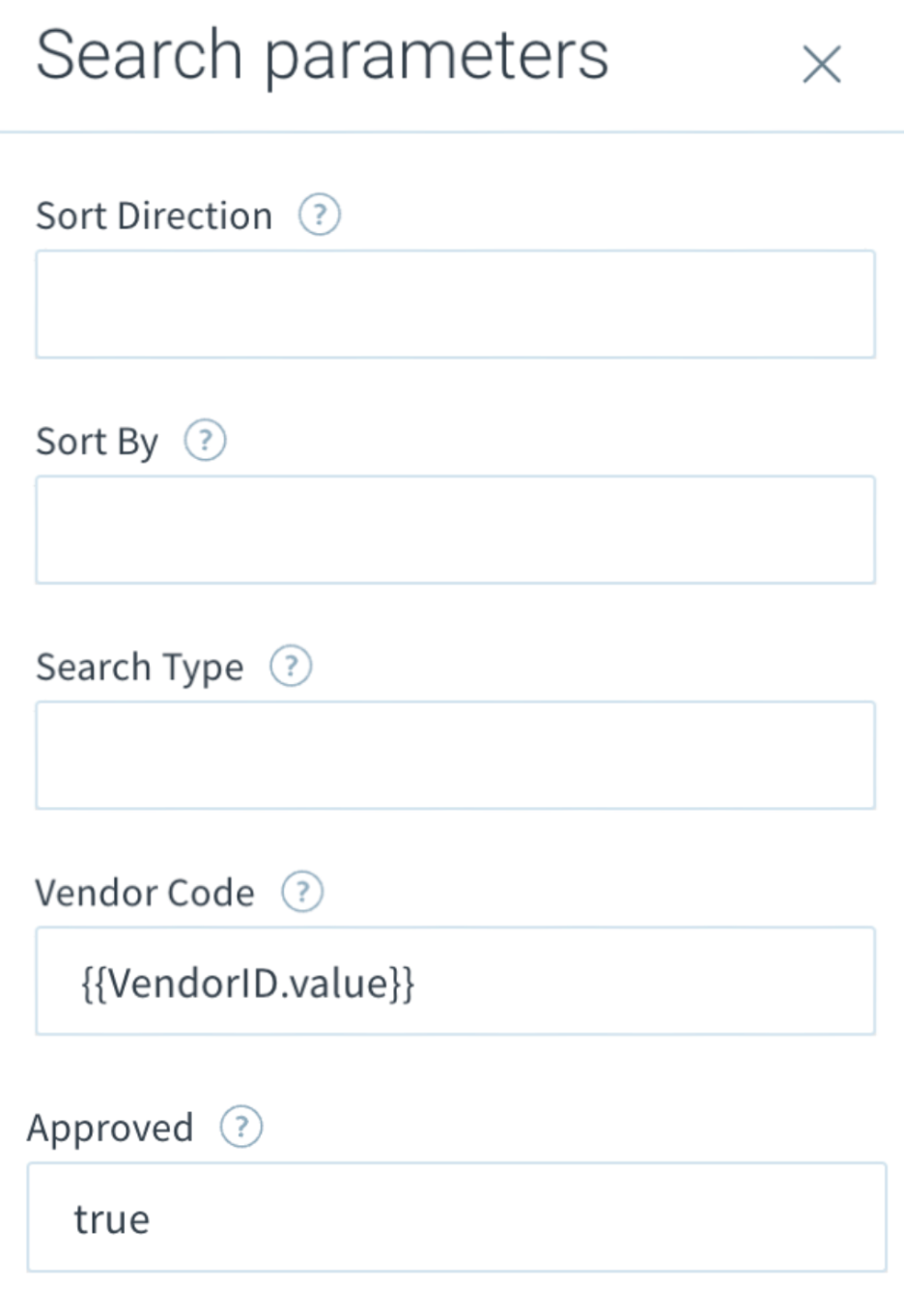

B. Find the endpoint in the existing flows
To find an export that uses an SAP Concur Invoice connection:
- Sign in to your integrator.io account.
- Navigate to Resources > Connections.
- Search for an existing Concur Invoice connection. From the Actions overflow ... menu, select Used by. A list of all items that use this connection appears.
- Right-click the first flow step in the list and select your browser’s option to open it in a new tab.
- Replace the configuration for the deprecated endpoints with the endpoints provided in the table above.

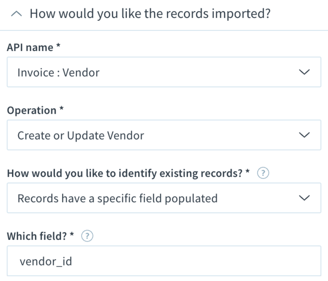

C. Update flows to use replacement endpoint
For each export and import that is using a deprecated API name and operation, find its corresponding replacement API name and operation in the chart below, and select the new API name and operation.
Deprecated |
Replacement |
API name |
Operation |
API name |
Operation |
Invoice: Vendor (Export) | Retrieve an existing vendor | Invoice: Vendor (Export) | Retrieve an existing vendor |
Invoice: Vendor (Import) | Create Vendors | Invoice: Vendor (Import) | Create Vendors |
Invoice: Vendor (Import) | Create or Update Vendor | Invoice: Vendor (Import) | Create or Update Vendor |
Invoice: Vendor (Import) | Update Existing Vendors | Invoice: Vendor (Import) | Update Existing Vendors |
Invoice: Vendor (Import) | Delete Vendor | Invoice: Vendor (Import) | Delete Vendor |
