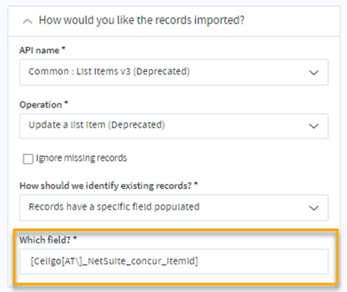

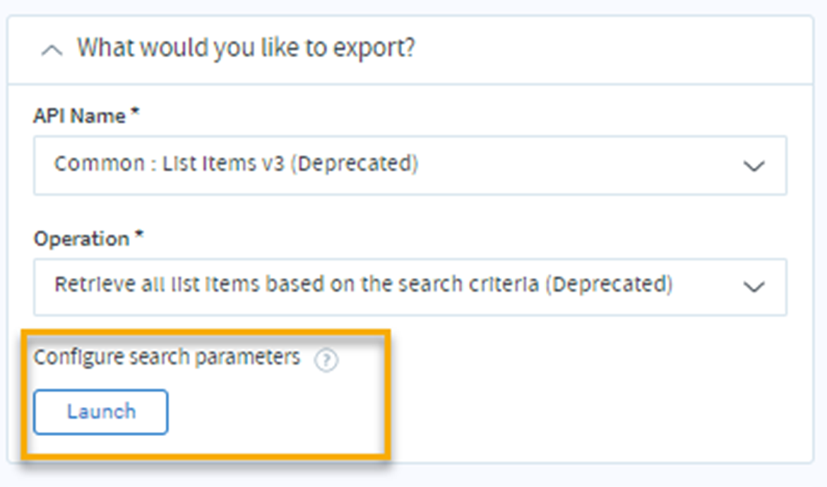

For example, if the existing export is configured as follows:
  • API name: Common : Lists v3 (Deprecated)
  • Operation: Gets a single list by ID

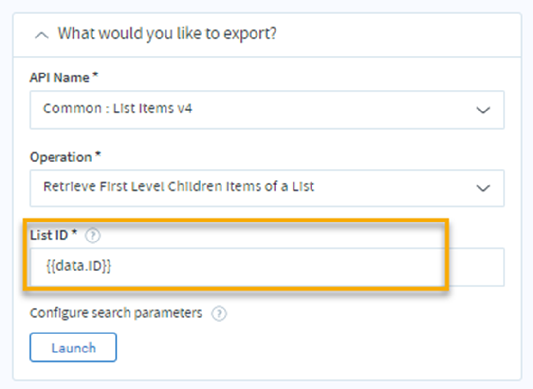

Then, convert it according to the table, as follows, and as shown in the images below:
  • API name: Common : Lists v4
  • Operation: Get a List by List ID

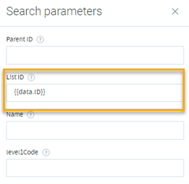

Edit the export containing the deprecated operation,
and click to launch the search parameters
Notice that List ID is a Search parameter in the deprecated operation

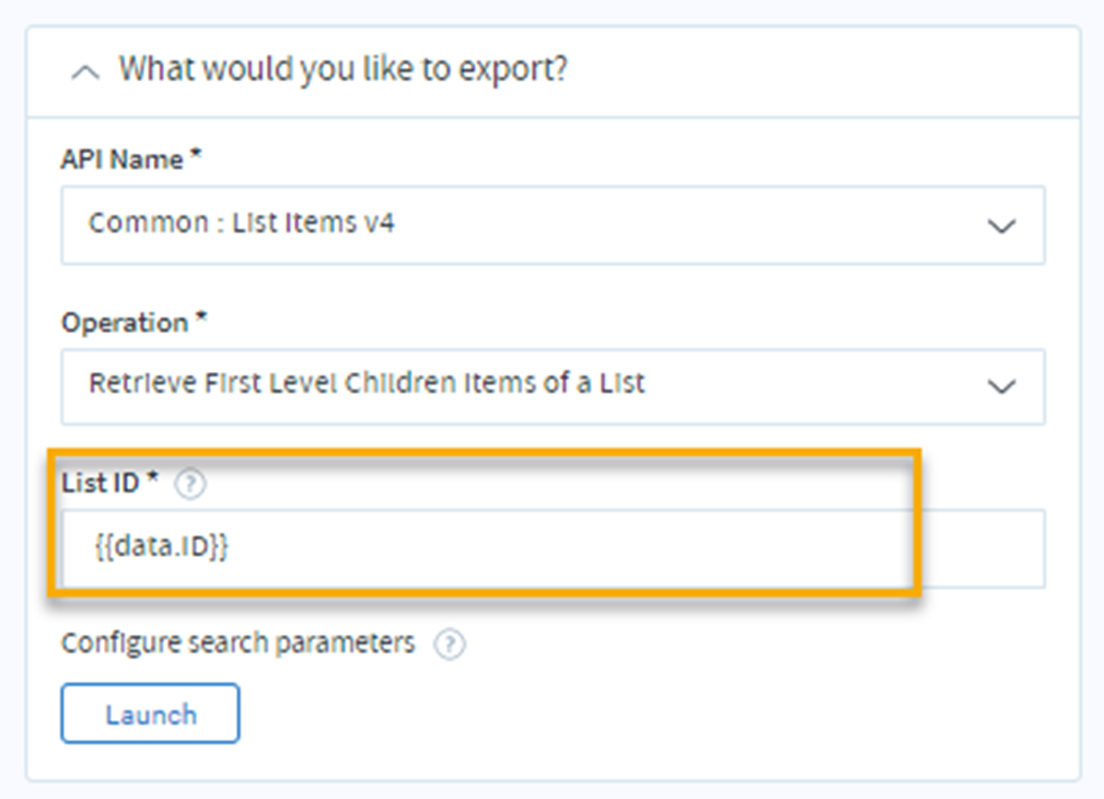

In the upgraded v4 operation, you can now pass List ID as a path parameter

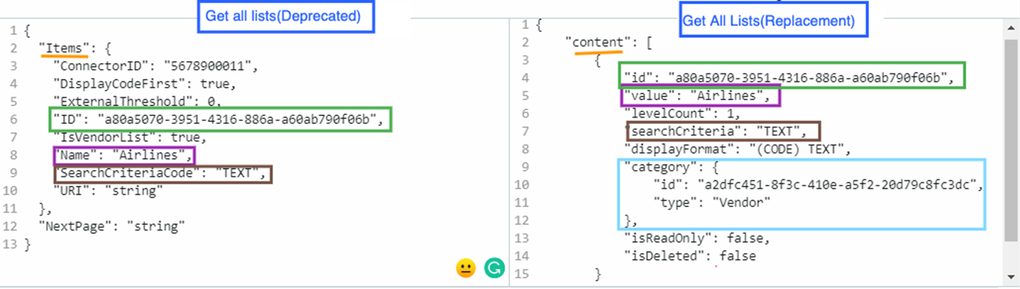

The responses from the Concur deprecated and replacement list endpoints are different, as demonstrated below:

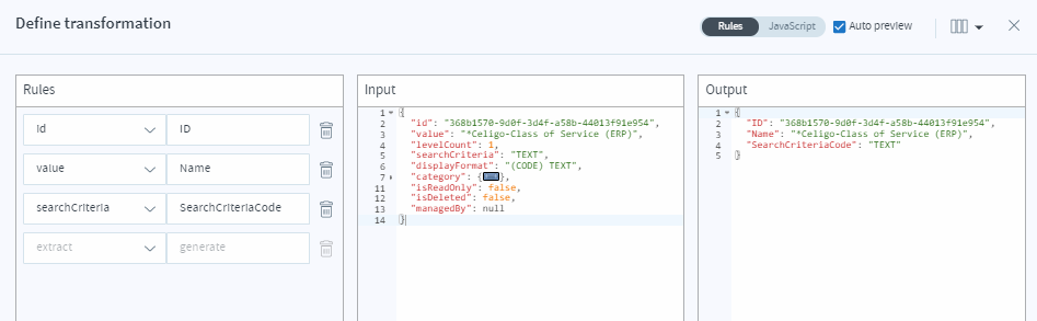

As shown above, the deprecated endpoint contains the field ID, while the response of the new endpoint has id. Also, the path Items.ID is now content.id.
The new fields will affect the source record values in all of the affected flows’ import mapping. The easiest way to maintain the mapping is to add transformation rules in the export. After converting the new response data format to the old one, the mapping should work correctly.

Get all lists, deprecated operation response format:
  "Items": {
    "ConnectorID": "5678900011",
    "DisplayCodeFirst": true,
    "ExternalThreshold": 0,
    "ID": "a80a5070-3951-4316-886a-a60ab790f06b",
    "IsVendorList": true,
    "Name": "Airlines",
    "SearchCriteriaCode": "TEXT",
    "URI": "string"
  "NextPage": "string"
Get All Lists, new operation response format:
  "content": [
      "id": "a80a5070-3951-4316-886a-a60ab790f06b",
      "value": "Airlines",
      "levelCount": 1,
      "searchCriteria": "TEXT",
      "displayFormat": "(CODE) TEXT",
      "category": {
        "id": "a2dfc451-8f3c-410e-a5f2-20d79c8fc3dc",
        "type": "Vendor"
      "isReadOnly": false,
      "isDeleted": false

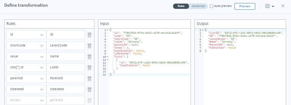

Define transformation panel with id renamed, giving its value to ID
Example transformation with Retrieve all list items based on the search criteria (deprecated) fields converted to Retrieve First Level Children Items of a List

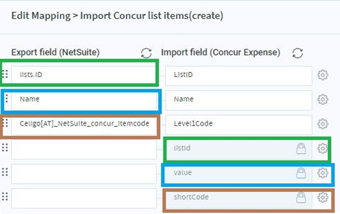

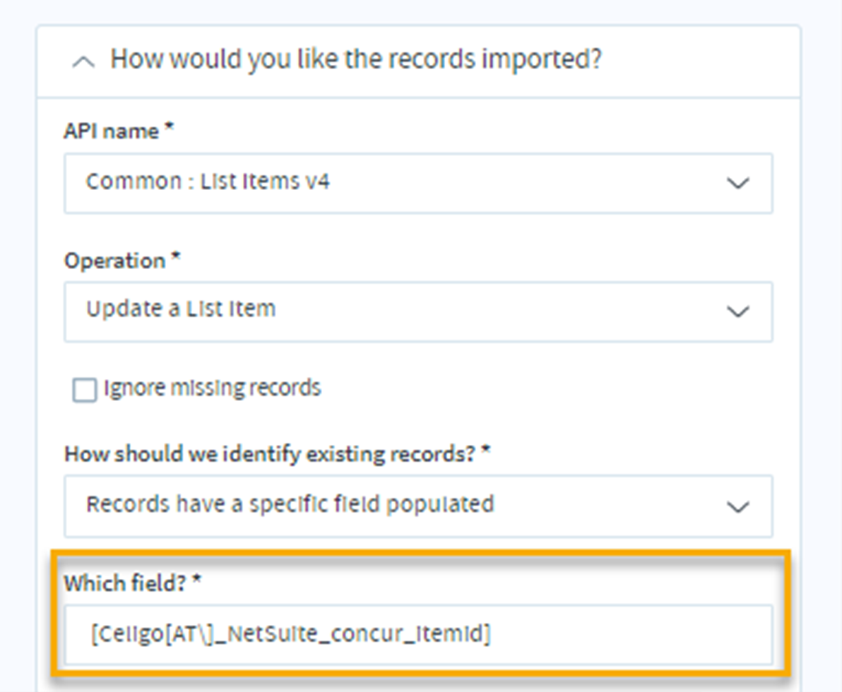

D. Update import mappings
The responses from the deprecated and replacement Concur endpoints are different, as illustrated here:

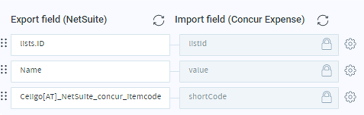

Create a list item v4 API endpoint applied to the import, prior to mapping changes
So, after performing the changes mentioned in C. Add transformation rules, the next step is to change the mappings to remove the padlocked fields shown above.
Note that in the deprecated endpoints, as illustrated in the example below, the field name was ListID, the new endpoint name is listid, and the Concur Import field is updated.
Revised imports mappings

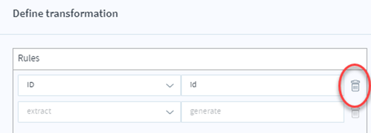

E. Remove unneeded transformation rules
Your legacy flows may have transformation rules applied to import flow steps, especially if you based them on an SAP Concur template. For example, the transformation rule applied in Import Concur list items (create) is no longer required for the Concur List item v4 response.
Click the Transformation rules ( Define a transformation) button to the right of the import to edit these values, delete each unnecessary rule, and click Save.
Continue to revise the field mappings for the remaining flows, according to the examples provided above.

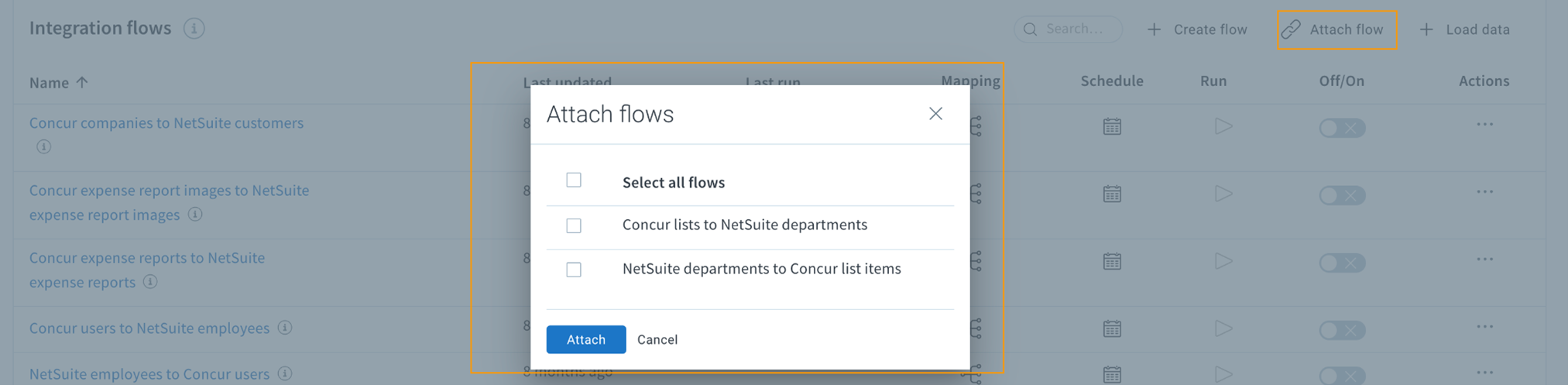

Refreshing an integration based on an SAP Concur template
The current versions of SAP Concur Celigo Quickstart integration templates have been upgraded to List v4 and List item v4 APIs. If you’ve built your integrations by modifying a template, it might be quickest to make the parallel changes from your modified list-related flows to a clean template installation, as described below:
  1. Go to the integrator.io Marketplace (U.S. | EU) and open Concur Expense or Concur Invoice.
  2. Find the template you had previously installed for your Concur account type and additional endpoint, and click Preview to start the installation process:

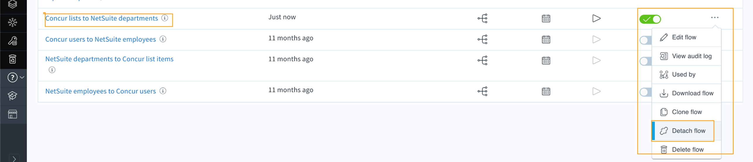

  3. Check the flows related to lists, such as Concur lists to NetSuite departments and NetSuite departments to Concur list items, and compare the new configurations with your integration’s flows.
  4. Copy the path parameters, search parameters, filter rules, and mappings (if any extra included) from your flow and paste them into the newly installed flow.
  5. Delete the v3 list flows from your integration.
  6. Detach the newly updated flows from the installed template integration, and attach each flow to your existing Concur integration.
