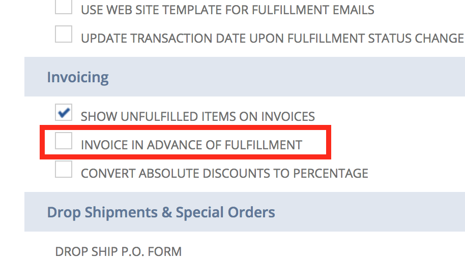

  • The order should be fulfilled in NetSuite unless the 'Invoicing in advance of fulfillment' preference is enabled in NetSuite.

  2. Confirm the accounting preferences by navigating to Setup -> Accounting -> Accounting Preferences -> Order Management -> Invoicing.
  3. If the "invoice in advance of fulfillment" box is unchecked, ensure that the Integration App is generating the invoices for you when the sales order is in the 'Pending Billing' status and not 'Pending Fulfillment'. This configuration on your Integration App can be accessed through the ' Settings' of the Billing Integration Flow.
