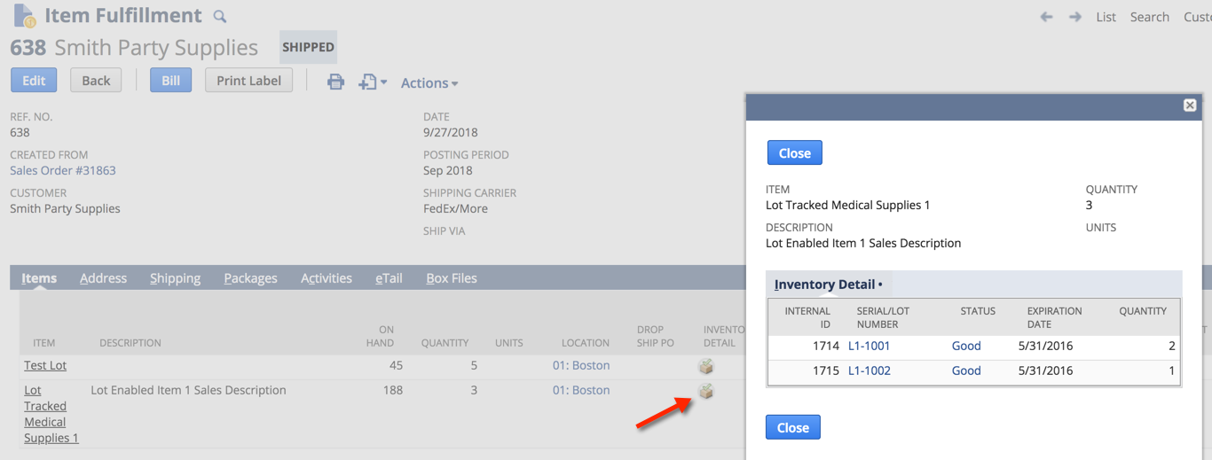

In some cases, NetSuite requires you to enter subrecords to successfully save the record, such as the Inventory Detail section for a serialized inventory Item on an Item Fulfillment record. In this example, the Item is the parent record, which defines a type of item; its subrecord would be an Inventory Detail.

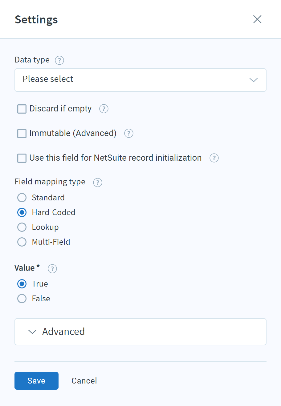

When importing into NetSuite, Address subrecords require field mapping as follows:
  1. Add a new entry under Import field (NetSuite).
  2. Accept the suggestion for this field: Use Address subrecord.
  3. Set the Field mapping type to Hard-coded.
  4. Select True for the Value.
Then, any address mappings defined will automatically use the Address subrecord if this mapping is set as described. Otherwise, address mappings would automatically use standard address fields.

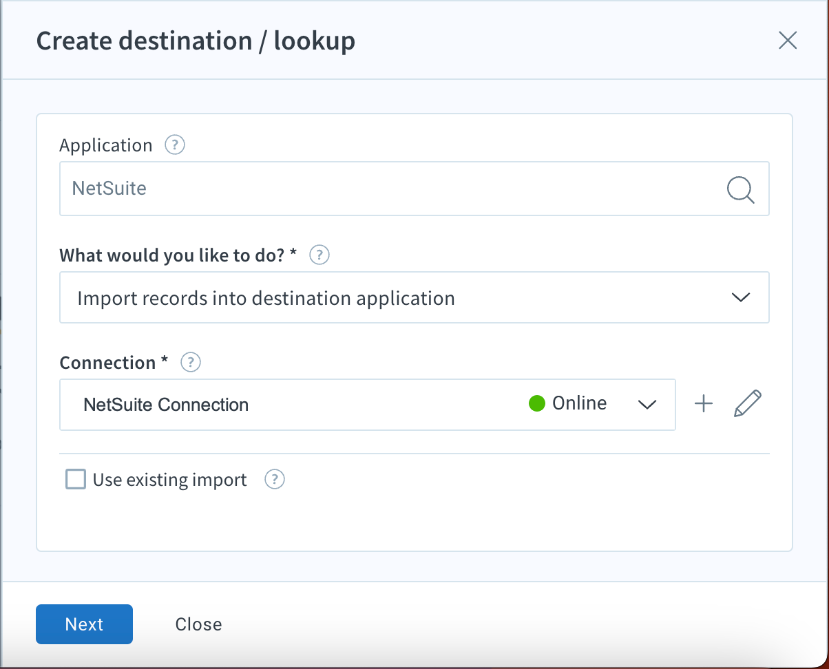

  1. In an existing flow, click Add destination/lookup in Flow Builder.
  2. Select NetSuite for the Application.
  3. For What would you like to do? pick Import records into destination application.
  4. Choose a Connection from the list or click + to create one.
  5. Do not check the Use existing import box, since we’re building a new import of a special type.
  6. Click Next.

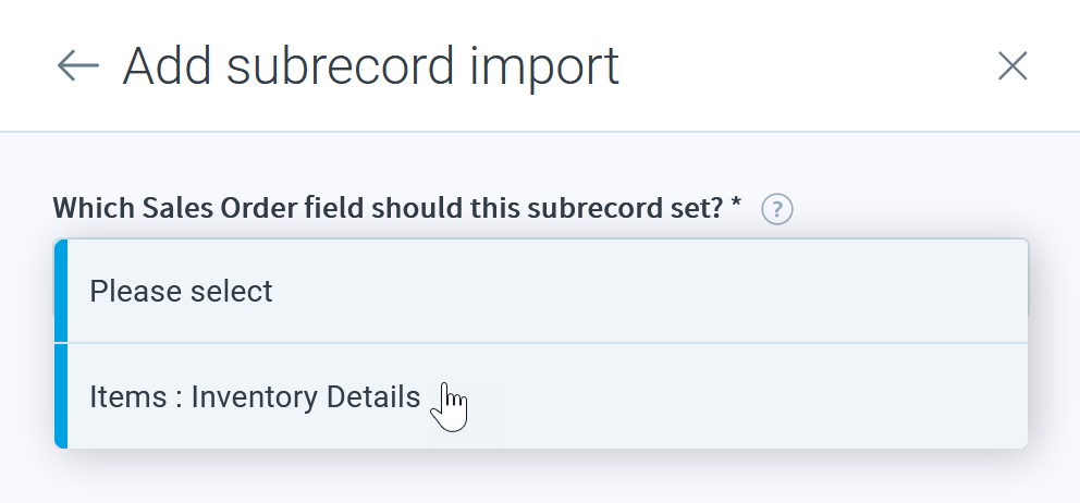

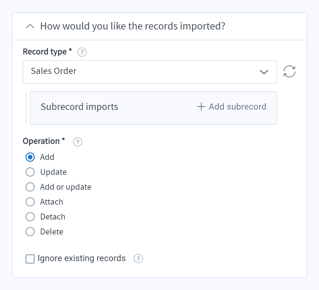

The Create import pane then offers you additional settings for the new import. When you select Sales Order for the Record type, you’re provided with an option for handling subrecords:

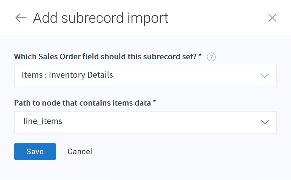

When you click + Add subrecord, the Add subrecord import pane slides into view. Choose the subrecord Items: Inventory Details.
In Path to node that contains items data, enter the JSON path from the record root to the array that holds the line items, in this example: line_items. Then, click Save.
Note: Don’t enter $ when the lines sit under a field. integrator.io then sends no inventory detail, and NetSuite fails the import with Please configure the inventory detail in line N of the item list.
Add subrecord import closes. Finally, save and close the new import.

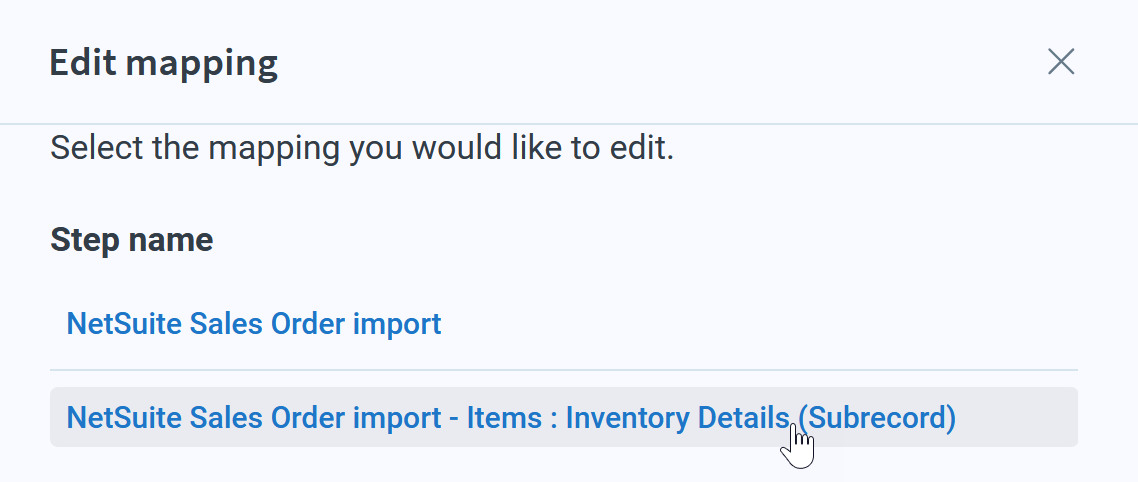

Return to Flow Builder and click the Import mapping ( edit_mappings.svg ) button on the import just created.
Typically, you would be taken directly to edit mappings. With subrecords present, you are first offered the choice of mappings for either the primary record or the subrecord:
  • NetSuite Sales Order import – The parent record mappings
  • NetSuite Sales Order import – Items : Inventory Details (Subrecord) – The inventory detail subrecord mapping

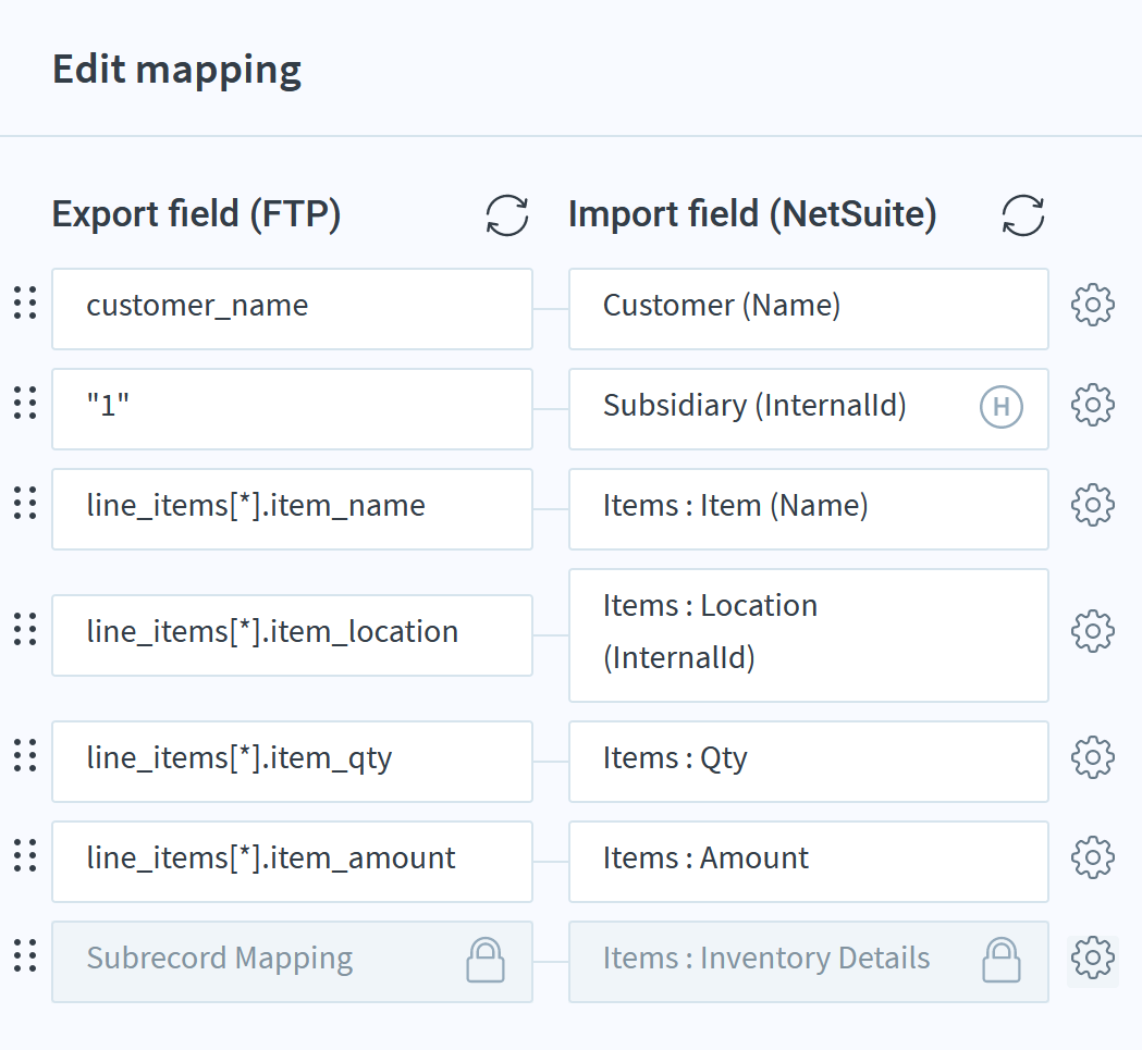

Starting with the parent-level records, enter the source fields according to the JSON structure and select the corresponding NetSuite subrecords:

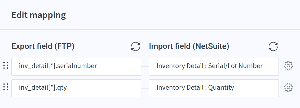

Save and close the parent mapping. Then, return to edit the mapping for NetSuite Sales Order import – Items : Inventory Details (Subrecord). For each of the sublist lines, map the Inventory Detail records:
Save and close this Edit mapping pane, as well, to complete the import mapping.

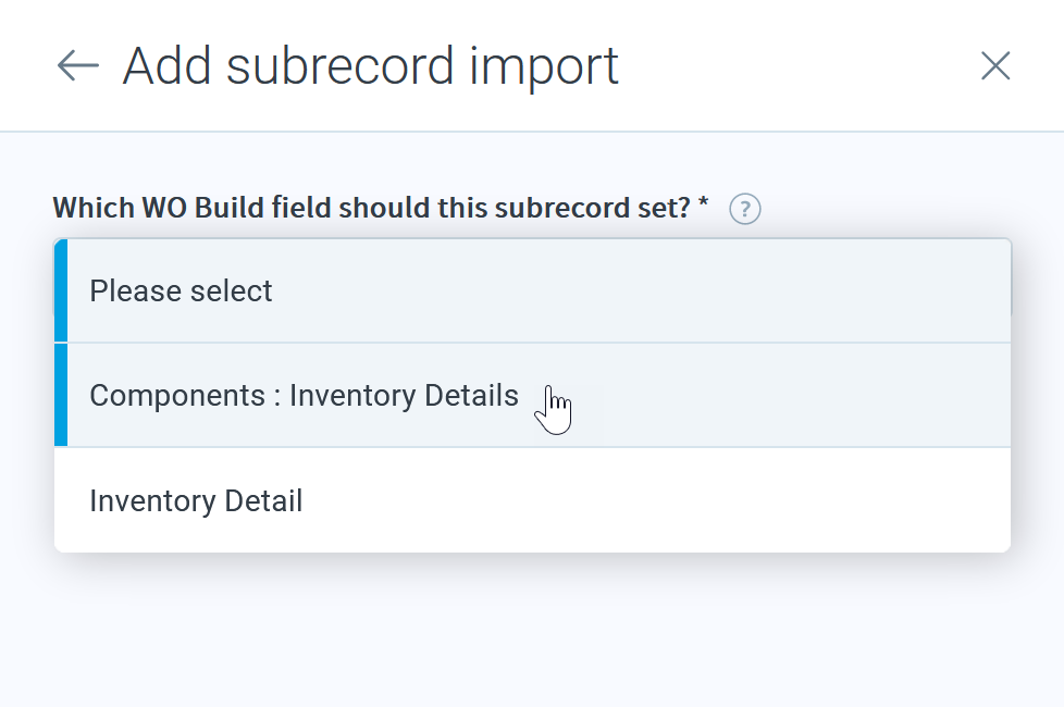

Create a WO Build import

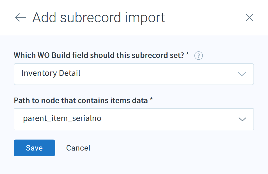

Add a NetSuite subrecord import, similar to the import created above , in this example for a WO Build record. When adding subrecords, you will then have a choice for the line-level and body-level records:
Proceed to provide the path for the line-level subrecord Components : Inventory Details, with the same process demonstrated above for the Sales Order import.
Repeat to add a subrecord import for the body-level subrecord Inventory Detail.

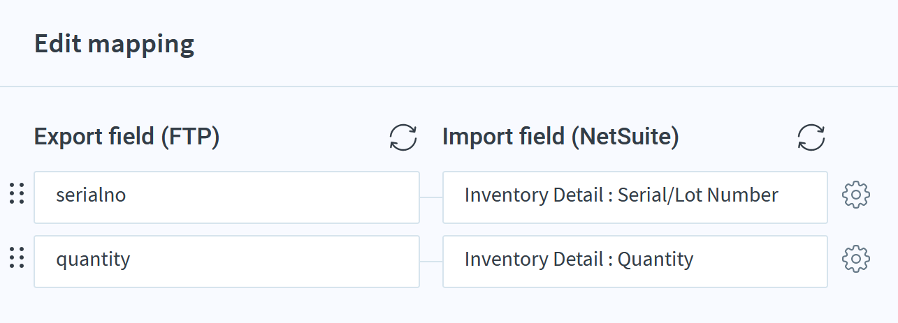

Map fields for import
Continuing this example for the body-level subrecord Inventory Detail, open the import mapping in Flow Builder. Here, the serialno and quantity are relative to the path to items node that we selected earlier.
{{img class=screenshot-frame id=12}}
