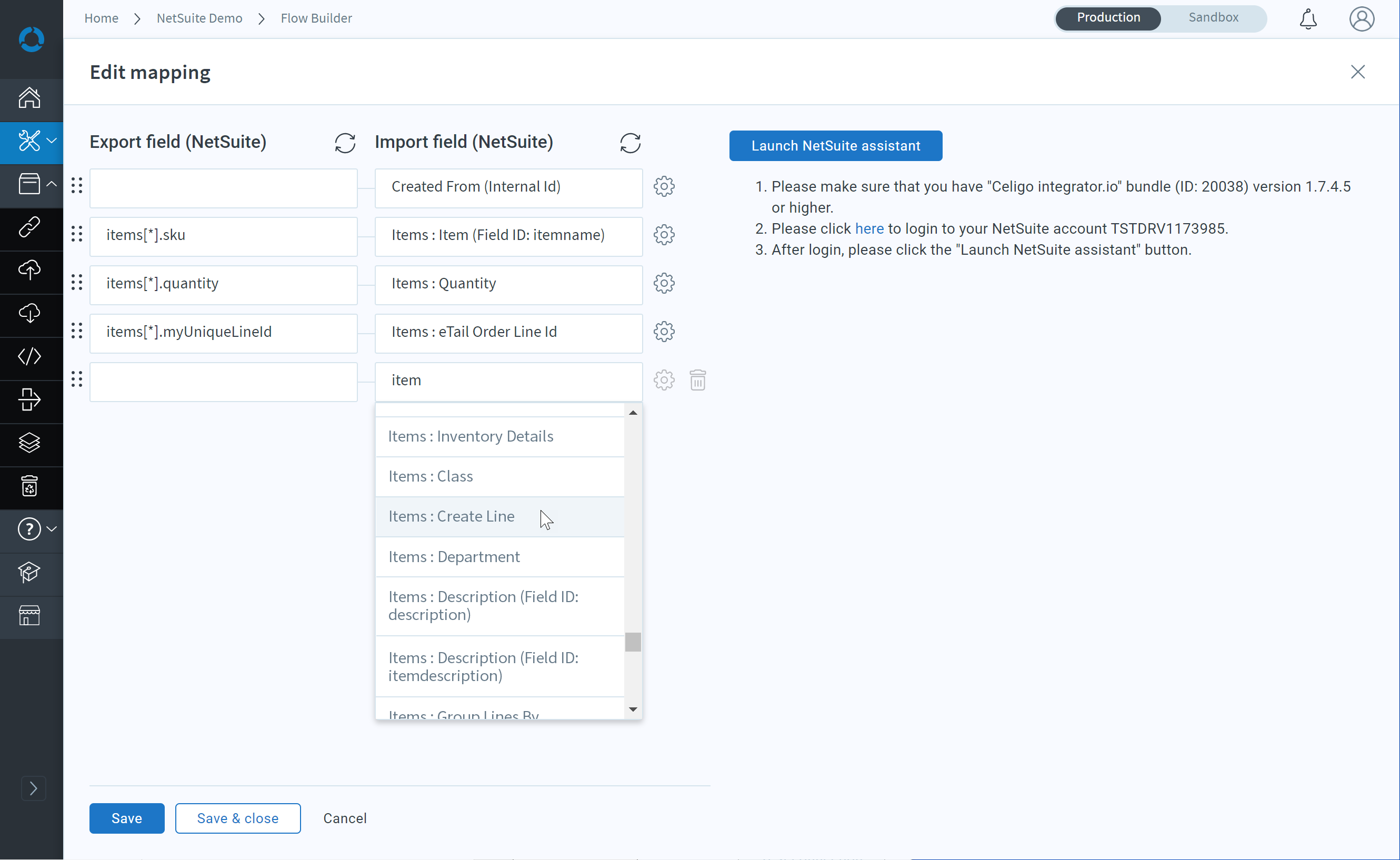

You can access line items using the sublist name. In import mapping, each sublist is populated in the format Sublist Name : Field Name
, such as Items : Department
Select the line item to map the source data to this field:

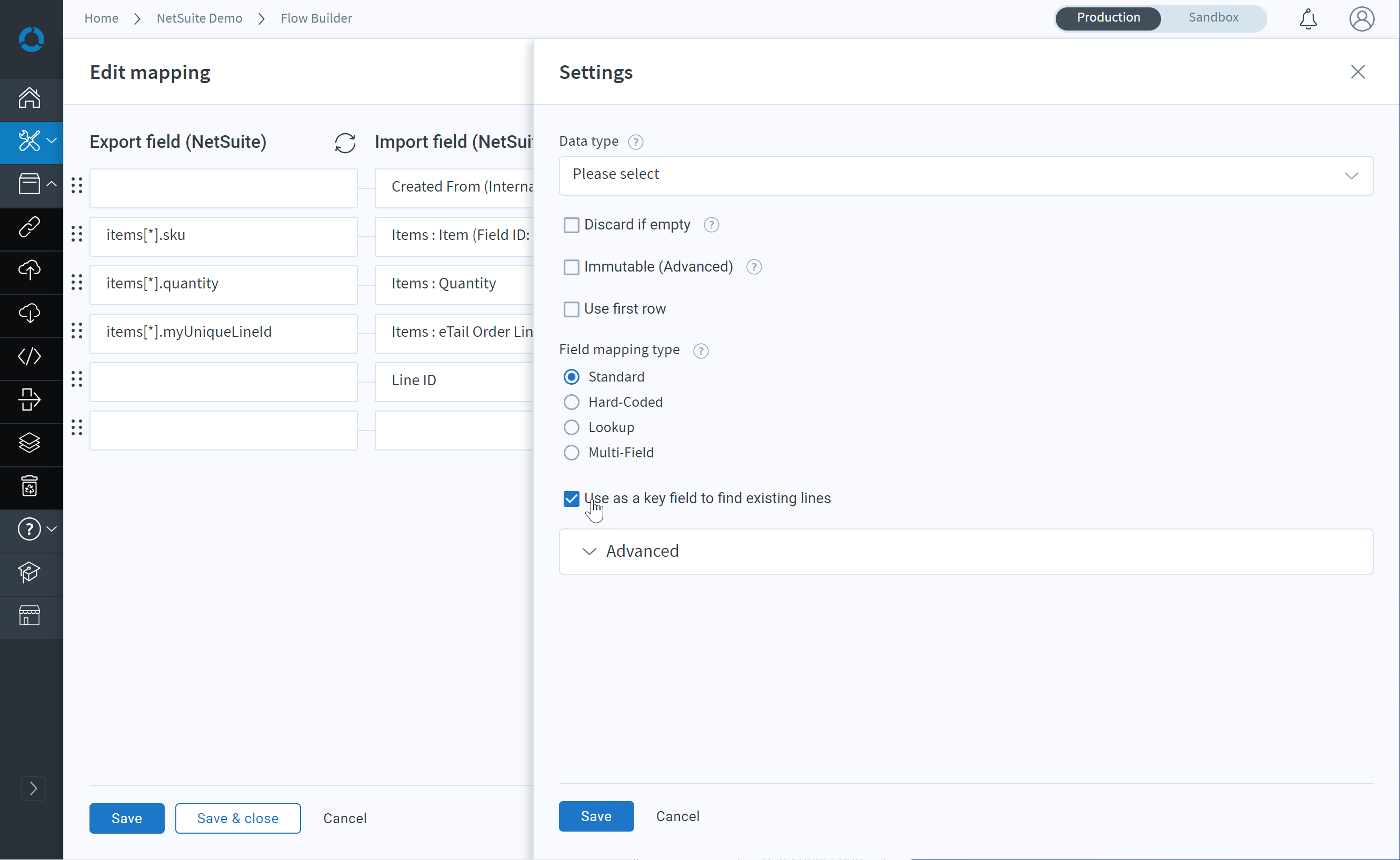

Provide a custom field as a key value to find a line item
You can also instruct integrator.io to use a custom or standard field to find an existing line.
Let’s say that you have a custom field called eTail order Line ID, which is unique for all the lines in that record. You can use this field to find a matching line with the field value:
- For the mapping to eTail order Line ID, click the Settings (
) button.
- In the resulting Settings pane, check Use as a key field to find existing lines.
- Click Save.
When the key field option is enabled, integrator.io tries to match the field value from the source data against the field value in NetSuite lines. If it finds a match, that line will be updated; otherwise, a new line will be inserted.

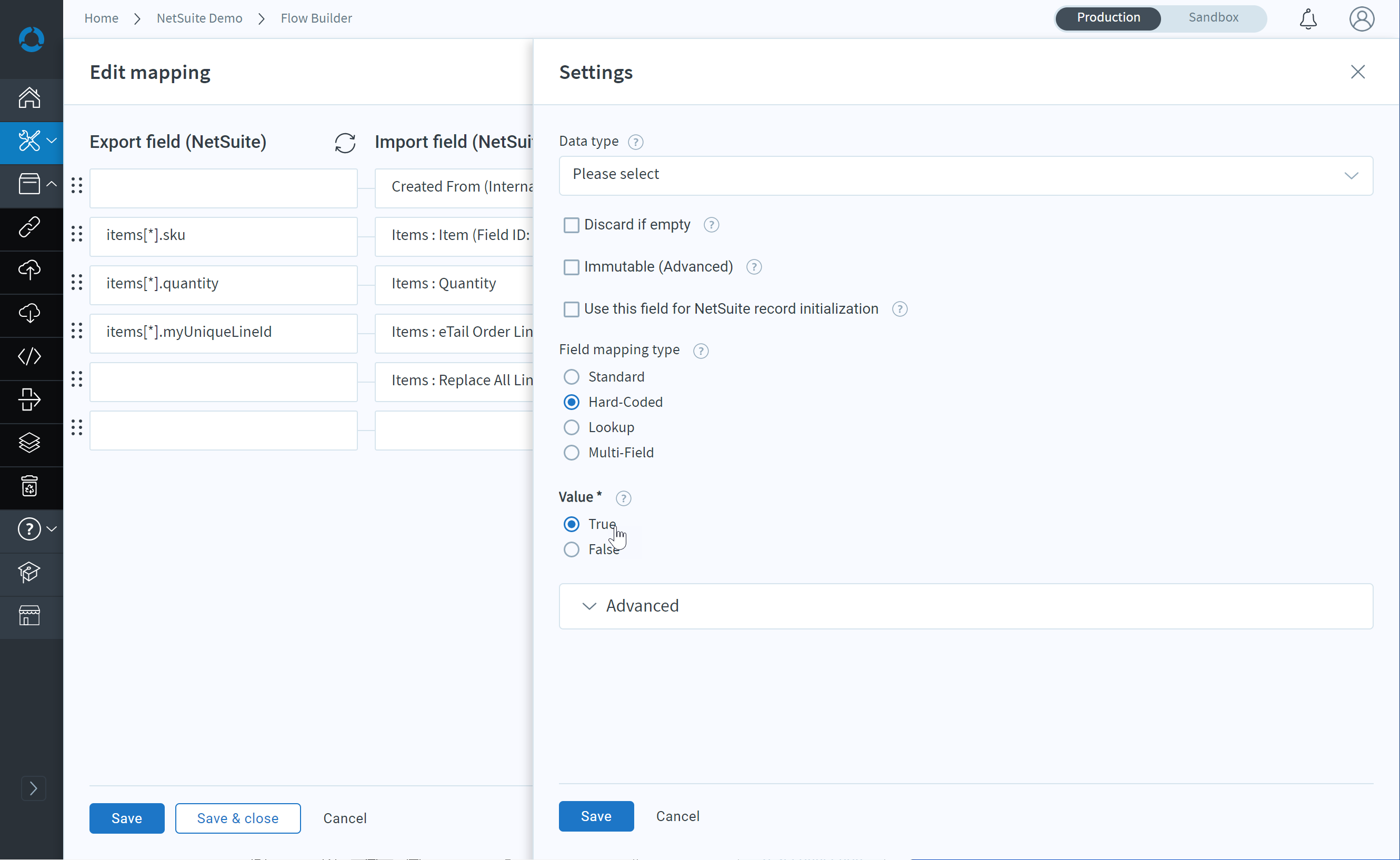

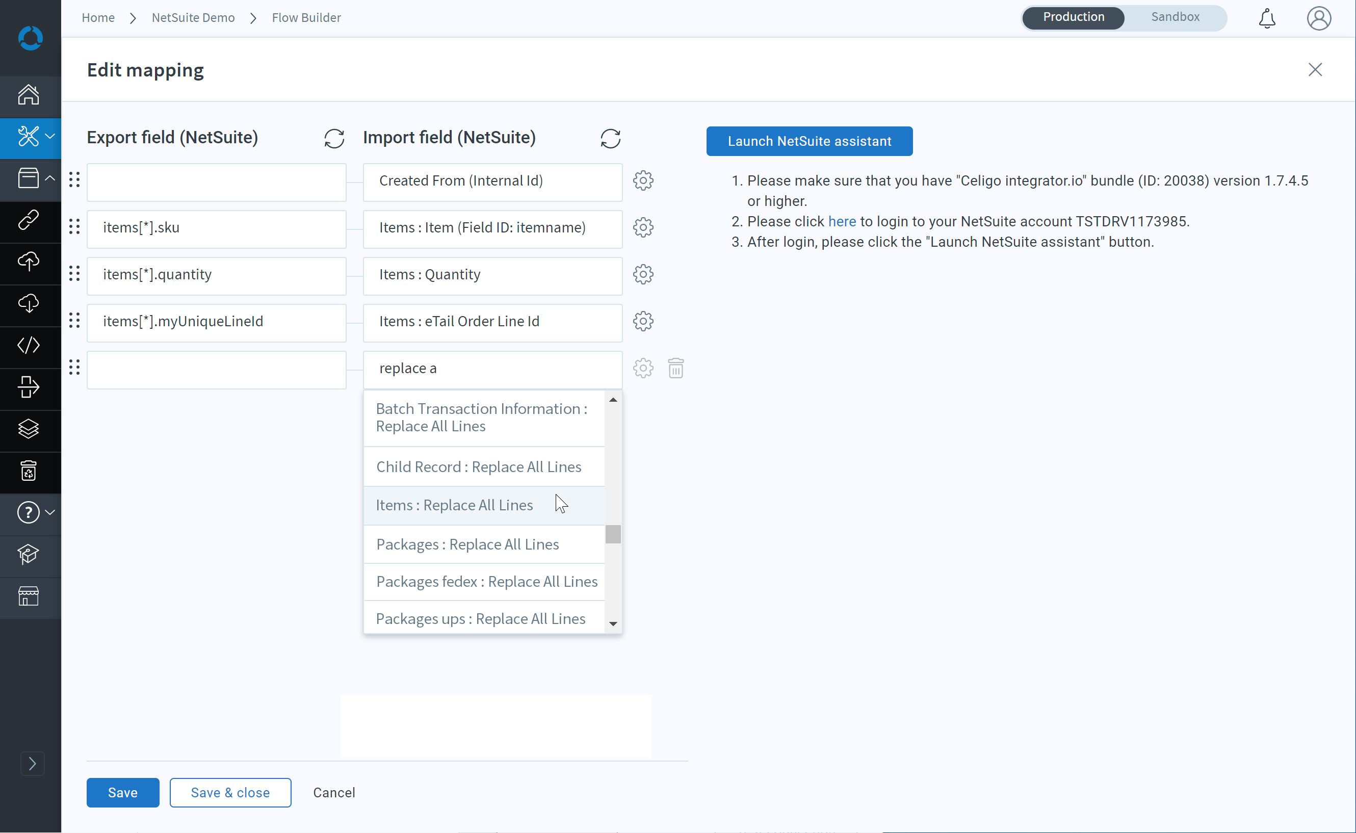

Replace all lines in a record
In some cases, the source data may contain the complete order instead of just the delta changes. In others, some lines might be removed from the source system that are still in your NetSuite line items. Nonetheless, you might want to remove all the existing lines and add all the lines from your source data into NetSuite.
To enable this setting, add a new import field mapping for Items : Replace All Lines, and hard-code the value to True. Each sublist on the parent record should have a similarly named mapping option available.
Note: If an item already exists on the record in NetSuite, integrator.io only updates the record. If the item doesn't exist, integrator.io replaces all lines and adds new items. To replace all lines every time, use an alternate identifier that is certain not to already have existing lines. Check the Use as key to find existing lines checkbox on the import field that you want to use as the identifier..

Are there any details related to the Items : Create Line mapping that could be shared?
Hi, Stephen Lemp. You ask a good question that I don't have a ready answer for, in terms of use cases and NetSuite behavior. Our developers identified it at first glance as a "legacy" mapping function, and we hope to get back to you with more details after looking into it further.
