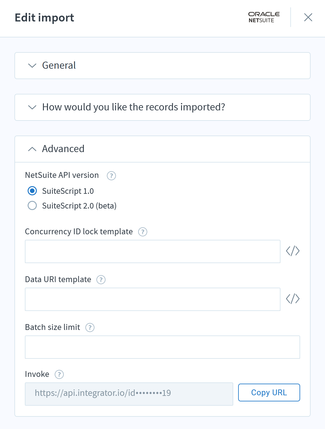

Modify the import “batch size”
NetSuite imports allow you to control the Batch Size limit. This property limits the number of records sent to NetSuite to a maximum number.
To adjust this value, navigate to the import configuration and expand the Advanced settings.
Optional Batch Size limit setting
This setting is unrelated to the NetSuite export Batch size limit setting, which determines how many records can be retrieved at a time, before they are organized into pages within your flow.
Upgrade the NetSuite API version
If the other recommendations aren’t reducing your point usage, try switching the NetSuite API version in the import (shown above) to SuiteScript 2.0.
