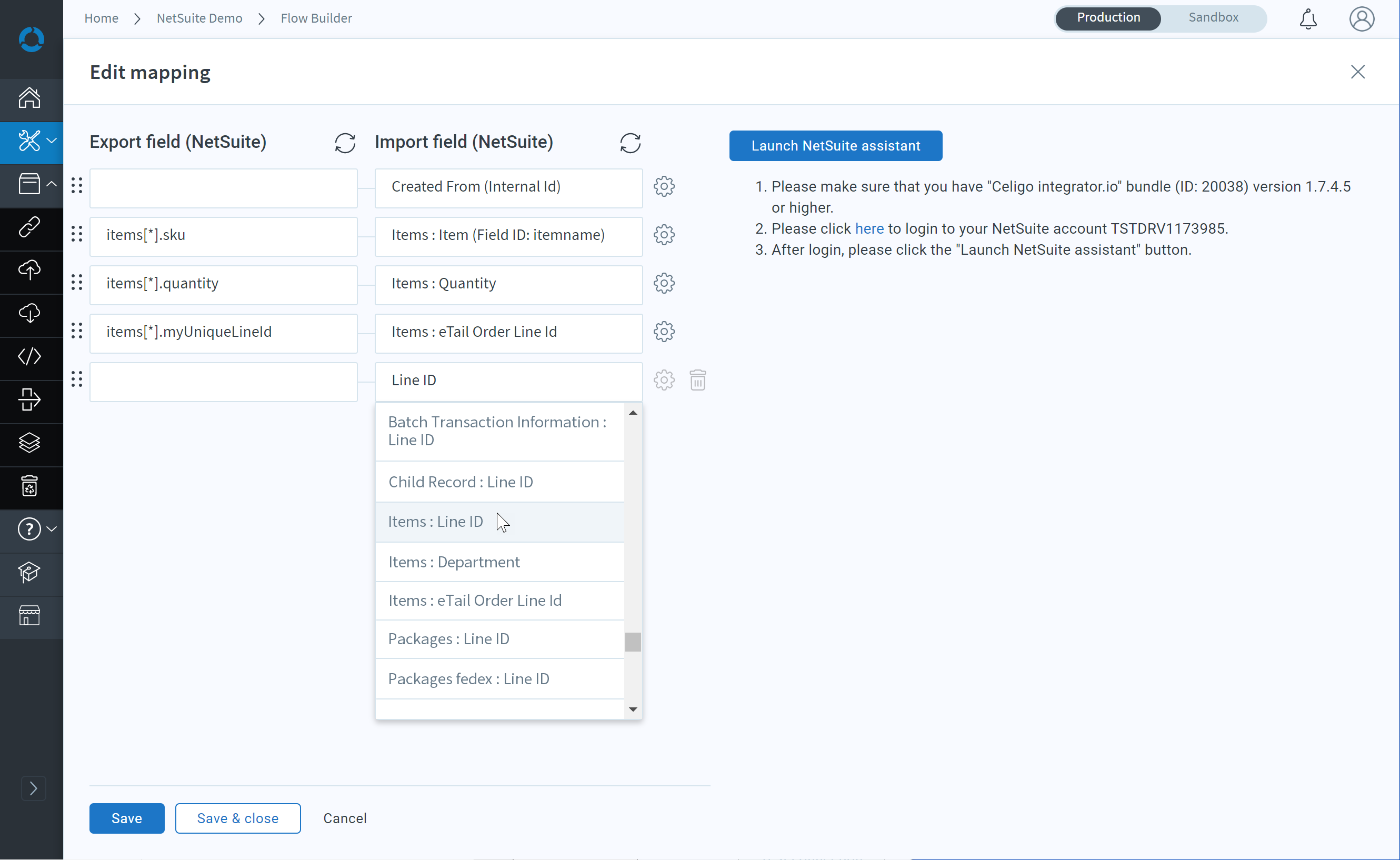

In some cases, you might already have the line identifier (Line ID in NetSuite), which is unique for each line. Then, when mapping the Line ID for a sublist, integrator.io will use the Line ID to try to find and update that line; if no matching Line ID is found, one is created.

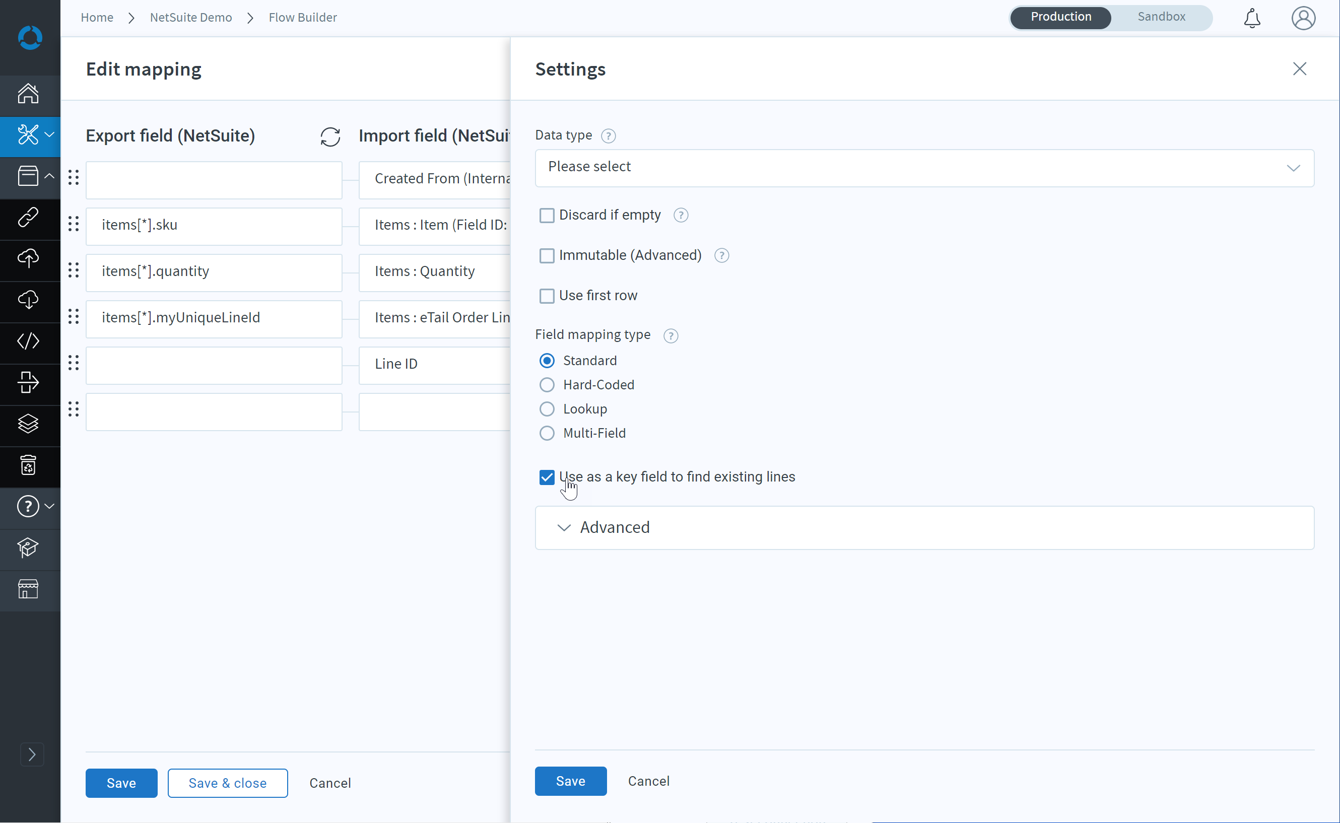

Provide a custom field as a key value to find a line item
You can also instruct integrator.io to use a custom or standard field to find an existing line.
Let’s say that you have a custom field called eTail order Line ID, which is unique for all the lines in that record. You can use this field to find a matching line with the field value:
  1. For the mapping to eTail order Line ID, click the Settingsgear-options.svg ) button.
  2. In the resulting Settings pane, check Use as a key field to find existing lines.
  3. Click Save.
When the key field option is enabled, integrator.io tries to match the field value from the source data against the field value in NetSuite lines. If it finds a match, that line will be updated; otherwise, a new line will be inserted.

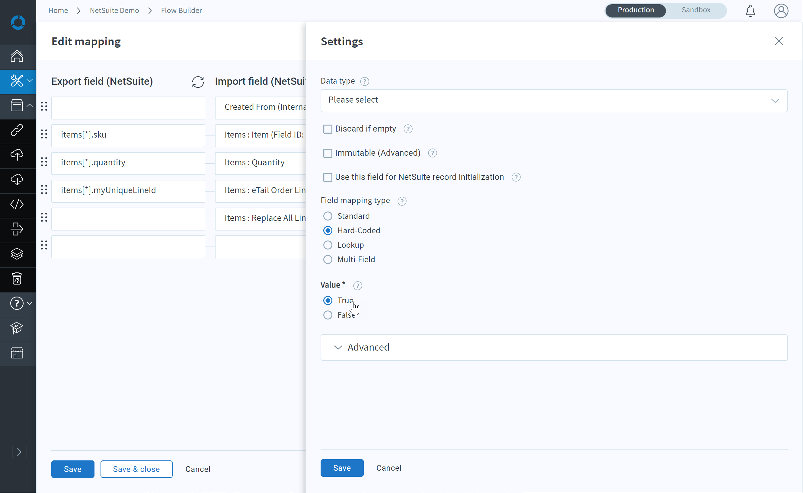

Replace all lines in a record
In some cases, the source data may contain the complete order instead of just the delta changes. In others, some lines might be removed from the source system that are still in your NetSuite line items. Nonetheless, you might want to remove all the existing lines and add all the lines from your source data into NetSuite.

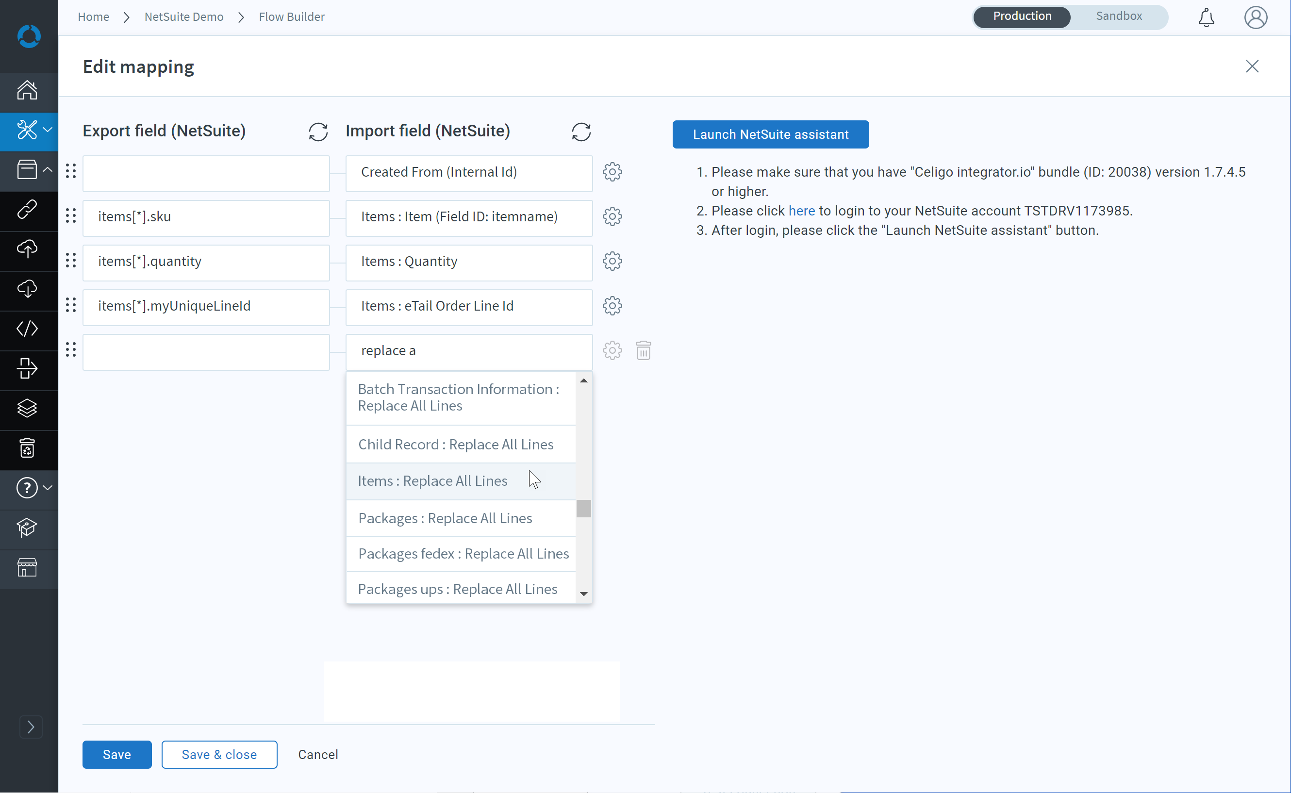

To enable this setting, add a new import field mapping for Items : Replace All Lines, and hard-code the value to True. Each sublist on the parent record should have a similarly named mapping option available.
Note: If an item already exists on the record in NetSuite, integrator.io only updates the record. If the item doesn't exist, integrator.io replaces all lines and adds new items. To replace all lines every time, use an alternate identifier that is certain not to already have existing lines. Check the Use as key to find existing lines checkbox on the import field that you want to use as the identifier..

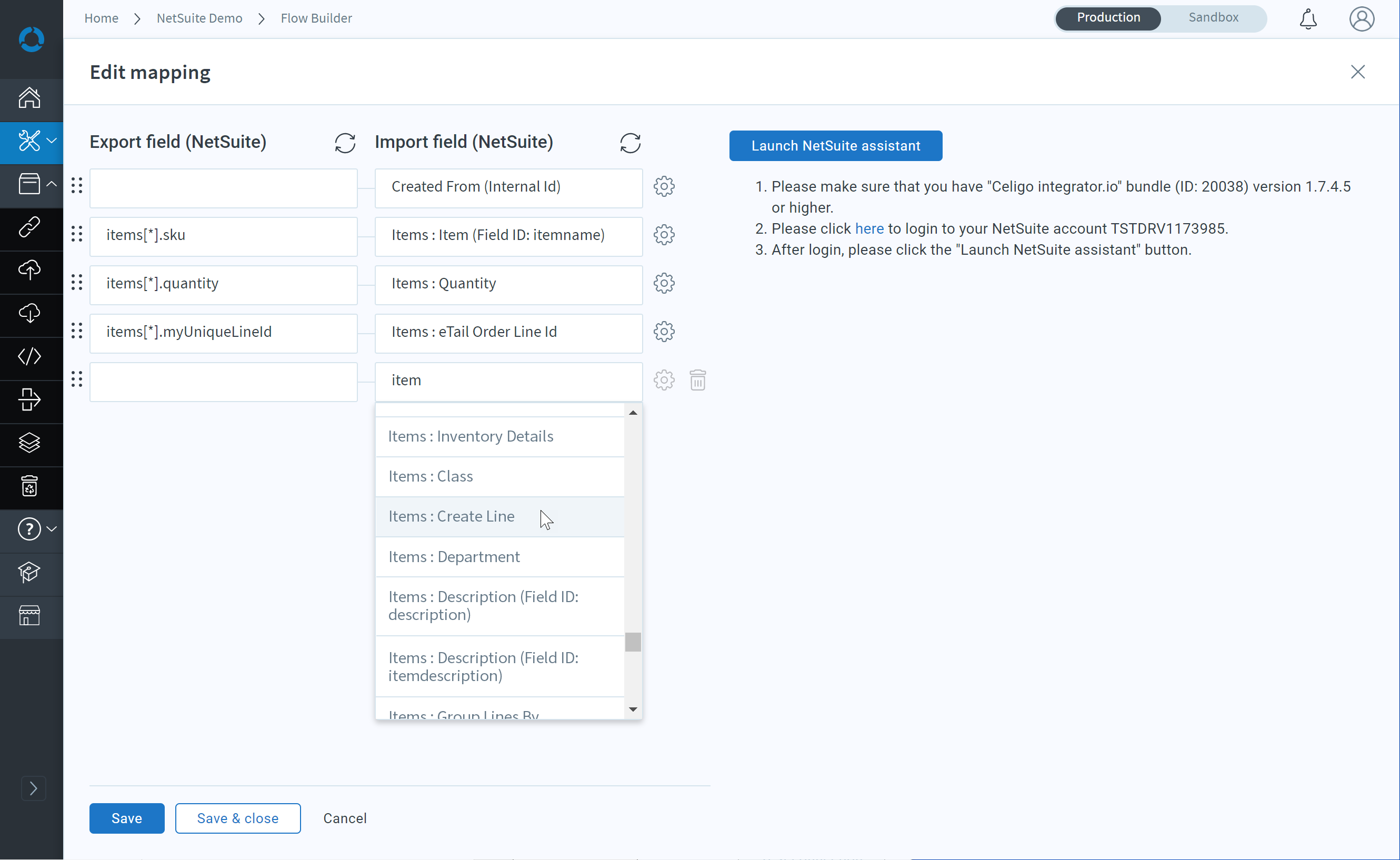

  • Are there any details related to the Items : Create Line mapping that could be shared?
    0
  • Hi, Stephen Lemp. You ask a good question that I don't have a ready answer for, in terms of use cases and NetSuite behavior. Our developers identified it at first glance as a "legacy" mapping function, and we hope to get back to you with more details after looking into it further.

  • Tyler Lamparter Attached are snippets from our NS saved search showing the Saved Search results and the field that's defined in the search settings. Also attached are snippets from our Celigo flow trying to map to this Line ID. In my use case, I'm attempting to update the targeted transaction line with a department. This is a single GL line on an Item Receipt transaction. This method works for most other transactions, but for some reason this transaction doesn't allow it.
    Celigo's list of fields available for mapping includes 3 "Line ID" fields:
    • Items : Line ID
    • Expense : Line ID
    • Batch Transaction Information : Line ID
    I've tried mapping to all 3 with the "Use as a key field to find existing lines" option checked, but I get the same error each time.
    0
  • Matthew Morrill items : line id should be it. What does the request look like under "view request"?
    0
  • Tyler Lamparter Thanks again for all the help!
    Here's what the request and "Error Fields" look like:
    0
  • Matthew Morrill can you try a few things? I'm not super sure why it's trying to add a line item there. If you notice, it's attempting to insert line 21.
    1. Remove the "Internal ID" mapping. This isn't needed and shouldn't harm anything, but remove it and try again.
    2. Try removing the "record." piece of the mapping. This shouldn't be needed and shouldn't harm anything, but just knocking out small things to make sure. Try and run again.
    3. If that doesn't work, try to map "Use dynamic mode" and hardcode the value to "true". Move the mapping to the top of your mappings.
    4. If that doesn't work, remove the previous use dynamic mapping and try to transform the data on the initial source step like was explained above. The transformation would look like this. After that, modify your line mapping to map to the new lines array field i.e. line_items[*].line_id. Add the other fields into your transform as needed. This would be on the source side of the flow.
    5. If all that fails, try to use SS1.0. You'll have to remake the import and make sure to select SS1.0 before you save it. After that, remake the mappings.
    6. If all that fails, I would file a ticket and see if support can help out.

  • Did you guys ever find out more on the Items : Create Line mapping?  It's mentioned in this document NetSuite field definitions for import mapping – Celigo Help Center.  I tried it a long time ago to ignore some lines during and import and it didn't work as expected.  I striped them out with a script.  It would be a handy feature sometimes.
    0
  • David Gollom what are you trying to solve for? Just creating new lines and ignoring existing lines?
    0
  • Tyler Lamparter not really solving anything specific. Just want to learn. However, the idea is you have an export with a line array. One of the lines is a subtotal that you don't need to import into NetSuite. You use a handlebar expression to set Create Line to false for that line and it gets ignored.
    0
  • David Gollom that makes sense. Are you sure this boolean field mapping for "Create Line" doesn't work? I can test it sometime soon if you don't get to it before me.
    0
  • Tyler Lamparter if I remember correctly, the mapping didn't "seem" to do anything.  So, I didn't try real hard to make it work. I'll try to test it out.
