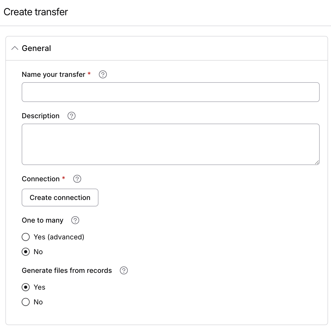

To create your lookup or import:
Name your transfer *: Name your resource so that you can easily reference it from other parts of the application.
Description: Describe your resource so that other users can quickly understand what it is doing without having to read through all the fields and settings. Be sure to highlight any nuances that a user should be aware of before using your resource in their flows. Also, keep this field up to date as you make changes to the resource.
Connection *: Find an existing connection to apply to this import or lookup, or you can click Create connection to define a new resource that you can use here and in other flow steps. Each connection contains securely stored credentials and information needed to access this application. All connections displayed in this list are specific to this application and registered to you for this integration.
One to many *: There are advanced use cases where a parent record is being passed around in a flow, but you actually need to process child records contained within the parent record context. For example, if you're exporting Sales Order records out of NetSuite and importing them into Salesforce as Opportunity and Opportunity Line Item records, then you will need to import the Opportunity Line Item records using this option. One to many is used in cases where you have a single record which internally needs to create multiple records. This field cannot be used when importing a CSV file.
Generate files from records *: Choose Yes to build a new CSV, XML, JSON, or other file. Choose No to transfer raw files as-is (such as PDFs or JPGs).

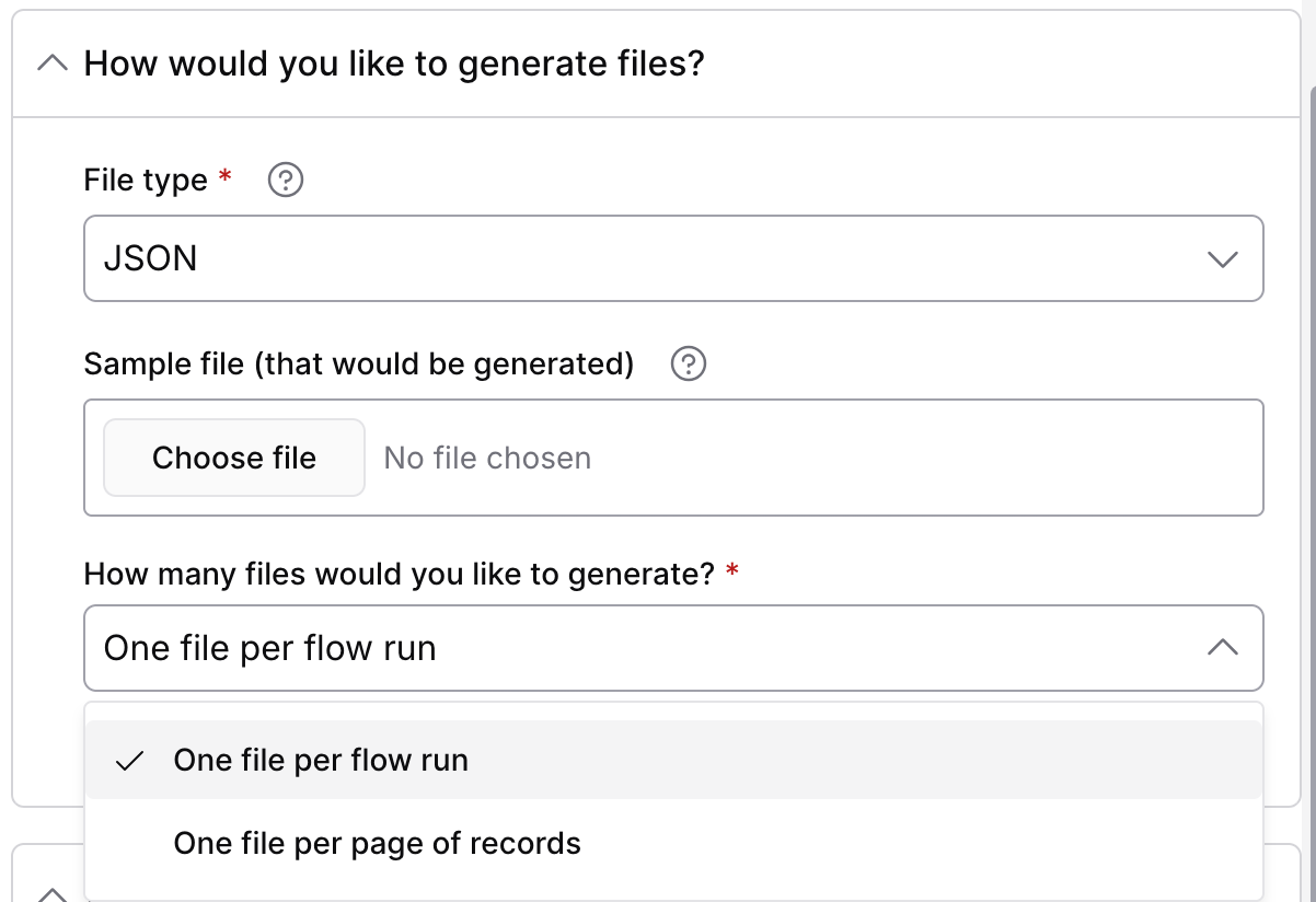

How would you like to generate files?
File type (required): Select the type of file that you want to generate. For example, choose CSV if you are importing a flat, delimited text file, or XLSX for a binary Microsoft Excel file. The file name you specify can include a file extension, but it does not affect this setting. You can then choose a sample file to define the record structure. For example, if you are importing CSV files (i.e. files containing Comma Separated Value data), choose CSV. Each file type includes additional settings to customize your import. Acceptable file types include:
  • CSV (or any delimited text file): See File generation for structured data in CSV and XLSX.

Sample file (that would be generated): If you have a sample file that represents the record structure of the files to transfer, you can upload the sample file here. We will use the sample file to auto-set various fields (where possible), and also help you map data in a subsequent step. The sample file that you provide does not need to be overly large (at max 5 records), but it should contain all the fields that you want to work with, and also be in the same format that the transfer will need to generate when running in a production capacity.
How many files would you like to generate?: Select how the flow should generate output files. Select One file per flow run to create a single file that contains all of the records processed during the flow run. If the flow includes more than one export, one file will be generated for each export. For real-time flows, a file is created using all of the records received in the current request. Select One file per page of records to generate a separate file for each page of records processed during the flow run. This setting appears only when you select CSV, XML, JSON, or XLSX file type.

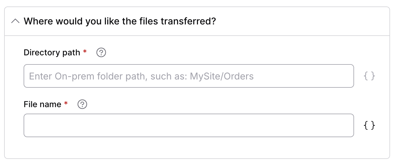

Where would you like the files transferred?
Directory path *: Use this field to specify the directory path of the folder where you want files to be transferred. For example, if you set this field to C:\Users\Administrator\Desktop\load, integrator.io will first look for a parent folder Users and child folders Administrator\Desktop\load.
File name *: Specify how to name files that are uploaded to the on-prem system. If you want to upload data as multiple files to the on-prem system, check Skip aggregation in the Advanced section. To provide unique filenames, express them according to the following handlebars templates:
  • Timestamp: For example, FileXYZ-{{timestamp "YYYY-MM-DD-HH-mm-ss-SSS" "America/Los_Angeles"}}.csv will upload files with the following naming pattern: FileXYZ-2024-09-16-07-33-54-443.csv
    Use a timestamp with the milliseconds token to avoid overwriting files.
  • Random: For example, FileXYZ-{{random "uuid"}}.txt will upload files with the following naming pattern: FileXYZ-69368e91d9a440f79165b73afd46859d.txt. While you can include any file extension you like, it will not change the type of data generated.
