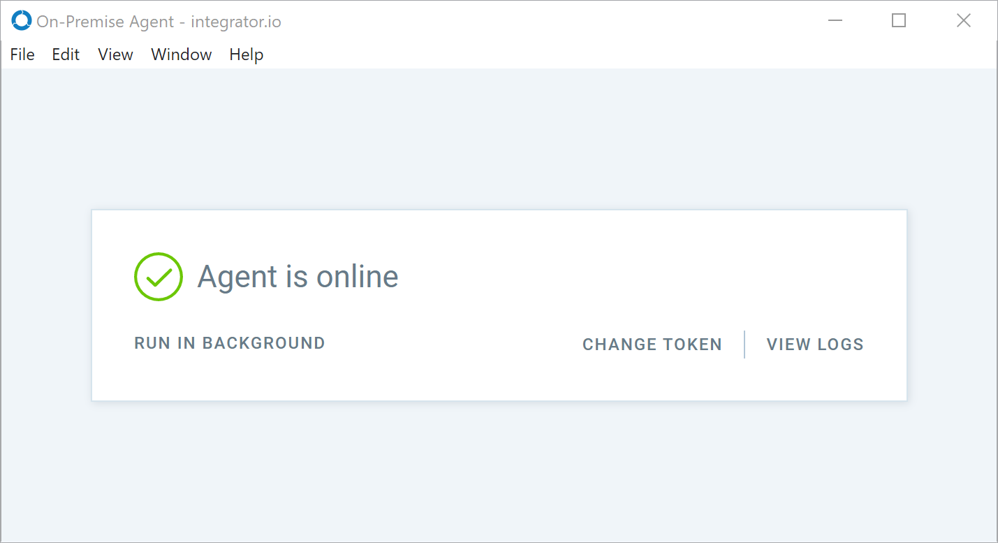

  • Review logs (optional for early signs) Follow the steps below to inspect the agent logs in either Windows or Linux operating systems. If the logs are not available, check for missing or empty log files. Windows:
    1. Open the Celigo Agent in your Windows server.
    2. Select View logs.
    3. Search for:
      1. Connection errors
      2. Authentication failures
      3. Unexpected restarts or shutdowns

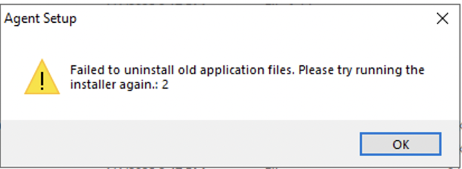

Failed to uninstall old application files. Please try running the installer again.: 2
Issue: You may encounter the following pop-up error dialog when using the Celigo agent, particularly after an automatic update.
Error: Failed to uninstall old application files. Please try running the installer again.: 2
Error dialog reading Failed to uninstall old application files. Please try running the installer again.: 2
Root cause: This issue is typically triggered when the Windows system PATH environment variable is in a corrupted or inconsistent state following the agent's auto-update process.
Solution: Restart the system. A full Windows restart often resolves the issue, as the operating system will attempt to automatically repair or reload critical environment variables (such as the PATH variable) during startup.

How can I reopen the on-premise agent window and make changes, after it's set to run in the background?
Most agent installations choose to Run in background, in which case the program, On-Premise Agent – integrator.io, is not visible in the Windows taskbar. To restore the agent user interface and make changes or view activity logs, double-click the program's shortcut.

Audit logs
To view activity logs, double-click the program's shortcut and select View logs in the desktop application, or you can browse the folder C:\users\<UserName>\AppData\Roaming\Agent.
The on-premise agent desktop application showing the View logs option.
