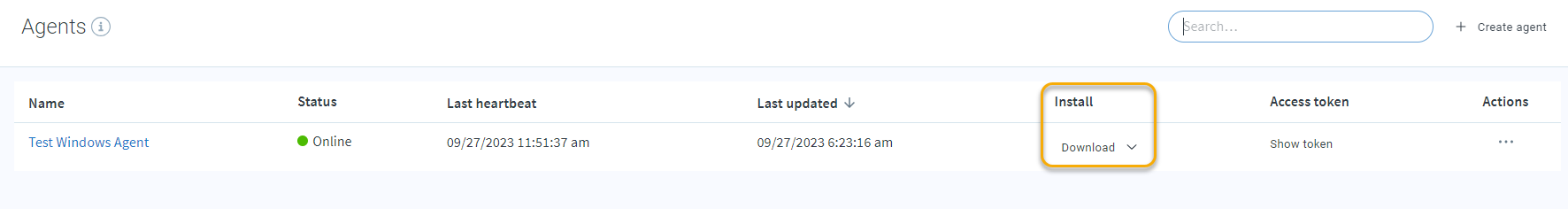

Step 4: Download the latest agent installer
  1. Go to Resources, and then select On-premise agents. Select Download next to your existing agent, and then select your operating system (Windows or Linux).
  2. Save the installer file to the machine where your agent is running.
Download from your existing agent — don't create a new agent. Downloading and installing the updated binary on the same agent preserves all your connections and flow associations.
If your agent runs on a different machine than the one you’re using, transfer the installer to that machine before continuing.
The agents list with the Download option next to an existing agent.
