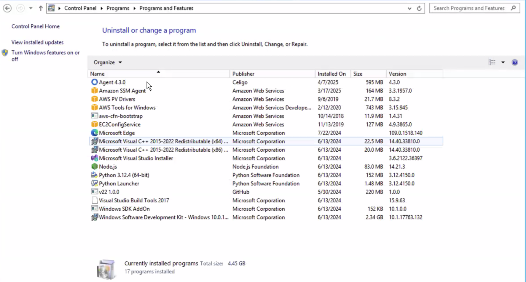

To uninstall the existing Celigo agent:
Log in to the server using an account with administrative privileges.
Search for and open the Control Panel.
Use the shortcut
Win + Rto open the search function. -
Click → .
Scroll through the list to find the agent.

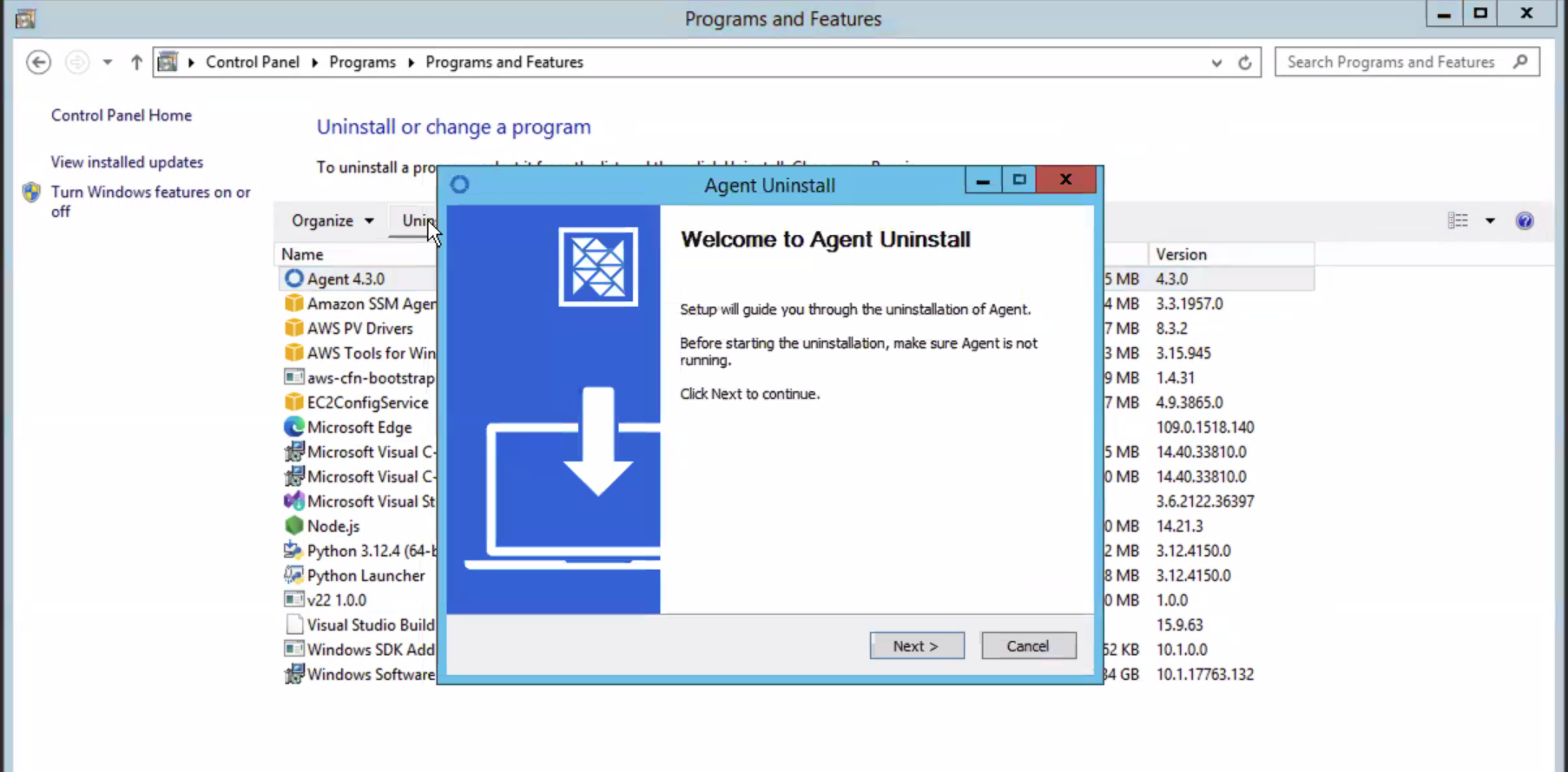

The agent is usually at the top of the list since it's called "Agent." Remember to stop the agent before you uninstall it.
Right-click the agent and click Uninstall.
Follow the on-screen instructions to complete the process.

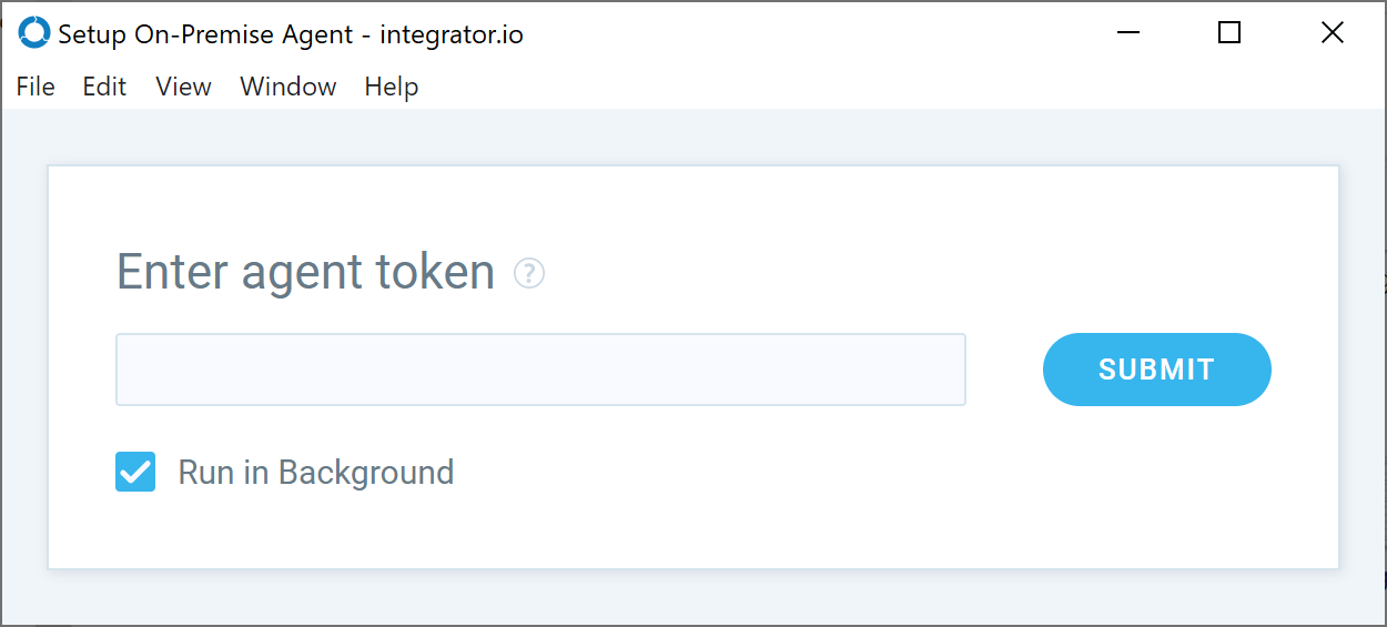

The Agent shortcut is added to your desktop and Windows programs, and the software opens to ask you for an integrator.io token.

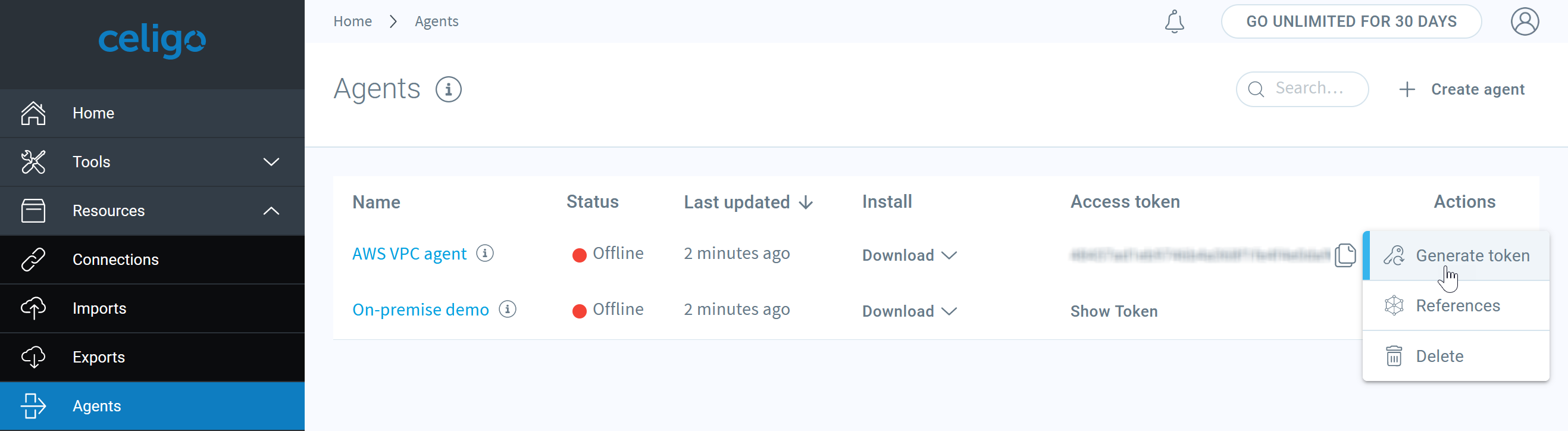

An access token secures communication between the agent and integrator.io. Your agent token was automatically generated when you initially created the agent through integrator.io. In this case, you'll be copying the agent token you already had in use.
To find the token:
Return to integrator.io and navigate to Resources → Agents.
In the list of agents, click Show token.
Click Copy (
) next to the unmasked access token to copy it to your clipboard.
In the agent software, enter the access token. The agent will automatically start communicating with integrator.io.

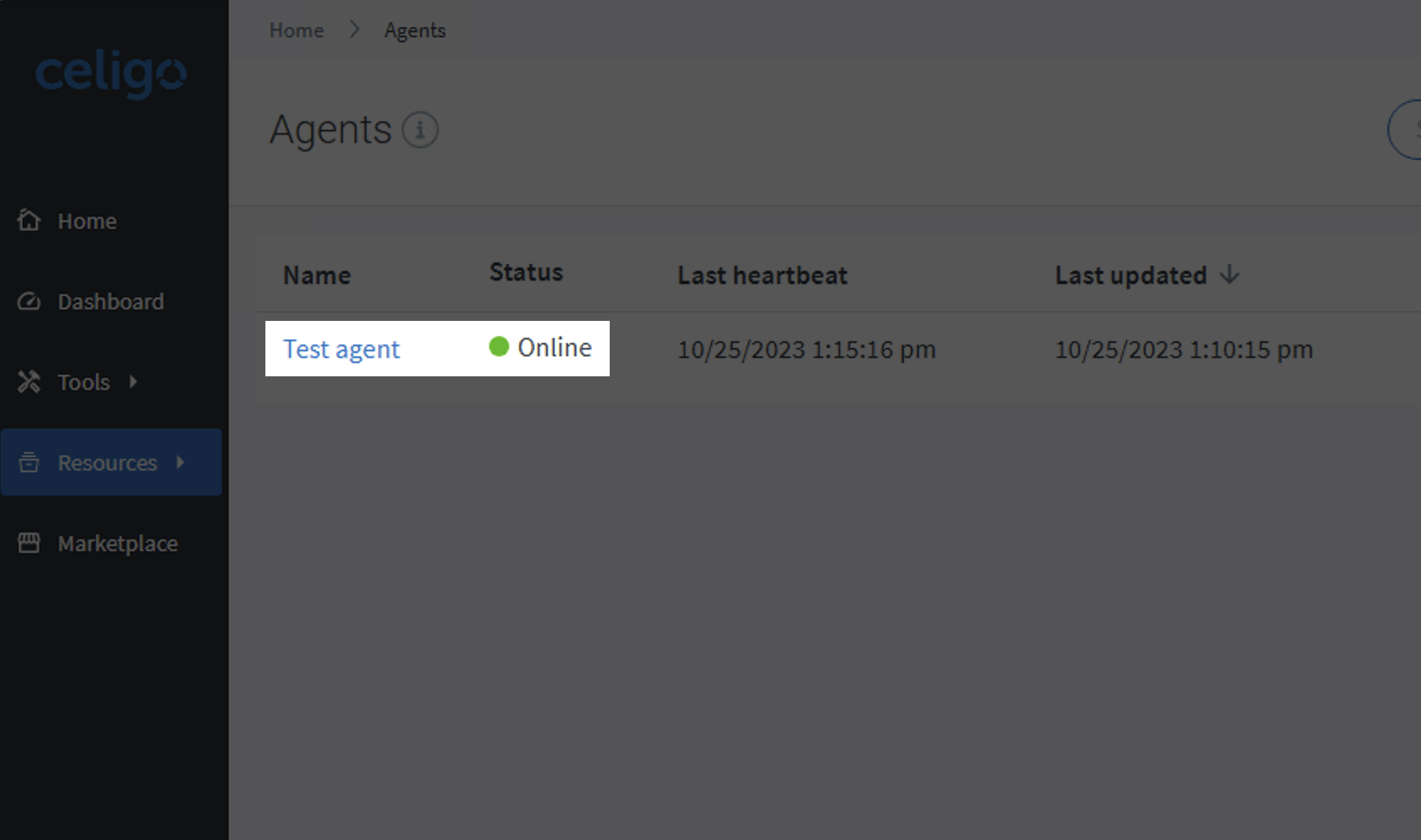

The agent should now be online. You may have to refresh the page to validate that it’s online.
If your token is compromised, you can generate a new token:
This will automatically revoke the old token, so you must enter the new one.

Confirm that all flows are running.
