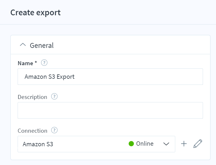

From the Application drop-down list, select Amazon S3 and your available Amazon S3 connection.
Edit Amazon S3 export details
Name (required): Provide a clear and distinguishable name. You will have the option to choose this export throughout integrator.io, and a unique identifier will prove helpful later when selecting among a list of imports that you’ve created.
Description (optional): Describe your export so that you and others can quickly understand its purpose. Be sure to highlight any nuances that a user should be aware of before using this import in a flow. As you make changes to the resource, be sure to keep this description up to date.

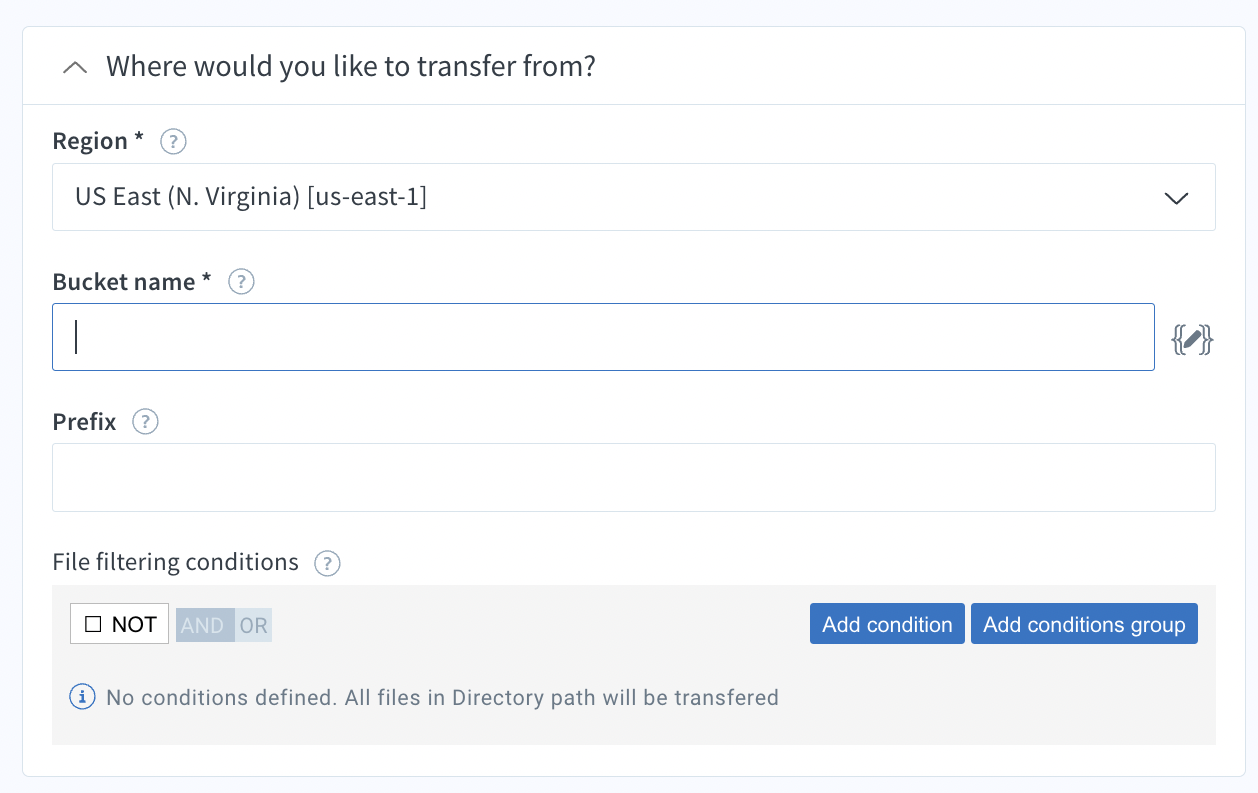

Where would you like to transfer files from?
Region (required): Select the name of the Amazon S3 location where the request is being made. If not set, this field defaults to US East (N. Virginia) [us-east-1].
Bucket name (required): Specify the top level Amazon S3 folder. Amazon S3 bucket names cannot contain forward slashes or nested folder structures. If you have a nested folder structure in the bucket (such as folder1/subfolderA/topic1), the bucket name is folder1. Enter the remaining subfolderA/topic1 in the Key starts with field. Click the pencil icon to the right of this field to create a handlebars template for bucket names.
Prefix: Enter the prefix (similar to a folder structure within the Amazon S3 bucket) to transfer only the files contained in that location. For example, if the full path is "BucketName/Project/WordFiles/", then a prefix is "Project/WordFiles/". Partitions within the prefix support up to 3,500 PUT/COPY/POST/DELETE and 5,500 GET/HEAD requests per second. If left blank, all files will be picked for transfer. Refer to Amazon S3 documentation for more details.
File filtering conditions: See Create file filtering conditions for FTP exports.

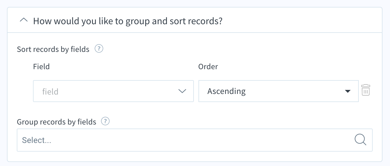

How would you like to group and sort records?
Sorting and grouping allows you to manage your flow’s files by sorting and grouping records by field. This feature gives you the ability to group records by field (column1, column2, column3…), and sort the records in ascending or descending order (ASC or DESC).

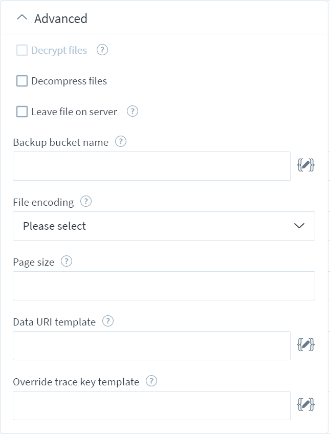

Advanced
Decrypt files: This option is enabled if your connection is configured to use PGP encryption/decryption.
Decompress files: Set this field to True if you're exporting compressed files.
Leave file on server: If you set this field to True, the import will not delete files from your FTP server after your export completes. The files will stay on the FTP server, and if the export process runs again, the same files will be exported again.
Backup files path: Enter a value relative to the root directory, if you want to archive a copy of the exported files. For example, to have integrator.io store a copy of the exported file at ftps://ftp.my-site.com/integrations/backup, enter /integrations/backup. This path must already exist on the server.
File encoding: The file encoding indicates how the individual characters in your data are represented on the file system. Depending on the data source, the encoding can vary. If left blank, the default encoding is UTF-8. See File transfers to learn more about the different file encoding types.
Page size: Specify how many records you want in each page of data. The default Page size value (when you leave this field blank) is 20.
Data URI template: This field ensures that all the errors in your job dashboard have a link to the original data in your FTP server. This field uses handlebars templates to generate dynamic links based on the exported data. For example, if you are exporting a CSV file, this field could include one or more columns from the file, such as {{{internal_id}} or {{{email}}}.
Override trace key template: (optional): Define a trace key that integrator.io will use to identify a unique record. You can use a single field such as {{{field1}}} or use a handlebar expression. For example, this syntax {{join “_” field1 field2}} will generate a trace key template field1_field2. When this field is set, you will override the platform default trace key field.
