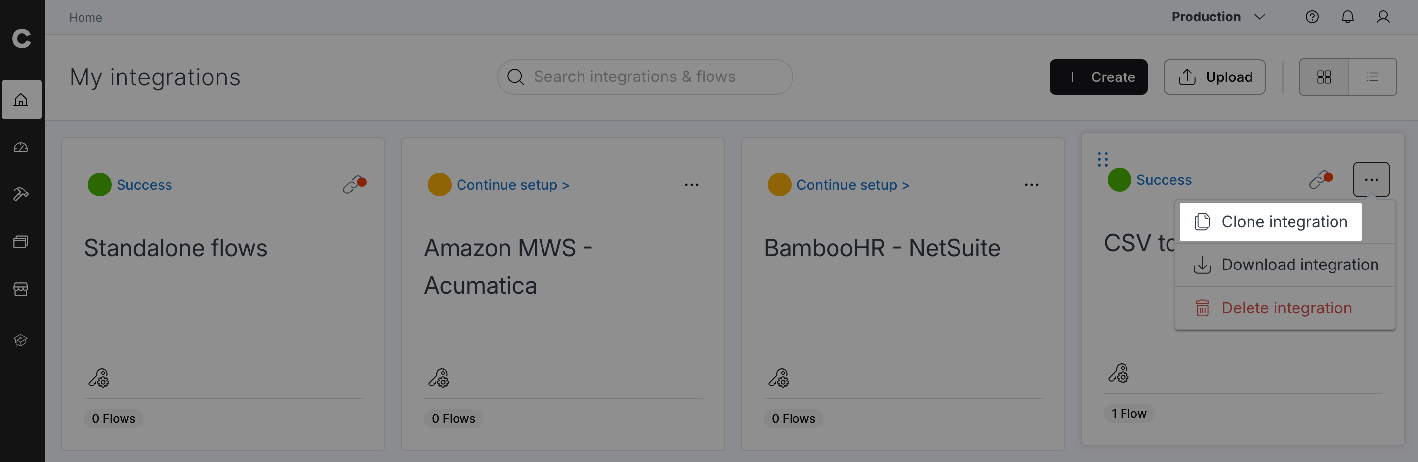

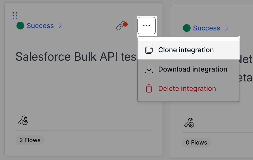

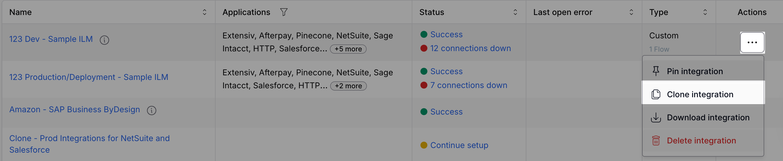

    1. Tile view: Click the overflow (...) menu in the upper-right corner of the tile and select Clone integration.

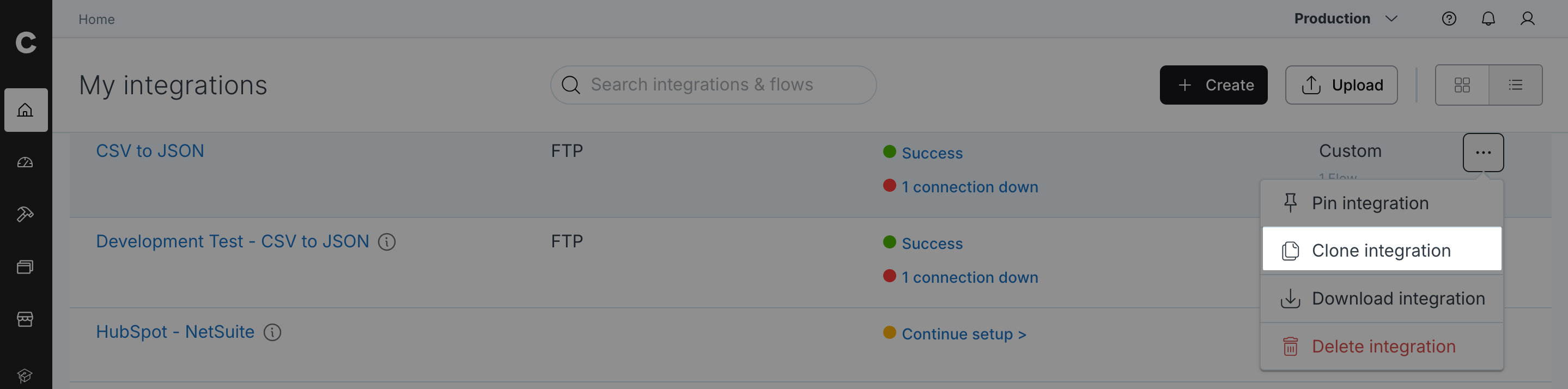

    2. List view: In the Actions column, select Clone integration from the overflow (...) menu.

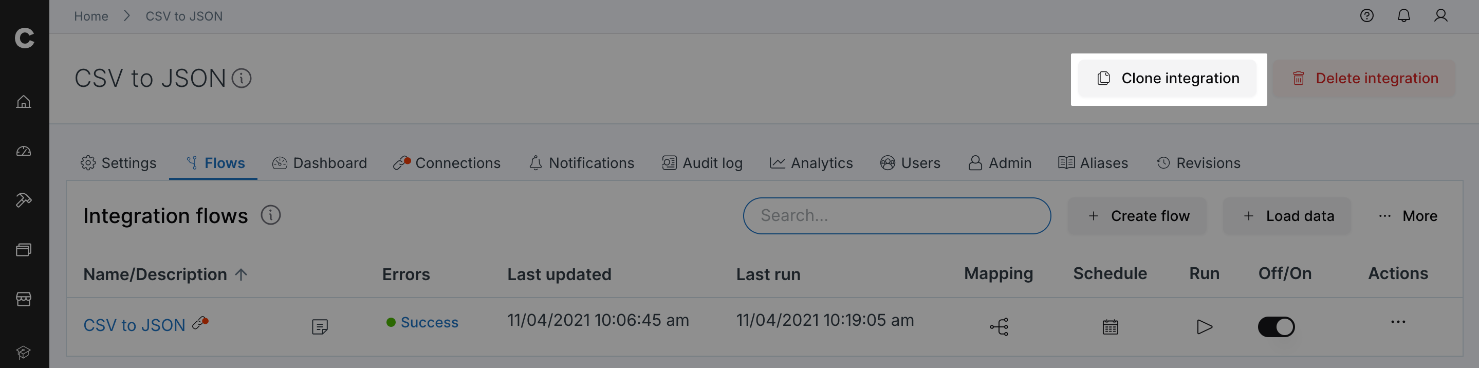

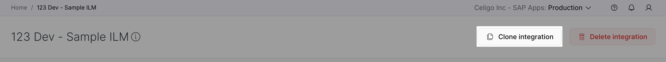

    3. Integration dashboard: Click Clone integration.

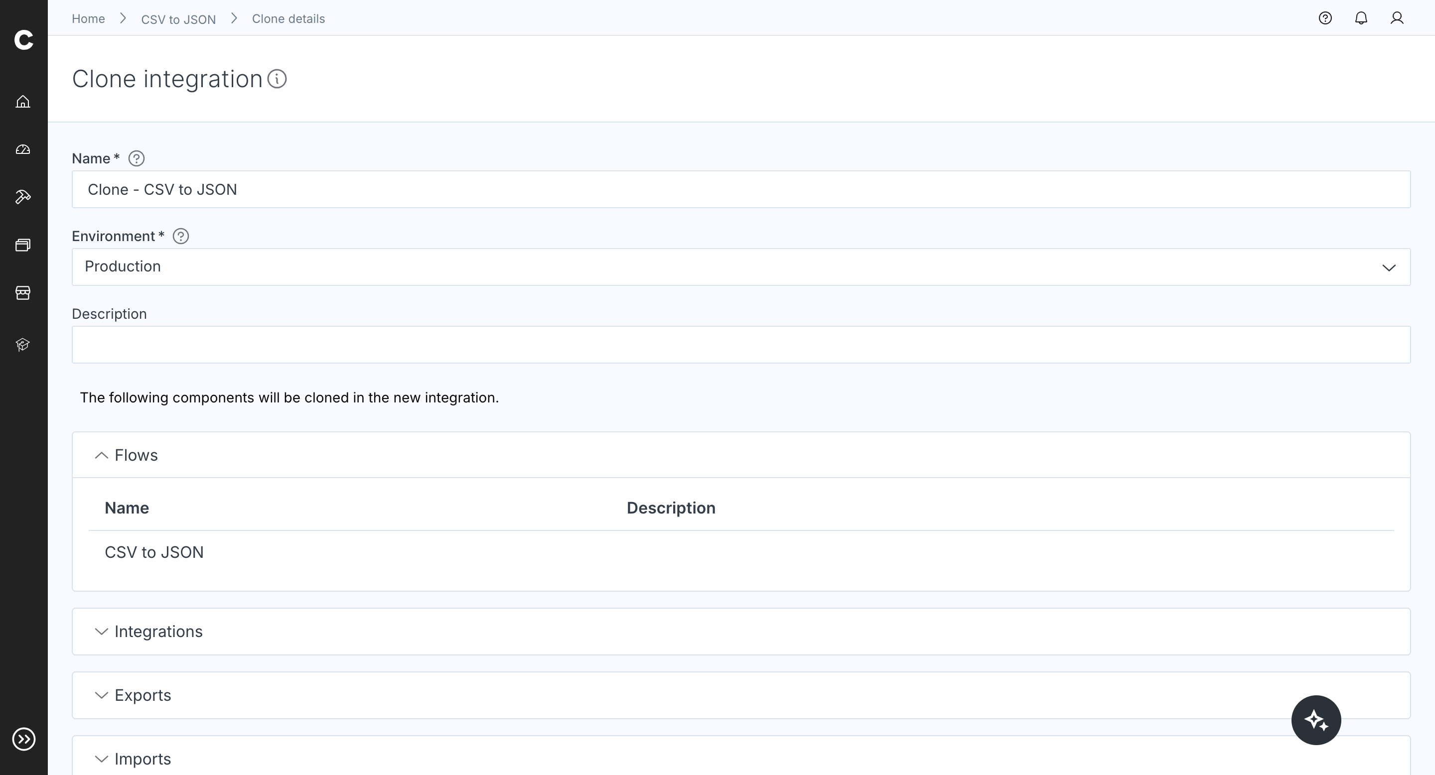

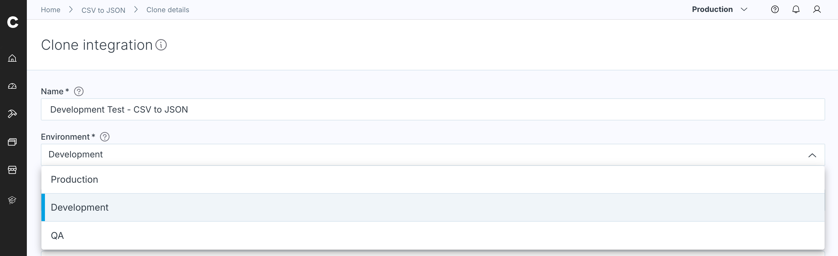

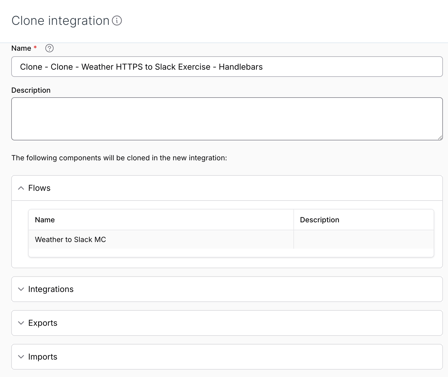

  4. In the Clone integration page, enter details.
    1. Name: Enter a unique name for the clone. Make sure that it is unique enough that you can identify it later. You can always rename your integration tile or flow outside of the cloning process.

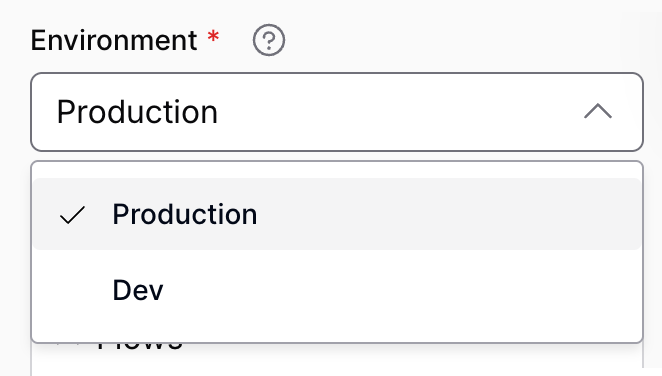

    2. Environment: Select your environment. Only active environments you have Manage access to (or above) are visible. After cloning to a new environment, you must complete the setup steps; however, you can choose to complete the setup later. Learn how to use multiple environments.
  5. Review the list of all items contained within the new integration. This includes flows, APIs, and any other integration components.
  6. Click Clone integration at the bottom of the list of cloned integration components.

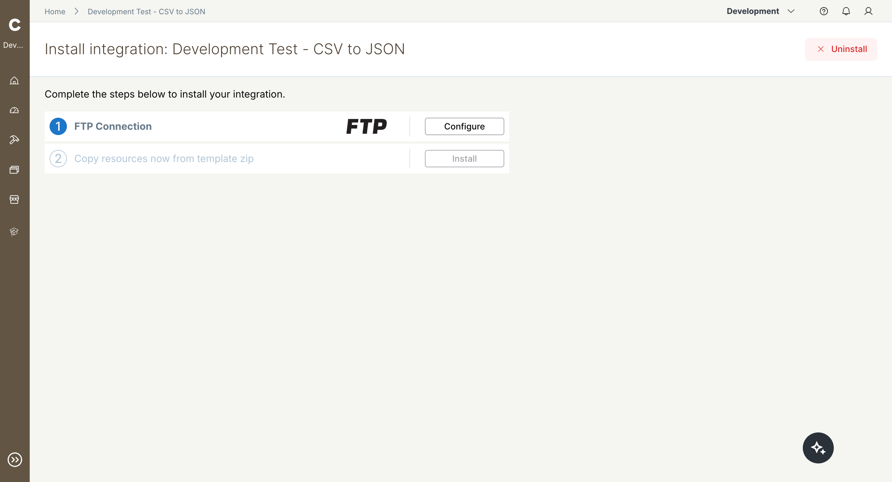

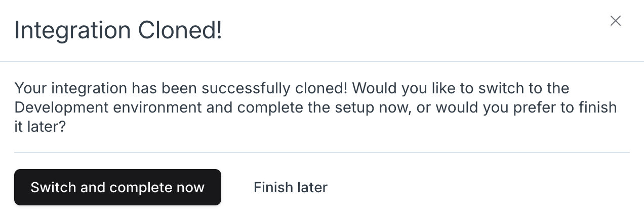

  7. If you've successfully cloned your integration, you'll see a success message asking if you'd like to configure your cloned integration now or later. If you've cloned to a different environment, you'll be asked if you want to switch to that environment to configure the integration. Your cloned integration will contain all flows and APIs from the original.
Configure the cloned integration

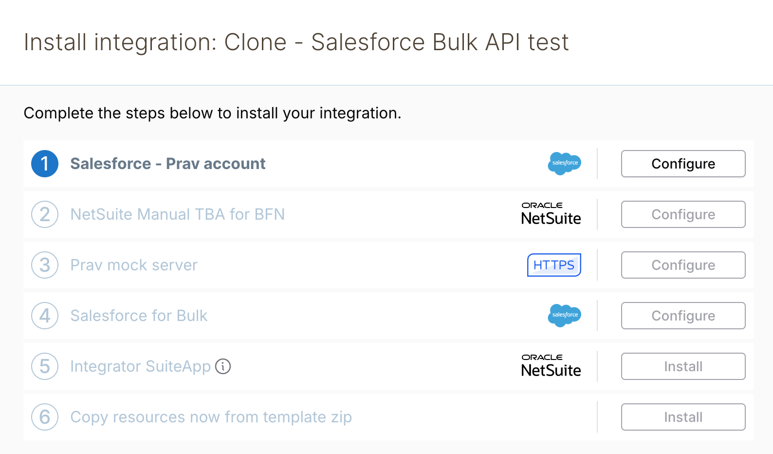

After cloning, you must configure connections for the cloned integration — connections are not copied from the original. If the cloned flows and the original flows remain in the same environment, the Celigo platform preselects the connection used in the original flows during cloned flow configuration. If the cloned integration is moved to a different environment than the original, then you can select existing connections during flow configuration (or create new connections).
For each connector, click the Configure link, then provide the requisite information for the connection and test your connection. See Connector solutions for help setting up connections for particular connectors.
