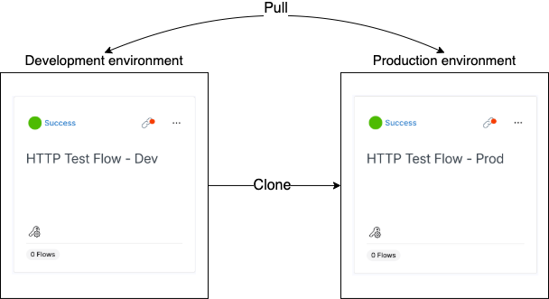

In Integration Lifecycle Management (ILM), a pull revision promotes tested changes from one integration into a directly related clone — for example, from a development integration into Production. This article is for integration builders who move changes between clones or environments. Use a pull to promote changes through your environments, keep clones in sync, or incorporate changes made in one clone into another. The process has three stages: create the pull, review the changes in the Review changes panel, and merge. This article also covers how to identify and resolve conflicts when they arise during review.

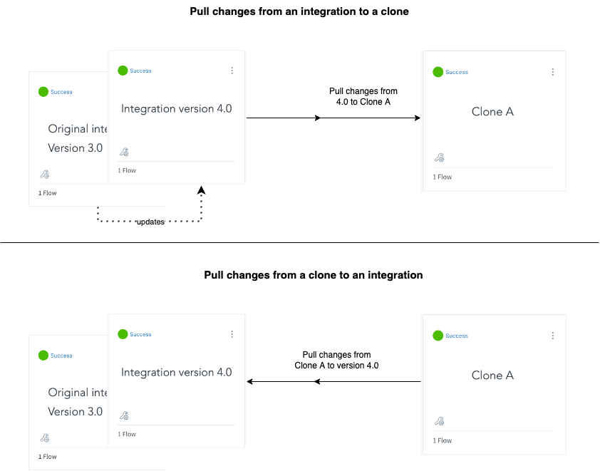

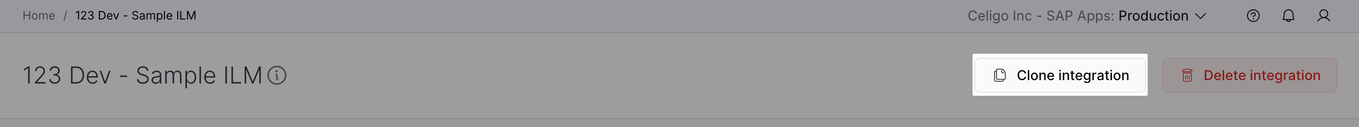

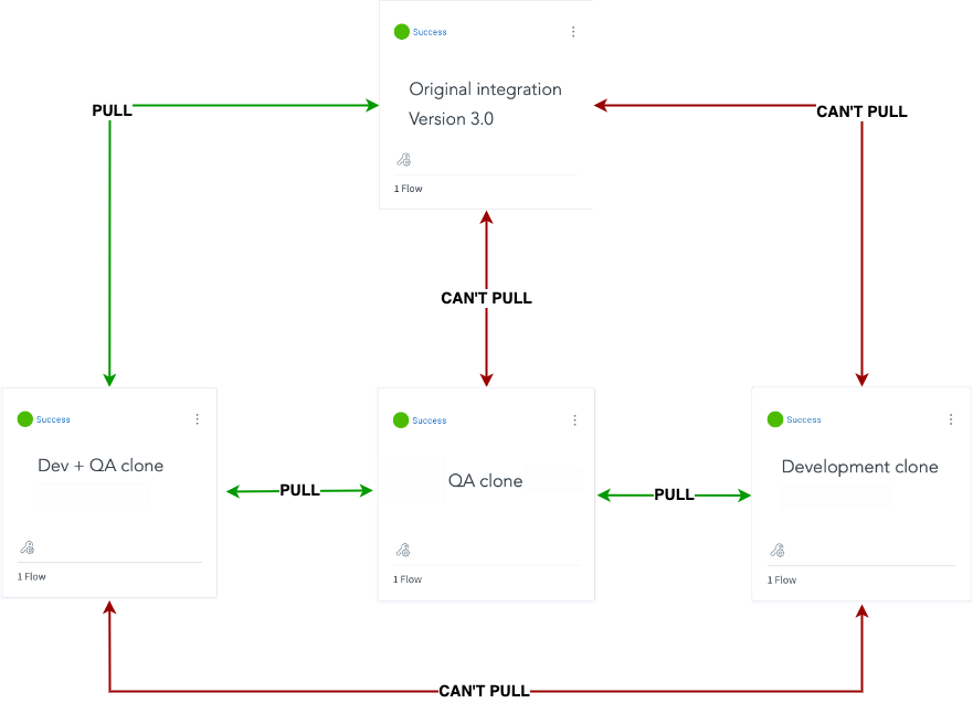

- The integration you want to pull from is a direct clone of the current integration, or the current integration is a direct clone of it. You can pull only between directly related integrations — not across two separately created clones. A clone installed from a ZIP file isn't linked to the original integration, so you can't pull between them. To create a clone, see Clone an integration for Integration Lifecycle Management (ILM).

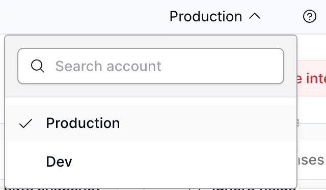

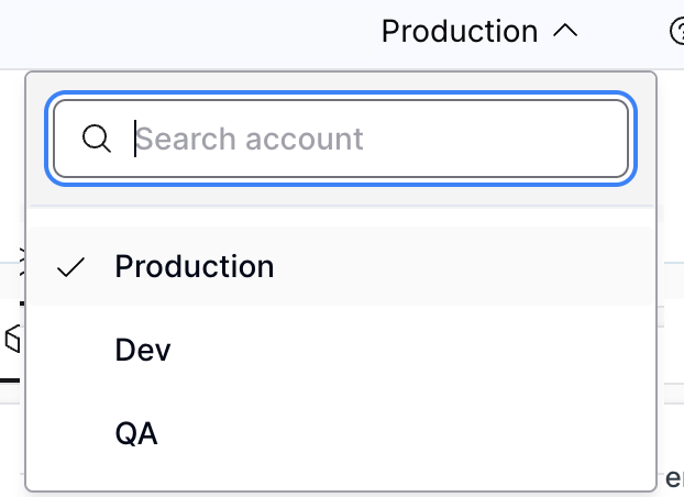

- Select an environment at the top of the page.

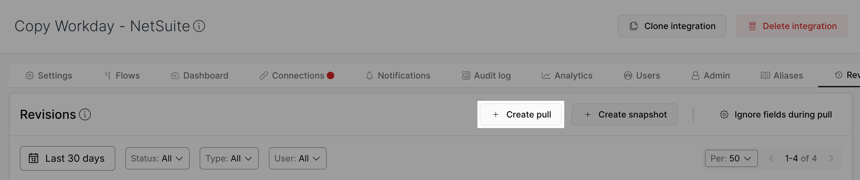

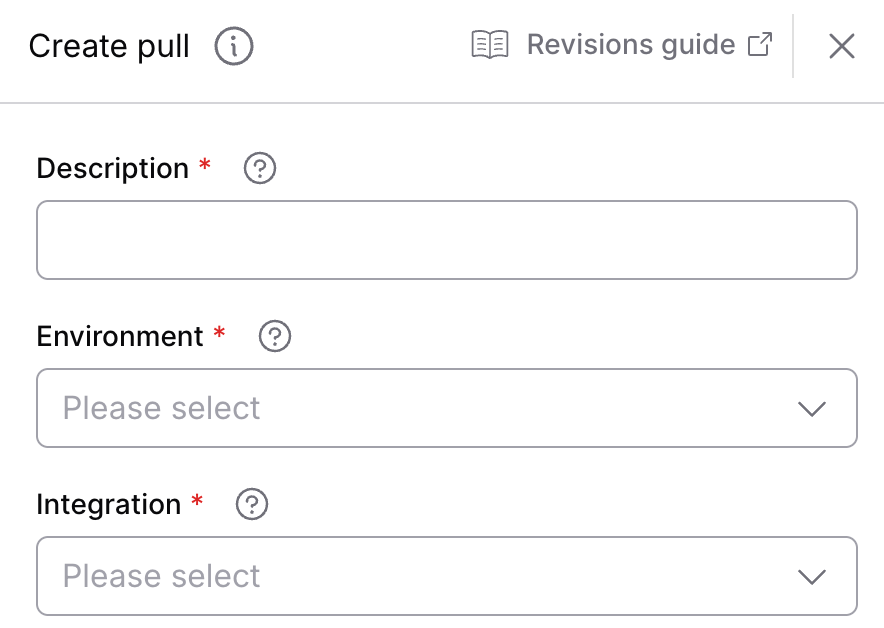

Select Revisions > Create pull.

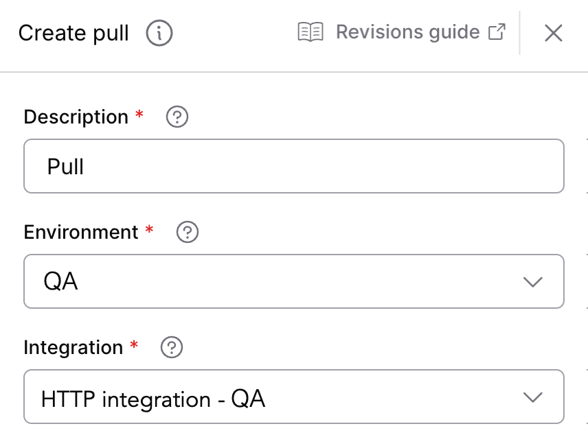

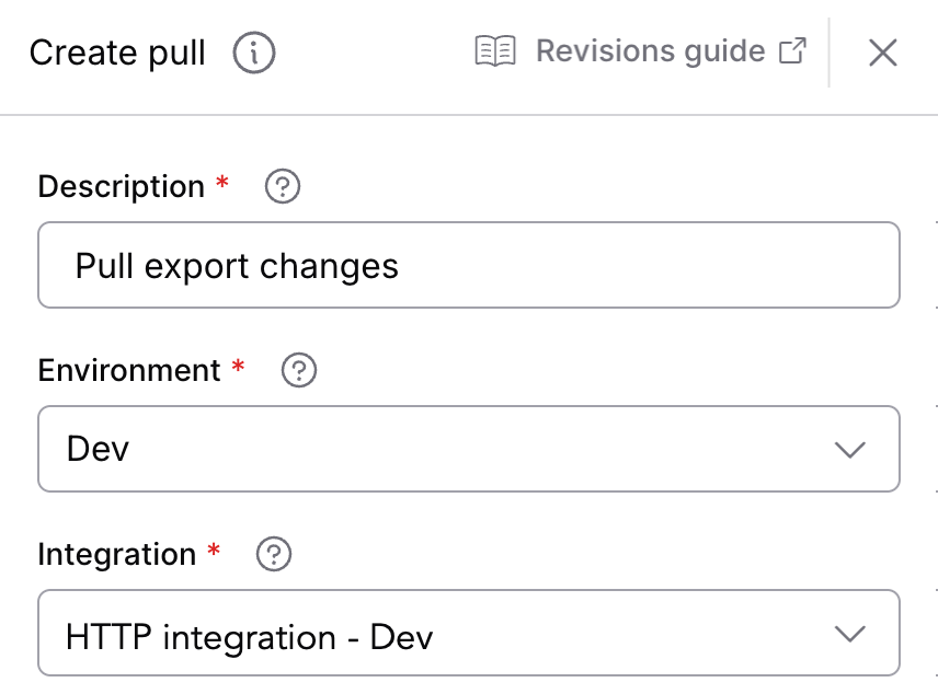

- In the Create pull panel, complete these required settings:
- Description — Enter a pull description.
- Environment — Select the environment that contains the integration you're pulling changes from.
- Integration — Select the integration you want to pull changes from (your remote integration).
Note: You can pull from an original integration to a clone, or from a clone to its original.
Note: If your integration contains an API and you pull across environments, add version to the ignore list in Ignore fields during pull first; see API version difference blocks a pull.
Note: When you create a pull for an integration that contains a real-time export with authentication, you enter its credentials the first time. See Webhook credentials.

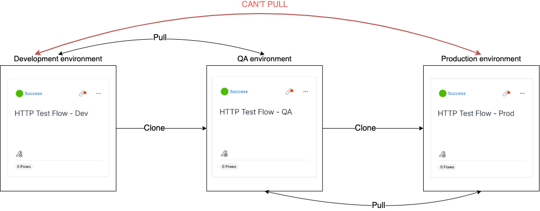

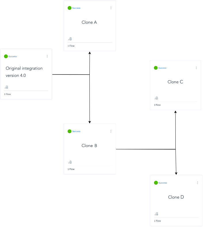

- Pull relationships are direct only. You can pull only between directly related integrations. For example, if you clone Original to create A, clone A to create B, and clone B to create C, you can pull between Original and A, A and B, or B and C — but not between Original and B, or Original and C.
To plan pulls across Development, QA, and Production, see Developing with integration lifecycle management.
