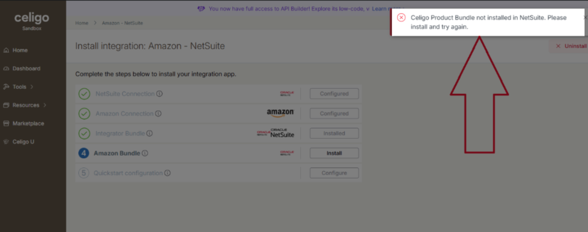

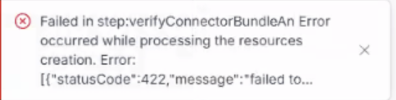

You may see the error "Celigo Product Bundle not installed in NetSuite. Please install and try again" during setup or verification of a new integration. This error may appear even if the Celigo Product Bundle is already installed in NetSuite.
Error message: “Celigo Product Bundle not installed in NetSuite. Please install and try again.”
Reason: The error typically occurs if the Celigo NetSuite Connector Utility Restlet script is not in the correct deployment state (i.e., not marked as "Released" or not deployed).

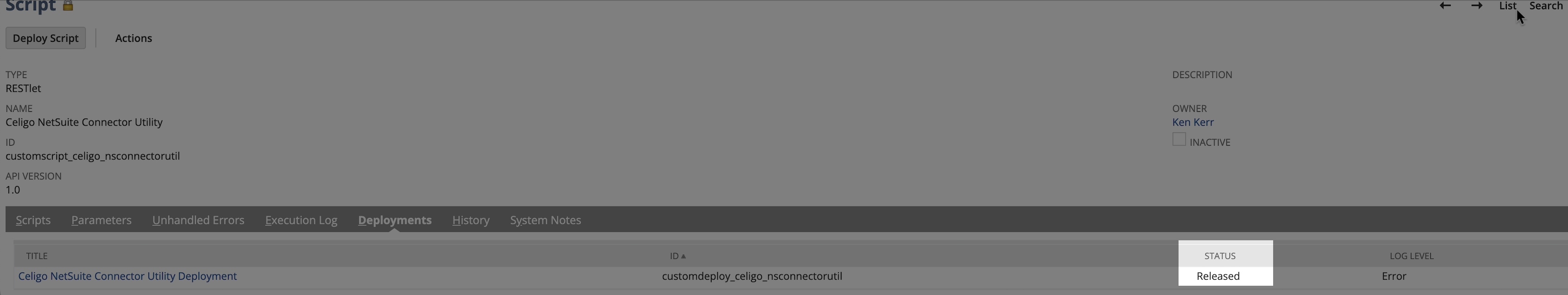

  2. Navigate to Script Deployment

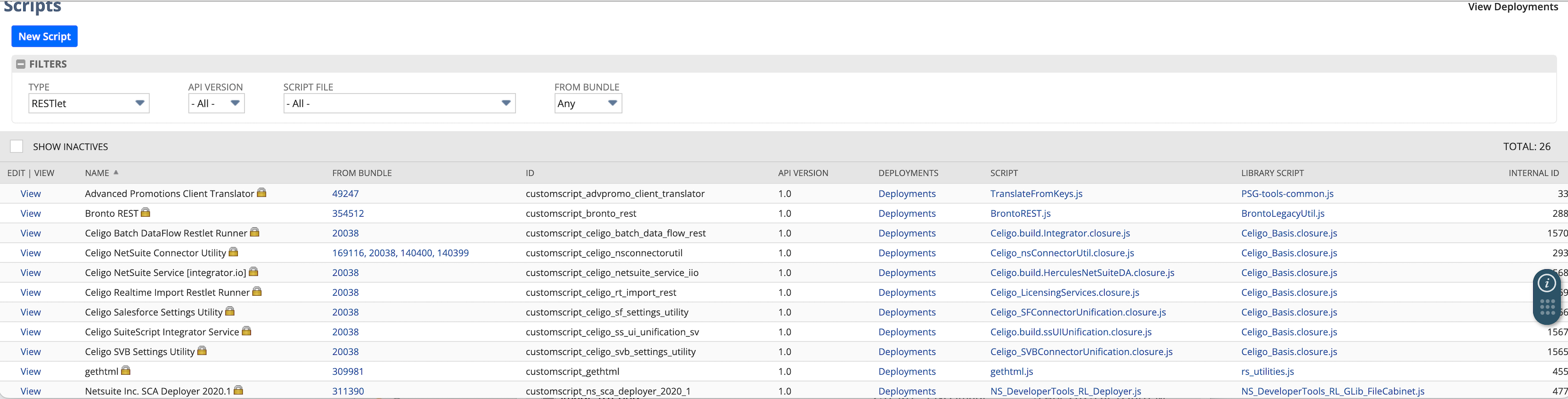

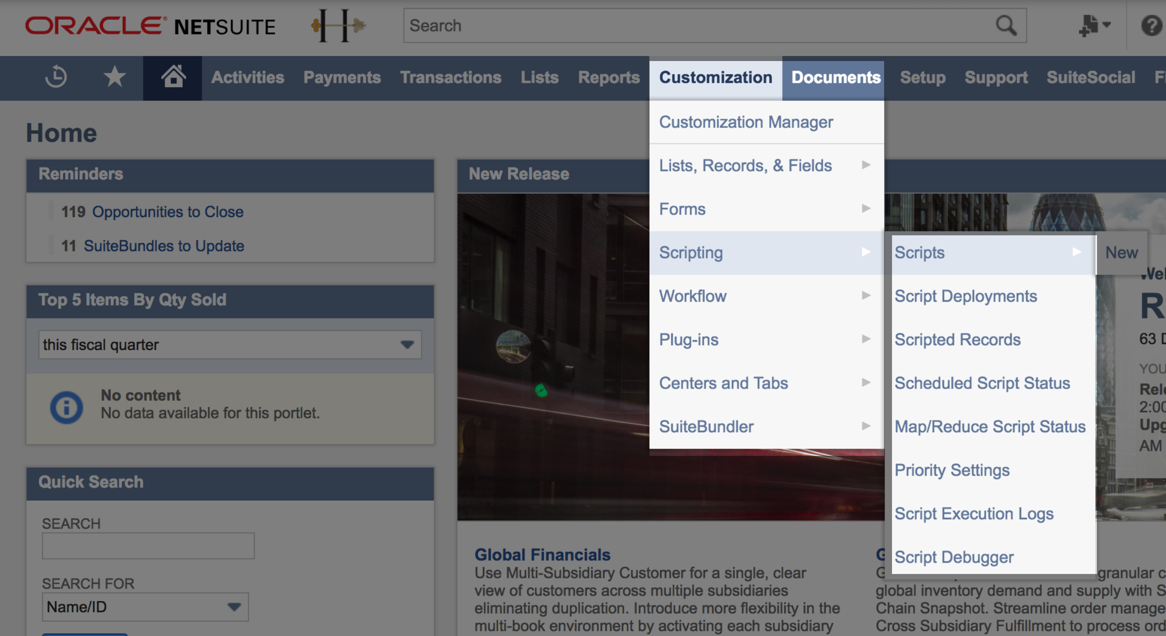

    • Go to: Customization > Scripting > Scripts
    • In the Filters > Type, search for: Celigo NetSuite Connector Utility
    • Locate the script and click View to open it.

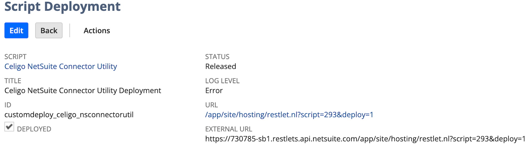

  3. Check Deployment Status
    • In the script record, go to the Deployment sub-tab
    • Verify that:
      • The Deployed checkbox is selected
      • The Status is set to Released
    Once corrected: Retry the integration setup or refresh the bundle verification process. If the script is correctly deployed and in a Released state, the error should no longer appear.
