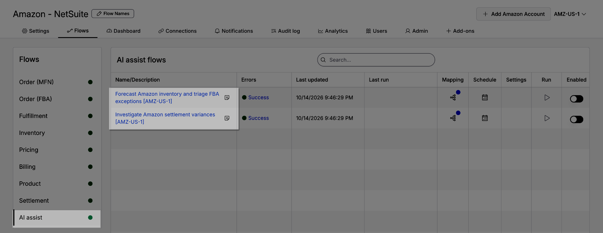

Find the AI assist flows in integrator.io
The AI assist flow group lists the two AI assist flows for the selected store, where you turn them on, schedule them, and run them.
- Go to Home.
- Select the Amazon - NetSuite integration app tile.
- In the store list of the integration app, select your Amazon store.
- Select the Flows tab.
- In the Flows list, select AI assist.
The AI assist flows page lists the two flows for the selected store. The store name appears in brackets at the end of each flow name. The Schedule column shows a schedule icon for both flows.
To open a flow in the flow builder, select its name. The flow builder shows the flow steps, the Enabled toggle, Run, Schedule, and the Run history tab.
Turn on the flows
Both flows are turned off by default. Review the AI assist settings first, and then turn on each flow you want to use: on the AI assist flows page, select the toggle in the Enabled column for that flow.
Run the flows
Run a flow in either of these ways:
- On a schedule: On the AI assist flows page, select the schedule icon in the Schedule column, or open the flow and select Schedule. Set how often the flow runs, and save the schedule. A daily schedule suits most stores: the sales-event research runs once per store, per marketplace, per day, and Amazon refreshes the FBA Manage Inventory Health report about once a day.
- On demand: On the AI assist flows page, select the Run icon, or open the flow and select Run.
To follow a run, open the flow. The Run console shows each step's status and its Success, Ignored, Errors, and Auto-resolved counts. To review earlier runs, select the Run history tab.

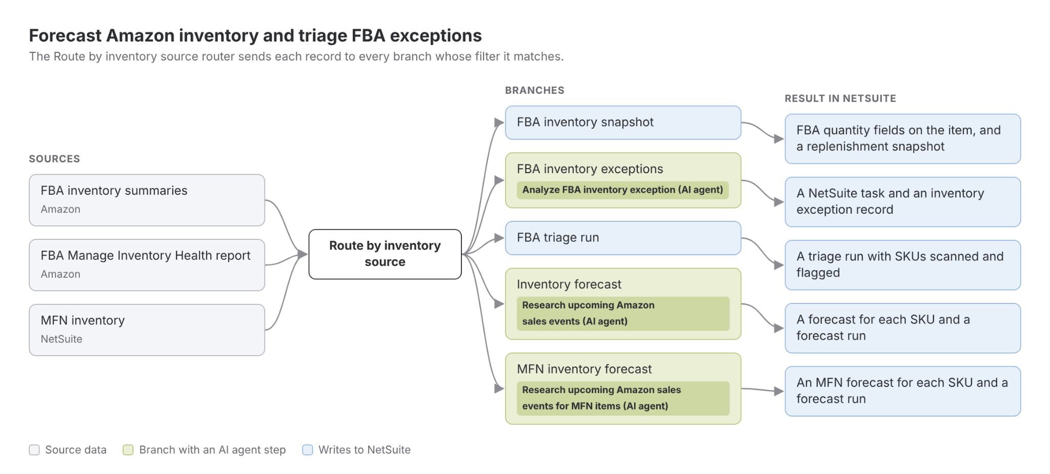

Forecast inventory and triage FBA exceptions
The Forecast Amazon inventory and triage FBA exceptions flow reads three sources: the FBA inventory summaries and the FBA Manage Inventory Health report from Amazon, and the store's NetSuite inventory for MFN items. The Route by inventory source router sends each record to every branch whose filter it matches.
| Branch | What it processes | Result in NetSuite |
| FBA inventory snapshot | Every SKU from the FBA inventory summaries. | Writes the fulfillable, unfulfillable, reserved, inbound, and total quantities to the item's FBA fields, and adds a replenishment snapshot. |
| FBA inventory exceptions | SKUs whose fulfillable quantity is at or below the Fulfillable quantity threshold (units) setting, or that have unfulfillable units. | The AI agent explains each exception. The flow creates a NetSuite task and adds or updates an inventory exception record. |
| FBA triage run | One summary per page of FBA inventory summaries. | Logs how many SKUs were scanned and flagged. |
| Inventory forecast | The FBA Manage Inventory Health report. | Reuses the sales events researched earlier that day, or researches them if none exist. Writes a forecast for each SKU and a forecast run. |
| MFN inventory forecast | The store's Amazon-linked NetSuite items, with the units each item sold from every sales channel at the store's inventory locations. | Researches events in the same way, and writes MFN forecasts and a forecast run. |
The FBA quantity fields on the NetSuite item are the only fields AI assist writes on standard NetSuite records. The flow updates existing items only: if an Amazon SKU has no matching NetSuite item, the run shows an error for that SKU. See: A SKU has no matching NetSuite item.

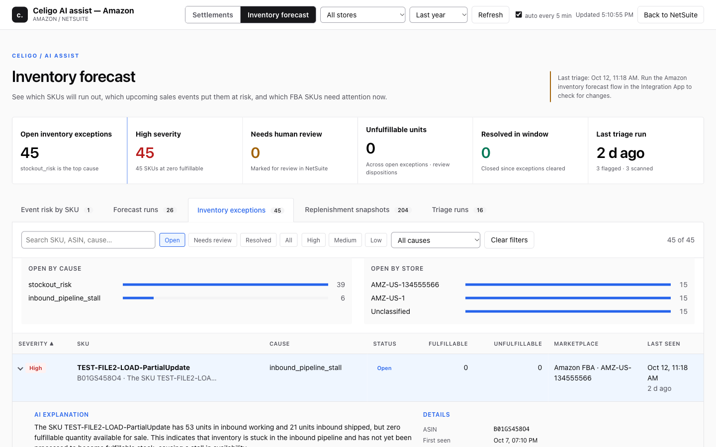

FBA exception causes and severity
Each flagged SKU gets one likely cause. The flow checks the rules in this order and uses the first one that matches:
| Likely cause | When it applies |
| inbound_pipeline_stall | No fulfillable units are left, but units are inbound. |
| unfulfillable_units | The SKU has unfulfillable units that can't be sold or shipped. |
| reserved_spike | No fulfillable units are left, but units are reserved. |
| stockout_risk | The fulfillable quantity is at or below your threshold. |
| Severity | Meaning |
| High | Out of stock, with or without units inbound. |
| Medium | At or below the fulfillable quantity threshold. |
| Low | Only unfulfillable units. |
When the AI agent isn't confident about the likely cause, the exception is marked Needs human review.
For each exception, the flow creates a NetSuite task titled, for example, FBA inventory exception: SKU-123 (stockout_risk). The task lists the SKU's quantities, the likely cause, severity, confidence, explanation, recommended checks, and severity rationale. If the AI agent isn't available for a run, the task recommends standard checks instead: review replenishment plans and inbound shipments when the fulfillable quantity is 0, and review item dispositions and removals in Seller Central when unfulfillable units exist.

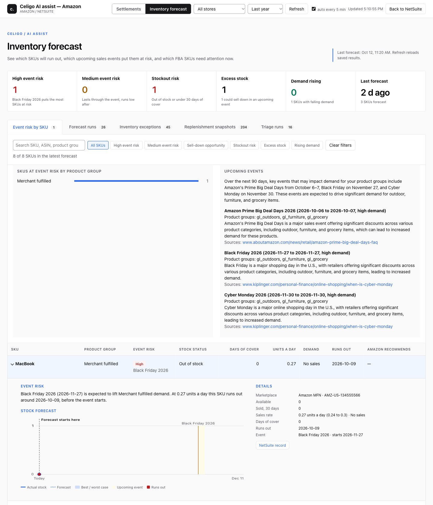

How the forecast works
The flow calculates these values for each FBA and MFN SKU:
- Sales rate and demand trend: A weighted daily sales rate (Units a day), and a demand trend of Rising, Steady, Falling, or No sales.
- Days of cover and runout date: How long the stock lasts at the current sales rate. Inbound units count as sellable only after a 14-day inbound lead time.
- Best and worst case: A range based on the Scenario range for forecast (%) setting.
- Stock status: Out of stock, Stockout risk (under 30 days of cover), Healthy, Excess, or No sales.
- Event risk: High, Medium, Opportunity, or None, with a short explanation (callout). Opportunity means an overstocked SKU with falling demand could sell down during the event. FBA SKUs also show Amazon's recommended action and ship-in quantity and date.
Examples of event risk callouts:
- High: At 0.27 units a day, this SKU runs out around 2026-10-09, before the event starts.
- High: About 40 units will be left when it starts, but the expected lift needs about 90.
- Medium: Stock should last through the event but runs low within two weeks after it.
- Opportunity: Demand for this SKU is falling, and it has excess stock, so the event is a chance to clear units with a deal or coupon.
Forecast flow steps
The flow builder and Run console show these steps, among others:
- Get FBA inventory summaries from Amazon
- Get FBA manage inventory health report from Amazon
- Get MFN inventory from NetSuite
- Post FBA inventory snapshot to NetSuite items
- Analyze FBA inventory exception (AI agent)
- Post FBA inventory exception summary to NetSuite tasks
- Post FBA inventory exception to Celigo AI assist records
- Post FBA replenishment snapshot to Celigo AI assist records
- Post FBA triage run to Celigo Amazon AI assist record
- Get today's Amazon forecast events from NetSuite
- Research upcoming Amazon sales events (AI agent)
- Post Amazon inventory forecast by SKU to Celigo Amazon AI assist record
- Post Amazon inventory forecast run to Celigo Amazon AI assist record
- Get MFN item sales from NetSuite
- Get today's Amazon MFN forecast events from NetSuite
- Research upcoming Amazon sales events for MFN items (AI agent)
- Post Amazon MFN inventory forecast by SKU to Celigo Amazon AI assist record
- Post Amazon MFN inventory forecast run to Celigo Amazon AI assist record

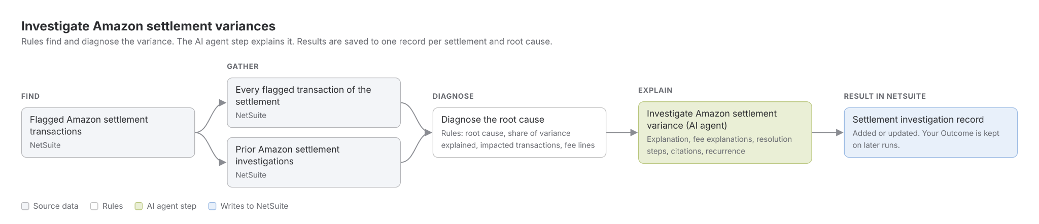

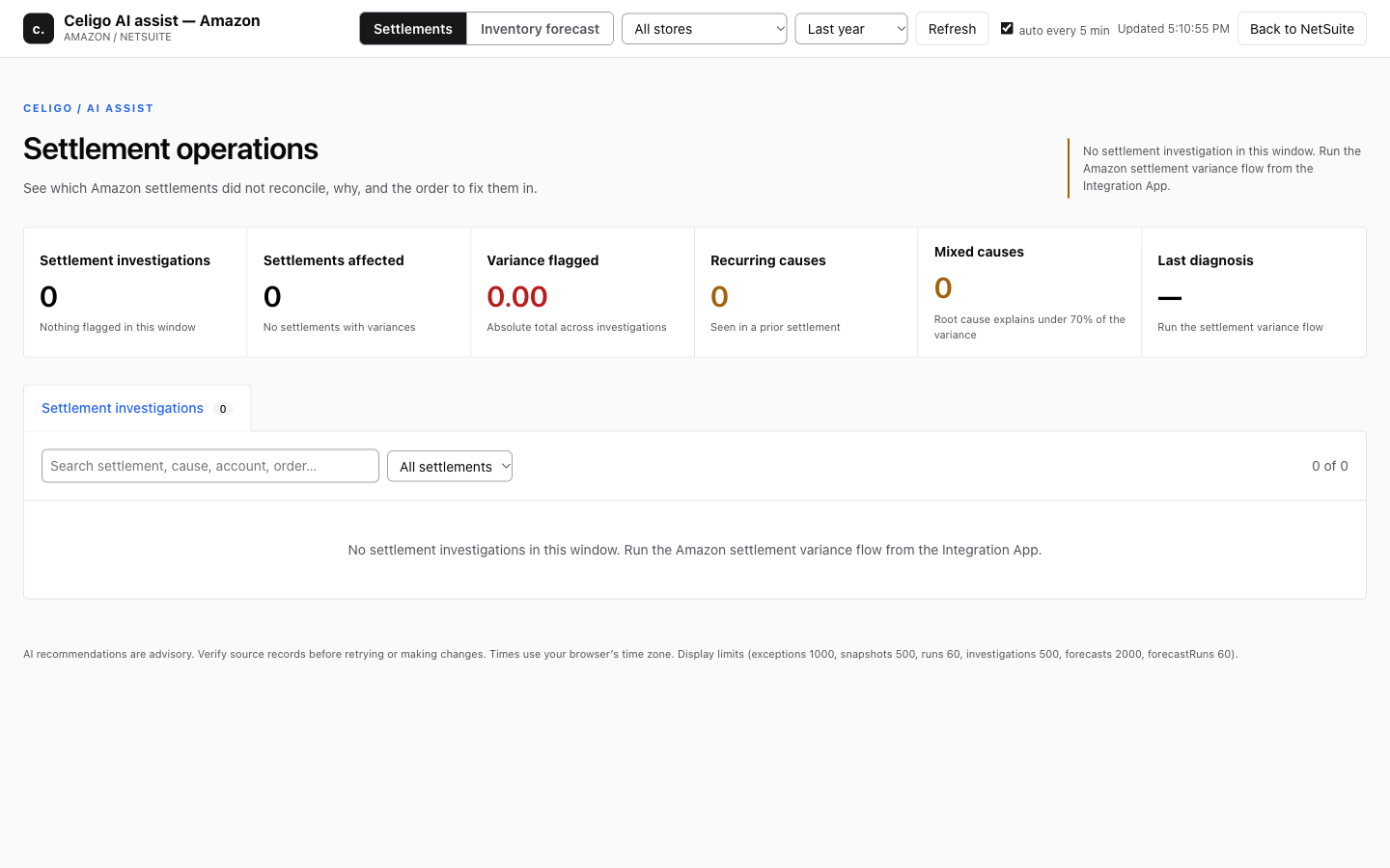

Investigate settlement variances
The Investigate Amazon settlement variances flow works on the settlement transactions that the integration app's settlement flows bring into NetSuite (see Understand the Amazon settlement reports and Sync your Amazon settlement report (manually or automatically)). It investigates Amazon settlements that don't reconcile and saves one settlement investigation record for each settlement and root cause.
Each run works through these steps:
- Find flagged transactions: Settlement transactions with a reconciliation status other than Applied, or with a variance above the Ignore reconciliation variances at or below (amount) setting, grouped by settlement.
- Read the whole settlement: The flow reads every flagged transaction of the settlement, even when the settlement continues on the next page.
- Diagnose: The flow totals the settlement and assigns a root cause (the cause with the largest unmatched amount), the share of the variance it explains, the impacted transactions, and the fee lines.
- Check earlier investigations: Earlier investigations for the same store show whether the cause has occurred before, so recurring causes are flagged.
- Explain: The AI agent writes the explanation, explains each fee from Amazon's documentation, and lists the steps to check, in order.
- Save: The flow adds or updates the settlement investigation record. The Outcome you set on a record is kept on later runs.

Settlement flow steps
The flow builder and Run console show these steps:
- Get flagged Amazon settlement transactions from NetSuite
- Get every flagged transaction of the Amazon settlement from NetSuite
- Get prior Amazon settlement investigations from NetSuite
- Investigate Amazon settlement variance (AI agent)
- Post Amazon settlement investigation to NetSuite

Inventory forecast view
The Inventory forecast view shows which SKUs will run out, which upcoming sales events put them at risk, and which FBA SKUs need attention now. It has five tabs:
| Tab | What it shows |
| Event risk by SKU | The latest forecast for each SKU, with the High event risk, Medium event risk, Stockout risk, Excess stock, Demand rising, and Last forecast metrics. Filter by High event risk, Medium event risk, Sell-down opportunity, Stockout risk, Excess stock, or Rising demand. The Upcoming events panel shows the events the AI agent found for the next 90 days, with sources. |
| Forecast runs | Each forecast run, with SKU counts by risk, the AI summary, and the upcoming events. |
| Inventory exceptions | FBA inventory exceptions with severity, likely cause, status, quantities, marketplace, and last seen time. Filter by Open, Needs review, Resolved, All, High, Medium, Low, and cause. |
| Replenishment snapshots | The FBA quantities captured on each run: fulfillable, unfulfillable, inbound (working, shipped, receiving), reserved, and total. |
| Triage runs | How many SKUs each run scanned and flagged. |
Expand a SKU on the Event risk by SKU tab to see the event risk callout, the stock forecast chart (actual stock, forecast, best and worst case, upcoming events, and the runout date), and details such as the sales rate, days of cover, runout date, and Amazon's recommendation. Select NetSuite record to open the forecast record.
On the Inventory exceptions tab, the metrics change to Open exceptions, High severity, Needs human review, Unfulfillable units, Resolved in period, and Last triage run, and the charts show Open exceptions by likely cause and Open exceptions by marketplace. Expand an exception to see the AI explanation, recommended checks, severity rationale, and details, with the Open in Seller Central and Open in NetSuite links.
Settlements view
The Settlements view, titled Settlement operations, shows which Amazon settlements didn't reconcile, why, and the order to fix them in. The metrics are Settlement investigations, Settlements affected, Variance flagged, Recurring causes, Mixed causes, and Last diagnosis.
The Settlement investigations tab lists each investigation with the Settlement, Root cause, AI explanation, Variance, Account, and Outcome columns. A Recurring badge marks a cause that also occurred in an earlier settlement. Search by settlement, cause, account, or order, or filter by settlement.
Expand an investigation to see:
- Where to fix: The steps to fix the settlement, with links to the right place in the integration app, for example, Import the missing Amazon orders on demand, Review the settlement flows and their errors, Review the settlement settings, Check marketplace and currency settings, and Review the settlement summary in NetSuite.
- AI explanation: Why the settlement doesn't reconcile.
- Amazon fees explained: For each fee, what it is, why Amazon charges it, what to do, and the sources.
- Resolution sequence: The steps to check, in order.
- Details: Settlement, Marketplace, Diagnosed, Evidence citations, Recurring, and Share of variance explained.
- Impacted transactions: Each settlement transaction with its Amazon order, type, reconciliation status, error, variance, the amount explained by the root cause, and the NetSuite transaction.
To import missing orders, select Copy order IDs, then select Open Order (FBA) settings or Open Order (MFN) settings. On the Orders tab, paste the IDs into Amazon order Id(s), select Save, and then run the settlement flow again. The on-demand import takes 50 IDs at a time, so only the first 50 IDs are copied. For more about the order flows, see Sync FBA orders and customers from Amazon to NetSuite and Sync MFN and SFP orders to NetSuite as sales orders.

AI assist flows don't appear
Symptom: AI assist isn't listed on the Flows tab of the selected store.
Cause: The AI assist add-on isn't installed for the selected store, for example, a store you added to an existing integration app.
Resolution: Install the add-on from the Add-ons tab. See Install the AI assist add-on.

The settlement flow finds no settlements
Symptom: The Settlements view shows No settlement investigations in this window. Run the Amazon settlement variance flow from the integration app.
Cause: The flow is turned off or hasn't run, the variance tolerance is too high, or the lookback period is too short to include older settlements.
Resolution: Turn on and run the settlement flow, check Ignore reconciliation variances at or below (amount) and Investigate settlements that ended in the last (days), and widen the dashboard time window.
