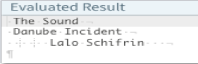

trim
This helper will remove (trim) any white space in a Trims whitespace characters present at the beginning and at the end of the string.
{{trim field}}
Use the trim field if you have white space that persists in your file across all values. Here, the whitespace is before the “artist” value as seen in the output like this:
The problem is also evident in the context below, and the example shown in the Template will resolve the white space issue in the output.
Template
Context
Output
{{trim library.artist}}
  "library": {
    "album": "The Sound",
    "title": "Danube Incident",
    "artist": " Lalo Schifrin"
Lalo Schifrin

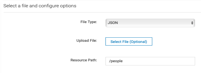

For the example below, in integrator.io, the [people] array must be referenced as an absolute path in the Resource path field. If the context was an object (name:value pair), then the path would not need to be set.
Also in this example, the semicolon and space between the expressions will allow spacing and punctuation between the variables on output.

#with
The #with helper demonstrates how to pass a parameter to your helper. When a parameter calls a helper, it is invoked with whatever context the template passed in. This allows access to nested objects in the context without having to repeatedly type the parent name in each expression.
Template
{{#with library}}{{title}} on "{{album}}" by {{artist}} {{/with}}
Context
  "library": {
    "artist": "Lalo Schifrin"
Output
Danube Incident on "The Sound" by Lalo Schifrin
