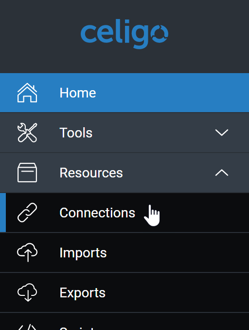

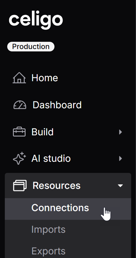

- Select Connections from the Resources menu.

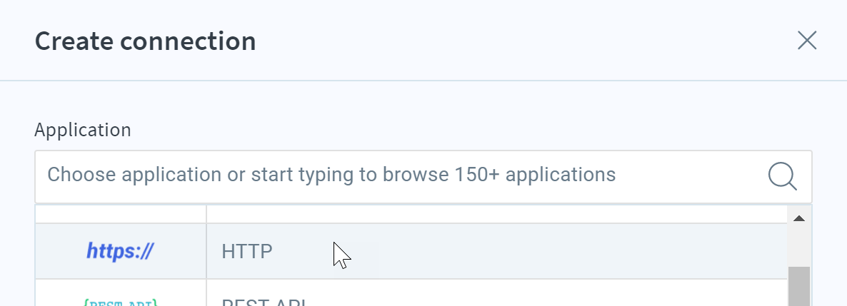

Next, click + Create connection at the top right. In the resulting Create source panel, select HTTP from the Application list, under the Universal connectors group.
- While working in a new or existing integration, you can add an application to a flow simply by clicking Add source or Add destination/lookup. From the Application list, under Universal connectors, select HTTP.
- After the HTTP Application is added, click the Connection setting’s + button to proceed.

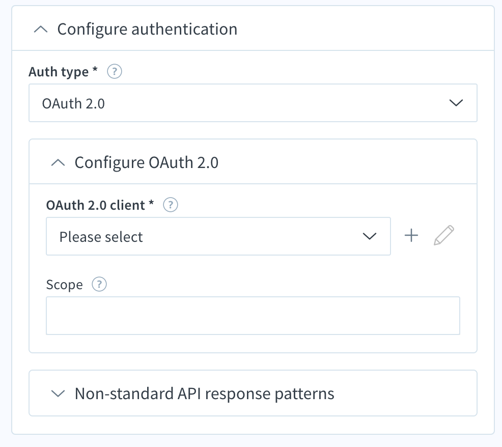

C. Edit OAuth 2.0 settings

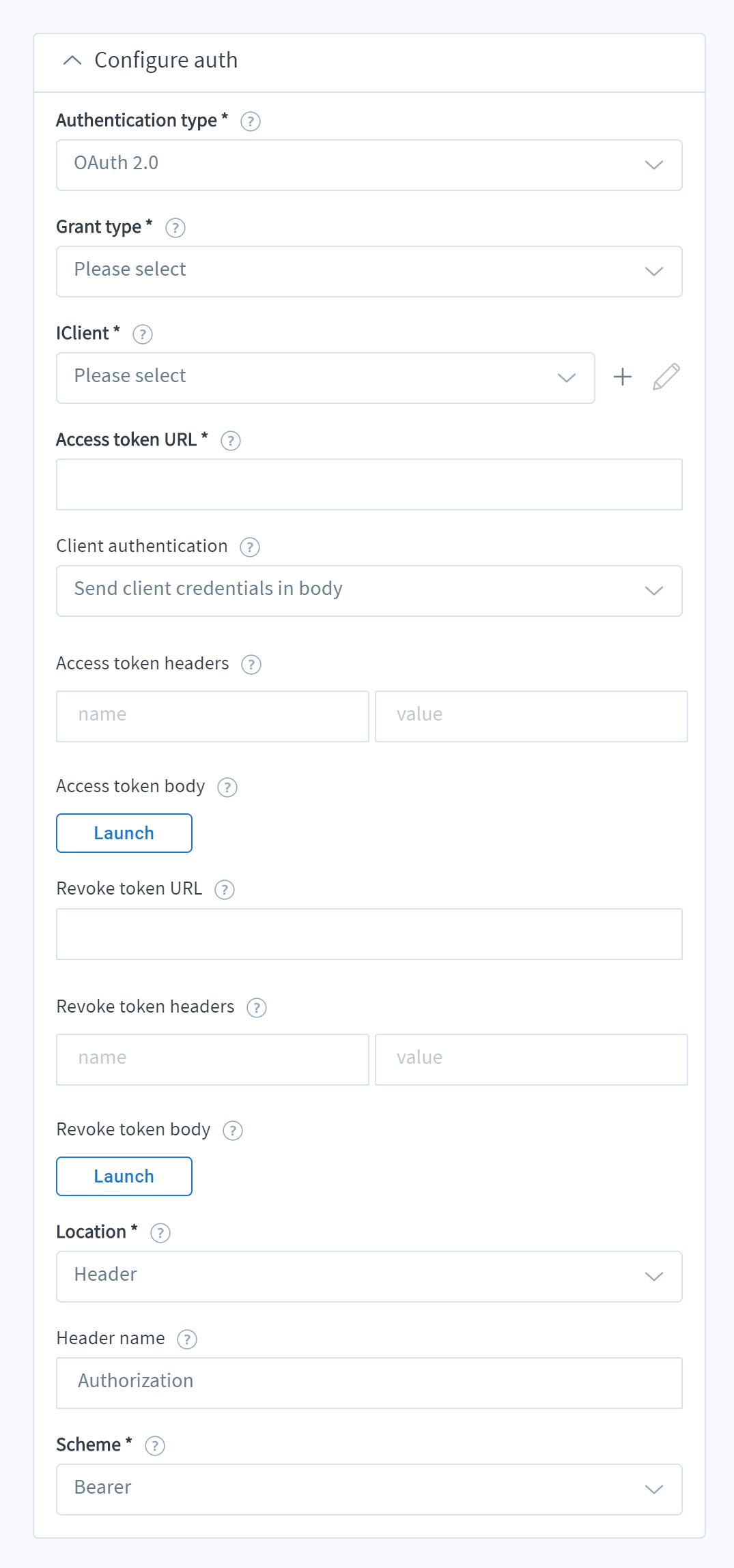

Continuing in the Create connection panel, select OAuth 2.0 for the Auth type. The settings then become specific to OAuth 2.0.
As with all universal API connections, the parameters are unique to the vendor’s conventions. Before proceeding, review the developer documentation and your account settings.

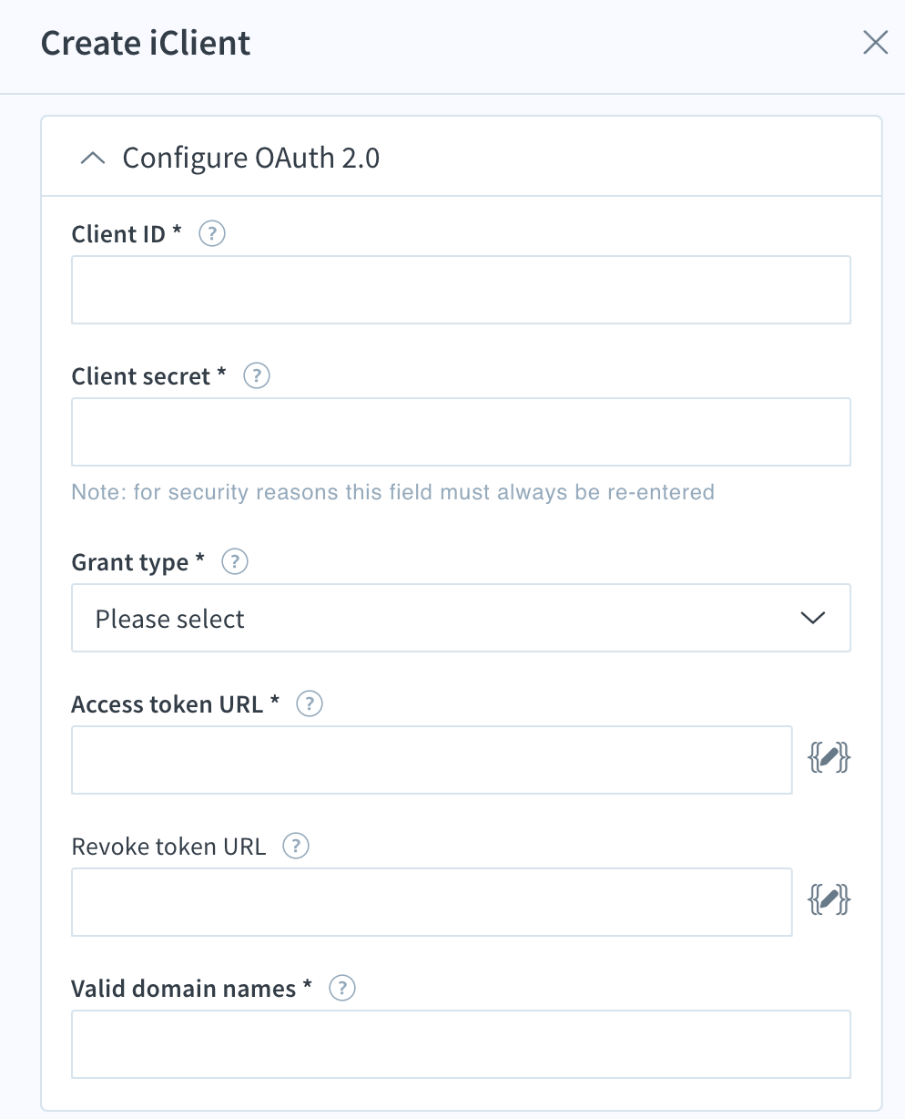

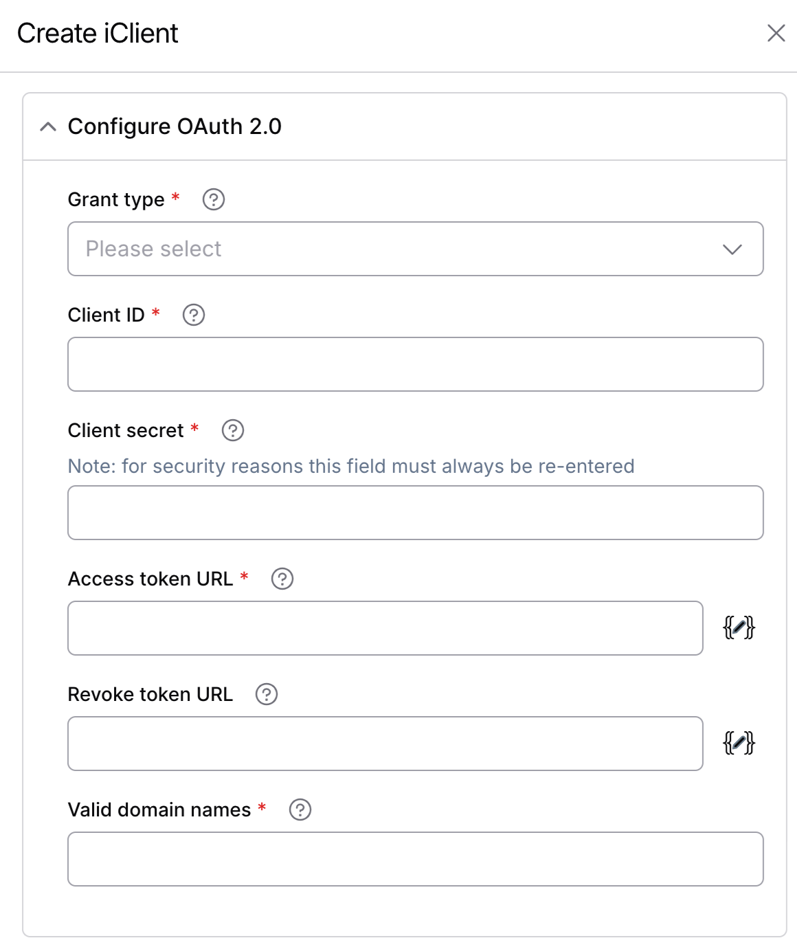

OAuth 2.0 client (required): Select the client pair that stores the client ID and client secret provided to you by your app. To add an iClient and configure your credentials, click the plus (+) button. Click the edit ( ) button to modify a selected client. Be sure to give the client a recognizable name for use in any other connections.

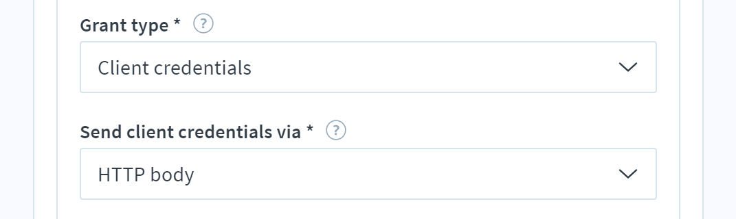

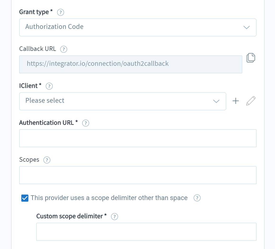

Grant type (required): You can use the Authorization code to get an access token for web and native apps after you authorize the app, or Client credentials for apps to request an access token on their own behalf.
- Authorization code – the provided code is obtained by using an authorization server as an intermediary between the client, integrator.io, and resource owner. Selecting Authorization code enables additional required and informational settings.
- Client credentials – limits the authorization scope to the protected resources under control of the client, or to protected resources previously arranged with the authorization server. Selecting Client credentials exposes one additional required setting.
Authorization URL (required): Enter the endpoint for the API provider’s authorization server where the authorization code is retrieved.
Redirect URL (not editable): Click the copy button ( ) to provide to your authorization server to exchange secure messages after authentication. You must whitelist this URL with your authorization server.
Scope (optional): List the scopes to grant access to authorization server requests. Separate multiple scopes with a space character, unless you are providing an alternative delimiter, below.
Send client credentials via (required): Select an option to send basic auth credentials in the header or client credentials in the body of the request.

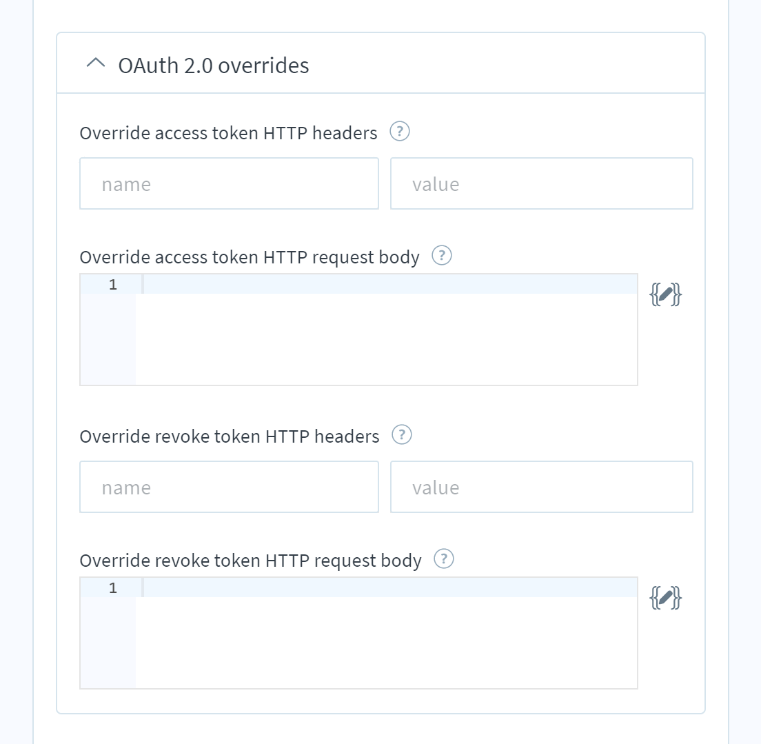

OAuth 2.0 overrides
This section is collapsed by default, since all of its settings are optional.
Override default scope delimiter (optional, enabled when Authorization code selected): If you are requesting access to more than one scope and the authorization server expects the list to be delimited by a space character, enter a custom delimiter.
Override access token HTTP headers (optional): Enter a name and a value to replace default header values with custom values. In rare cases, it may be necessary to include custom HTTP headers with your API requests. The default content-type header value is application/x-www-form-urlencoded.
Override access token HTTP request body (optional): Configure your own access token body in JSON format if it is different from the default access token body. Click the handlebars () button to open the Advanced field editor and create or edit a template.
This JSON format is finally converted to the form-urlencoded format on the wire.
- Default access token format for Send client credentials via set to body:
{ code: {{{query.code}}}, redirect_uri: {{{redirectUri}}}, client_id: {{{clientId}}}, client_secret: {{{clientSecret}}}, grant_type: "authorization_code"}
- Default access token format for Send client credentials via set to header:
{ client_id: {{{clientId}}}, client_secret: {{{clientSecret}}}, grant_type: "client_credentials" }
Override refresh token HTTP headers (optional, enabled when Authorization code selected): In some cases, it may be necessary to include custom HTTP headers with your token refresh requests. Any value from the connection can be referenced using handlebars {{{placeholders}}}, such as a complete path within a connection setting.
Override refresh token HTTP request body (optional, enabled when Authorization code selected): If the service you’re connecting to supports requests to obtain or refresh existing tokens, enter the body to use in the request token call. Click the handlebars () button to open the Advanced field editor and create or edit a template. Typically, a username/password or refresh token would be used in the request. You may use handlebars placeholders to reference any connection fields. You can store these values in the encrypted field or, if not sensitive, the unencrypted field– for example,
{{connection.http.encrypted.password}}
- Default refresh token body format:
"grant_type": "client_credentials",
"refresh_token": "{{{connection.http.auth.token.refreshToken}}}"
Override revoke token HTTP headers (optional): In rare cases, you may need to include custom HTTP headers with your API requests. The default content-type header value is application/x-www-form-urlencoded, and the authorization header value is basic. Enter a name and a value (or multiple name-value pairs) to replace default token headers with custom values.
Override revoke token HTTP request body (optional): Configure your own revoke body in JSON format if it is different from the default revoke token body. Click the handlebars () button to open the Advanced field editor and create or edit a template. You may use handlebars placeholders to reference any connection fields. This JSON format is converted to form-urlencoded format on the wire.
- Default revoke body format:
{ token: {{{connection.http.auth.token.token}}} }

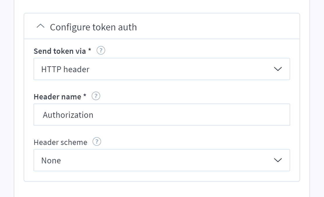

Configure token auth
This section is expanded by default, since it contains a required setting.

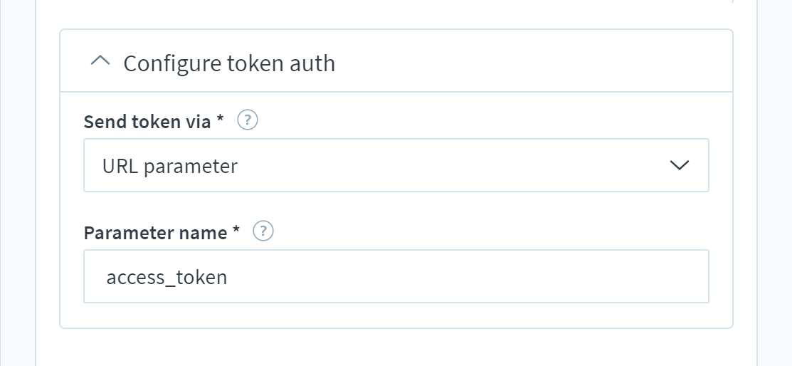

Send token via (required): Select the location where your API expects to find the authentication token:
- HTTP body – The API requires the token to be embedded in the body structure of your HTTP request. In such cases, place the token in your body template using the handlebars placeholder
{connection.http.token.token}
. - HTTP header – Allows you to specify the header name and authentication scheme to use when constructing the HTTP request.
- URL parameter – The authentication token is located in the URL. Specify the query string parameter name that holds the token value.
Header name (required, enabled when Send token via is set to HTTP header): Enter the header field name that contains the token, if the API expects a field other than Authorization.
Header scheme (optional): Select an HTTP authorization header scheme value. For example, Bearer would be the scheme value for Authorization: Bearer my_secret_api_token.
Parameter name (required, enabled when Send token via is set to URL parameter): Specify the name of the URL parameter that holds the API token value. For example, if you enter myAPITokenURLParam, then all HTTP requests will be sent in the format ?myAPITokenURLParam=<token>
