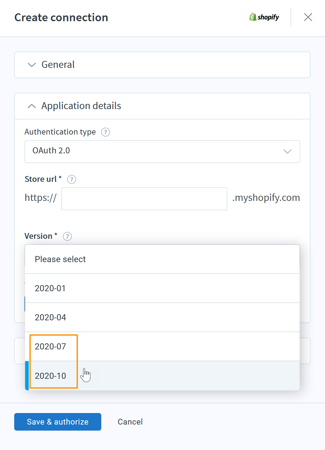

Select a valid version for a new connection
  1. Set up your Basic or OAuth 2.0 connection to Shopify as documented.
  2. For the required Version setting, select a more recent value: 2020-07 or 2020-10.

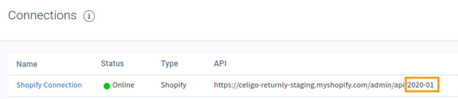

  • Go to Resources > Connections and check the API base URL of your Shopify connection. Continue for any version earlier than 2020-07:

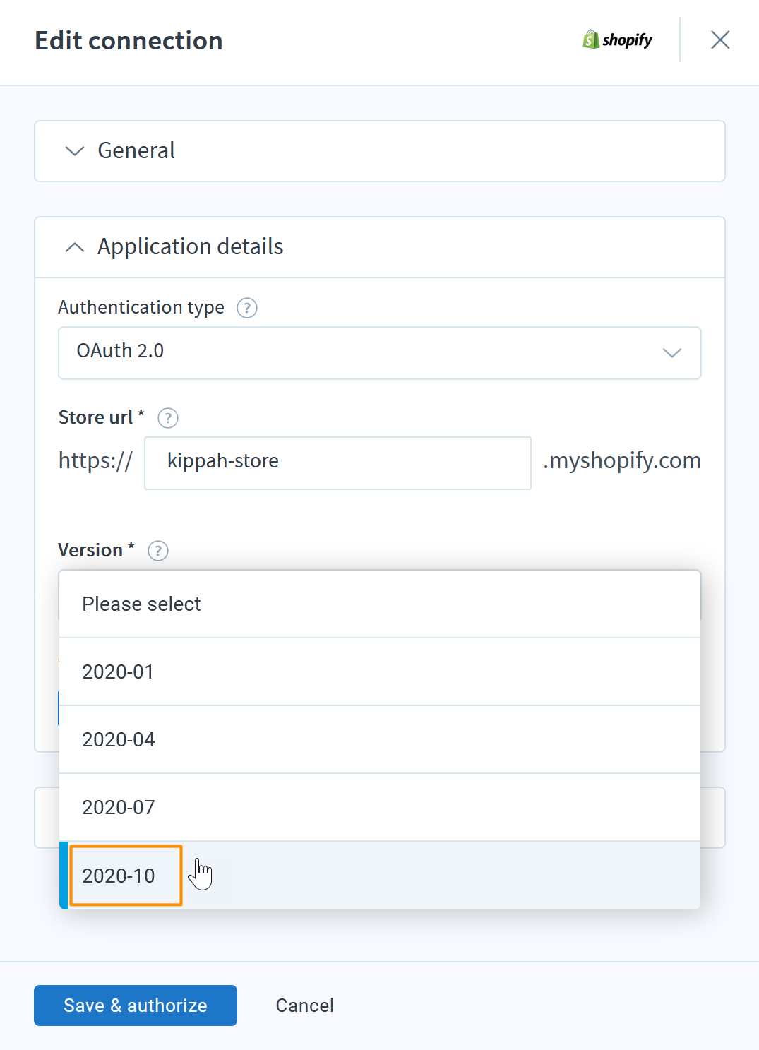

  1. Click the connection name to edit it.
  2. Select a later Version value, such as 2020-10.
  1. If you are editing the basic authentication type, you must re-enter the API key and Password whenever you update the connection.
  2. Click Save and authorize.

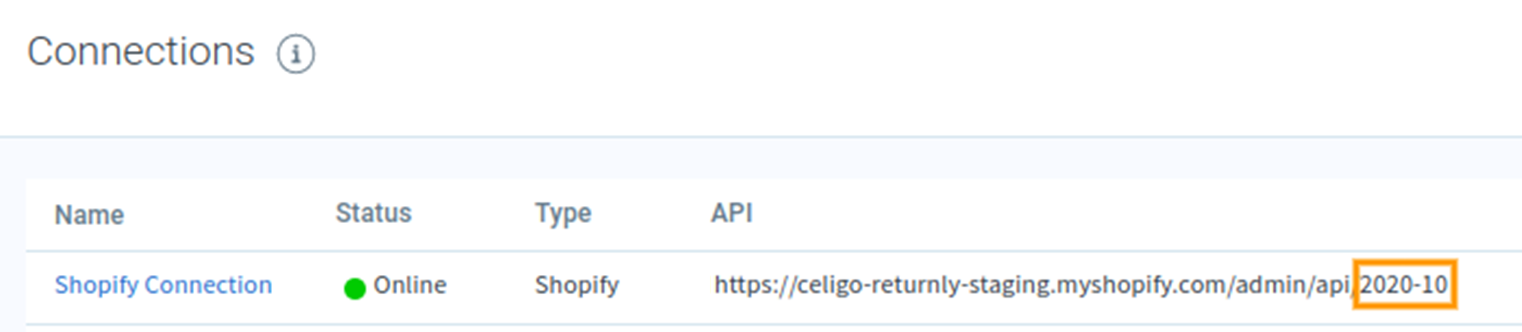

  3. Return to the Connections page to verify the new API URL:
