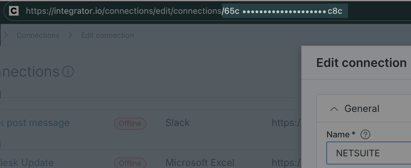

A. Configure your NetSuite connection
First, create or edit a standard NetSuite connection. Record the connection ID at the end of the URL for use below as the NetSuite connection ID.

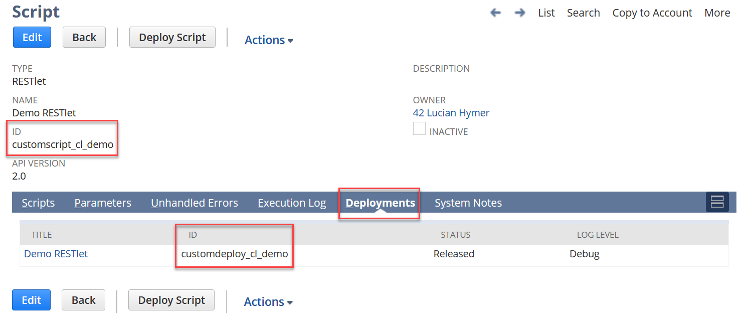

C. Retrieve RESTlet parameters
Before you can interact with the RESTlet, you must get the Script ID and Deployment ID from the NetSuite script record.

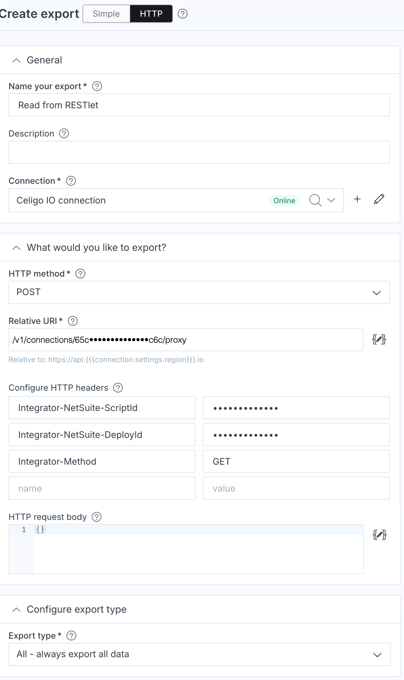

Export (read) from a RESTlet
In Flow Builder, create an export to the application integrator.io, selecting the integrator.io connection that you just created. Define the export as follows:
Name: Give the export a name.
Form view: Choose REST API.
HTTP method: Choose POST.
Headers:
name | suggested value |
Integrator-NetSuite-ScriptId | The Script ID from above |
Integrator-NetSuite-DeployId | The Deployment ID from above |
Integrator-Method | The method to use with your RESTlet call, most likely GET for an export |
Relative URI: Enter the proxy URI for your NetSuite connection, referencing your NetSuite connection ID that you copied above, in the format, /v1/connections/<id>/proxy
HTTP request body: Enter an empty JSON object, {}
Export type: Choose All.
Click Preview to see your RESTlet data.

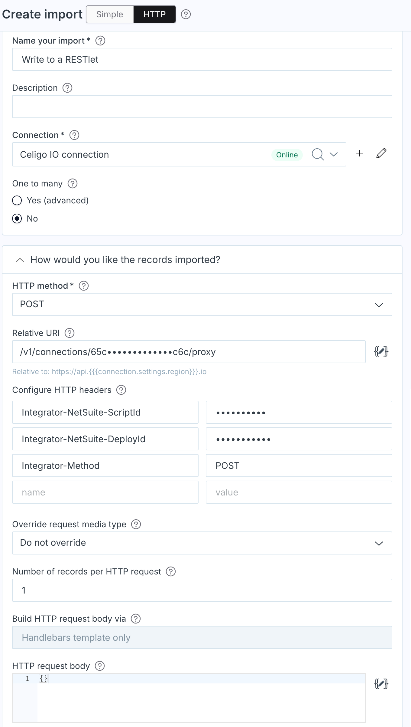

Import (write) to a RESTlet
In your flow, create an import using the integrator.io application and the connection to it that you built earlier. Define the import as follows:
Name: Give the import a name.
HTTP Method: Choose POST.
Headers:
Integrator-Method | The method to use with your RESTlet call, most likely POST for an import |
Now, within this import the integrator.io connection functions like any other REST connection. You can specify a request body in the HTTP request body setting, or you can use regular field mapping. If you go with the latter, you can provide a sample request under Do you have a sample destination record? in the import settings to make mapping easier.
