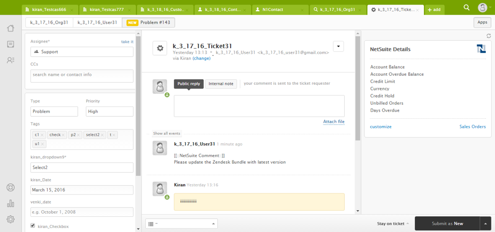

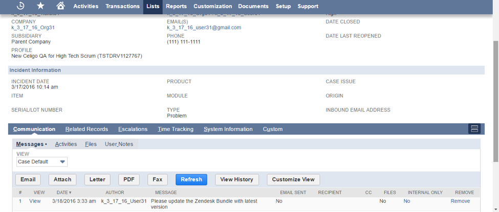

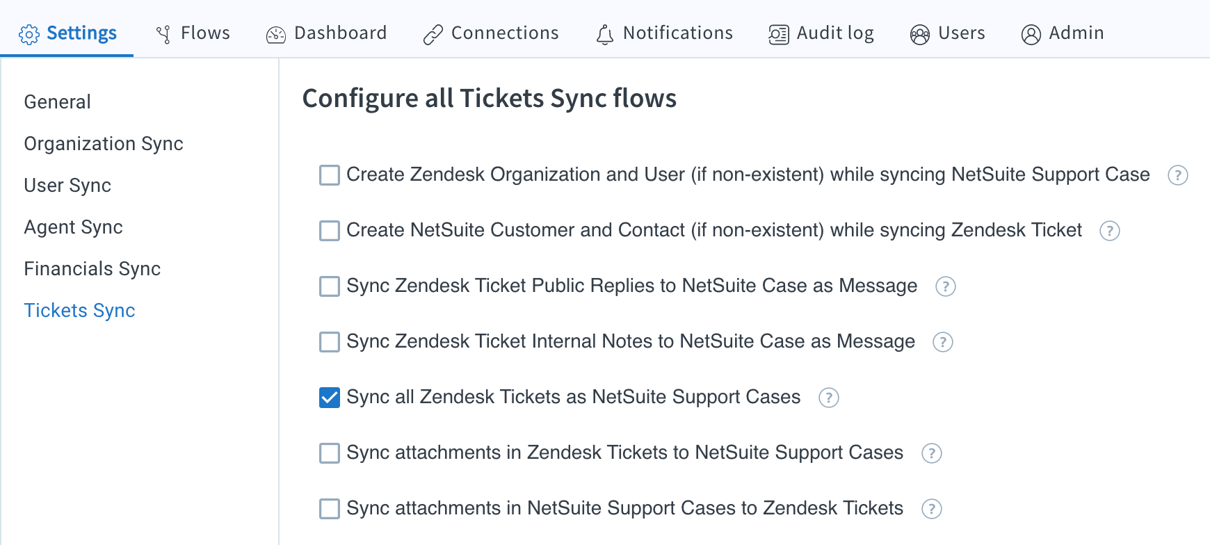

Screens showing data flow from NetSuite to Zendesk
Message in NetSuite:
integrator.io Ticket Sync settings.
Run the flow.
Picture3.png Comment in Zendesk
